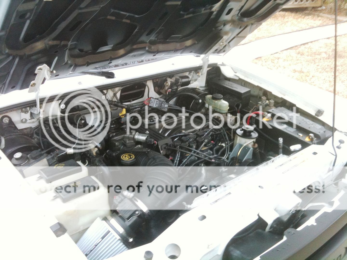

I just recently finished a swap into this truck, and I'm getting a CEL code:
P1309: Misfire Detection Monitor not enabled
Everything seems to be kosher. No drive-ability issues, all appears to be operating normally. I had a few issues with the throttle, idle rolling up and down and after a blip to the throttle in park, poor initial throttle response but I think I've fixed all this today. That's when it threw this code. I can clear it out, but after some spirited driving it comes back.
About 250 miles since rebuild and install. I installed a new cam position sensor and ECT on day one. Other than that it's all the factory harness connections.
Ay help is appreciated!
