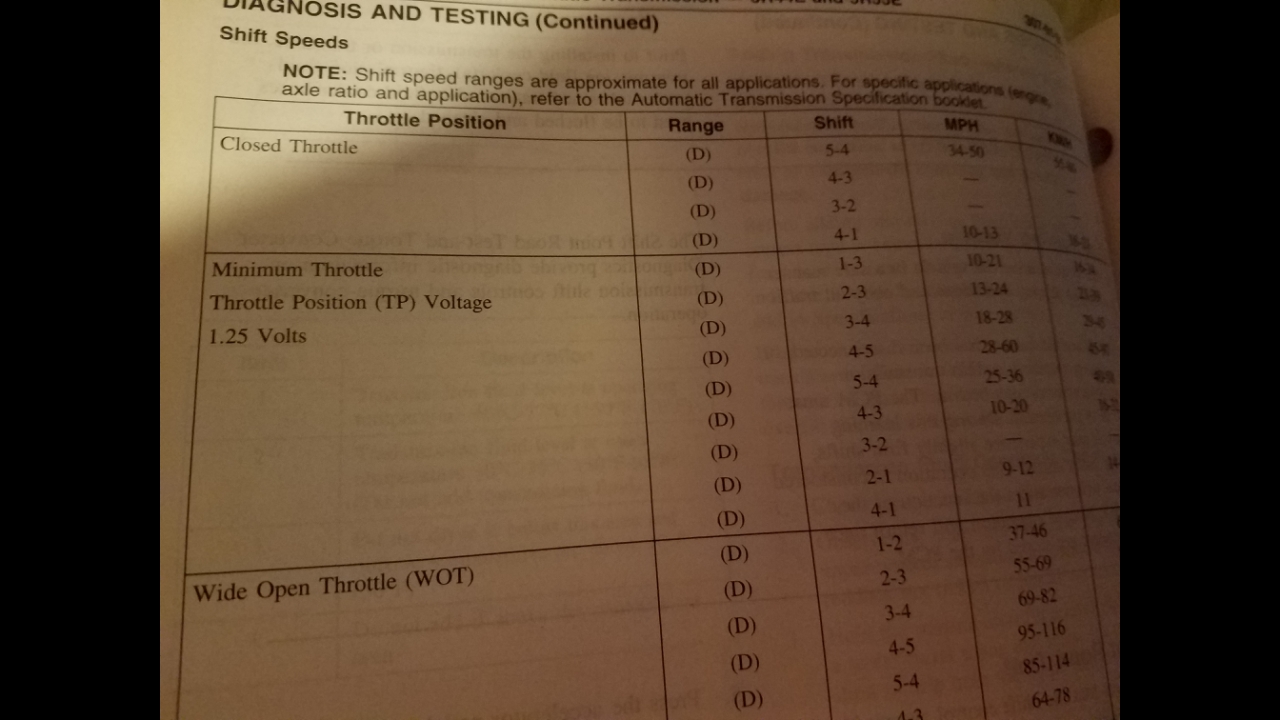

Oddly enough I finally got my factory service manuals which describe the shift patterns. Apparently 2nd gear simply isn't used 99% of the time. The first to third shift i was notcing on my scanner is completely normal as it will only command 2nd during wide open throttle or random downshift/upshift situations. Pretty interesting. So if you have a 4r55e and not a 5r55e you aren't missing anything!
It also specifically lists p0750 as an "electrical fault only", its interesting how a obd2 code definitions can vary depending on the specific vehicles parameters for the code. Anyway there are 10 pages on test procedures which state the range sensor must be tested and within spec before proceeding lol. Never would have guessed a glorified neutral safety switch could throw solenoid codes.... of course the testing procedures that follow cannot be done by mortal beings since they are written for ford techs with ford diagnostic gear that can physically command the solenoids on/off. I know of no scanner less than 2 grand that can do that. My humble 300 dollar scanner can read the solenoid PIDs but has no access to control them.
Still the service manuals have proven well worth the 150 bucks I spent on them. They make chilton/haynes manuals look like dr. Suess books.
