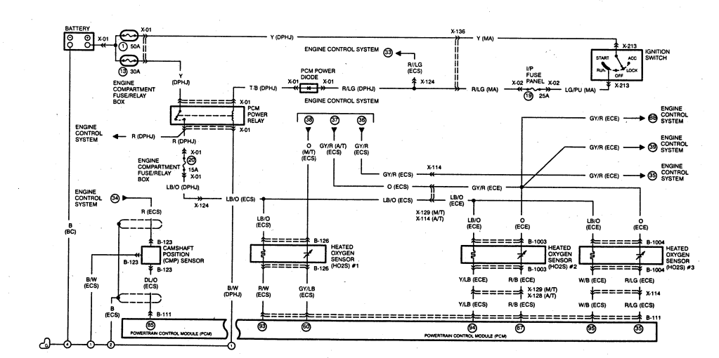

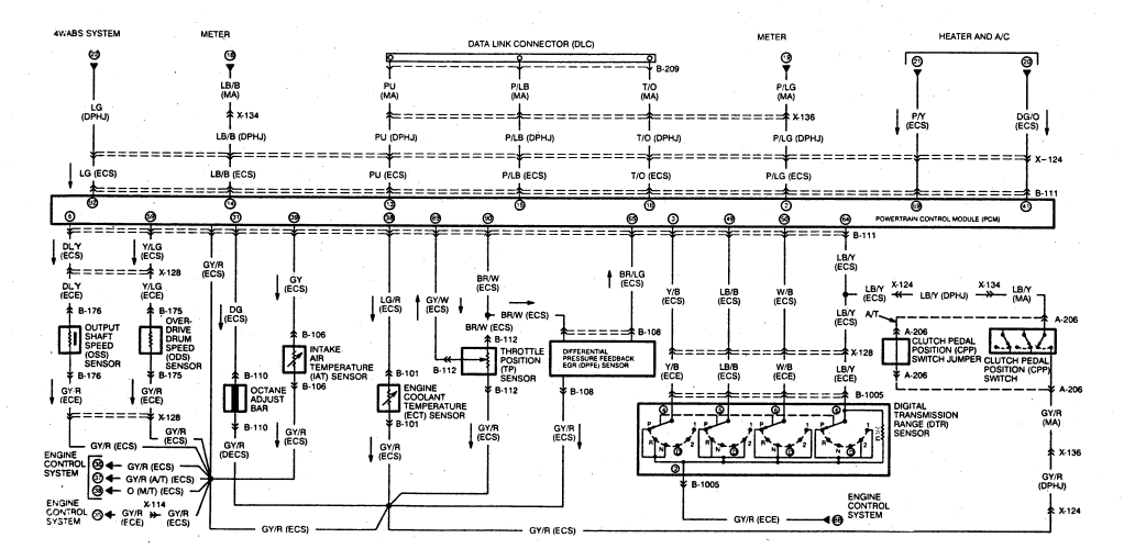

did you hook up your 2 new wires backwards?

Im almost certain I did not. I will verify it though.
According to your diagrams the other grey/red wire in the main trans connector would be the temp sensor. Certainly crossing that up shouldnt cause the other codes that appeared after I made these wires. Im done with it for tonight.. if you come up with any other ideas please let me know. Gonna start with a fresh slate in the morning. Its been 102 degrees today and a heat warning and I think my brain is boiled ;)
So does anyone have a diagram of the main connector at the transmission that shows which wire is which?
