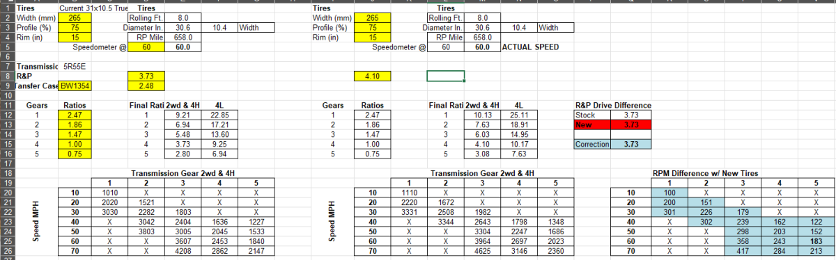

This chart shows a truck with a 265/75r15 tire and the difference of engine RPM using 3.73 vs 4.10 gearing with the 5R55E transmission. At 60mph in 5th gear, using 3.73, the engine spins at 1840 RPM. With 4.10 gearing, its at 2023 RPM....a 183 RPM difference. Although the engine RPM is higher with the 4.10, it also is working with less resistance so it move the truck easier than if it had the 3.73.

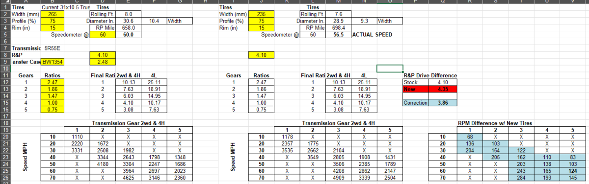

Below, the chart uses the same 4.10 gearing for both tires but the tires area 265/75r15 and 235/75r15. With the larger tires, the engine spins at a lower RPM than with the smaller 235 tires.
