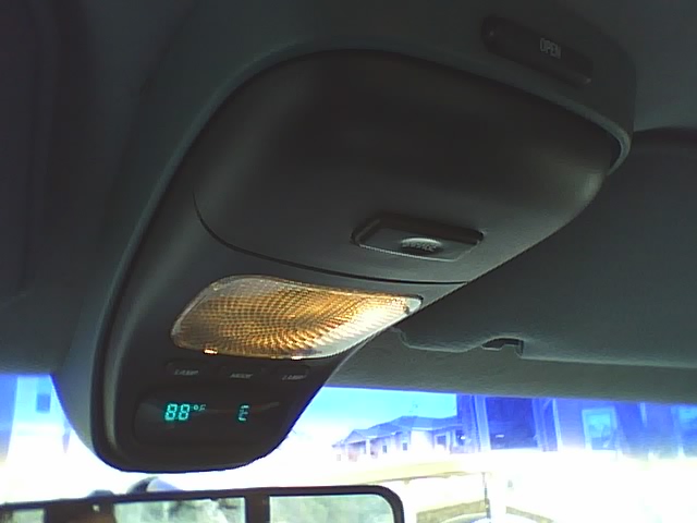

OK so here is what I found out today:
1. Exlpoders with a factory sun roof have a larger console so the window motor will fit under it.
2. Exlpoders with a factory sun roof don't have a place for a garage door opener.
3. Exlpoders with a factory sun roof do not use a seperate bracket mount the console. It is screwed and clipped directly to the roof supports.
4. All Exploder consoles use the same maplight and digital read out.
5. There is a lense that clips in the console that makes the read out green or blue, I beleive they can be swapped.
6. I got a Gray console from an Exploder with no sunroof.
7. It fits perfect in my truck, and I wont have to paint it.:yahoo:
8. I didnt use the bracket. I just cut holes for the clips and then screwed the back directly to the roof support.
I guess I can take my fiberglass stuff back:thefinger:

The one I ended up using is like the one I started with (only gray instead of tan). The reason it didn't fit in the first set of pics was because I was trying to use the bracket from the Exploder. When I tried it with out the bracket it worked out great.
I got the idea to try it with out the bracket when I saw that the Exploders with a sunroof didnt use one.
And just to clear it all up the console on the left it from an Exploder with a sunroof, the one on the right is from an Exploder that did NOT have a sunroof.
I never used the larger console on the left for anything except to show the diffence in size.
WOW, this got confusing I hope I cleared it all up now. (or made it worse.lol.)

I used the bracket in mine (as you can see by the pics). I would think it'd be harder to mount without a bracket due to the angle of the screws that would go into the sheet metal, but whatever floats your boat. If you're unsure, I'd do some test fits with the headliner off and see what works better. I spent a good 4 hours doing the physical installation of taking off the headliner, seeing what made it fit best, etc.
I never had to take my headliner down. It only took about 5 minutes to mount it after I found out I could do it with out the bracket.

locovaca, I was able to just tuck them up along the front edge. I just pulled down on the liner a little and pushed them back behind the bump. I did have to take the piller plastic off.
oldjohnny, The truck I put the console in is an XLT, but I have a parts truck that is an XL. It turns out they both have the same headliner anyway.
