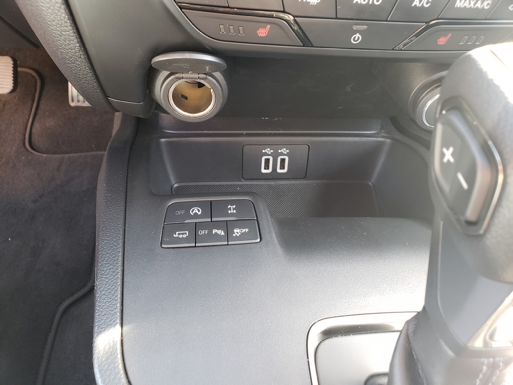

Switches are at the front of the center console.

So, just looking at the switch array... There isn't just an ON/OFF switch but rather mode switches. I'll bet each mode has its own algorithm(s) to determine when it engages and when it disengages. While I'm sure there is a MPH threshold that overrides this system... 5 MPH seems low and 25 MPH seems more realistic. I still think that once this system is locked and under power/load it won't unlock until a software algorithm says it's safe to do so. Anything less seems detrimental to the locker/differential to me.
Without a pile of technical/software specifications in front of me that's all I got... and it is all a guess.
I do think that 90% of the buyers could benefit from this system... there is the 10% that might be better off looking to the aftermarket for an option that will better meet their needs.
Only one of those switches is for the locker. The rest are tow /haul mode, traction control, disable auto stop /start, and (I think) fog lights.
