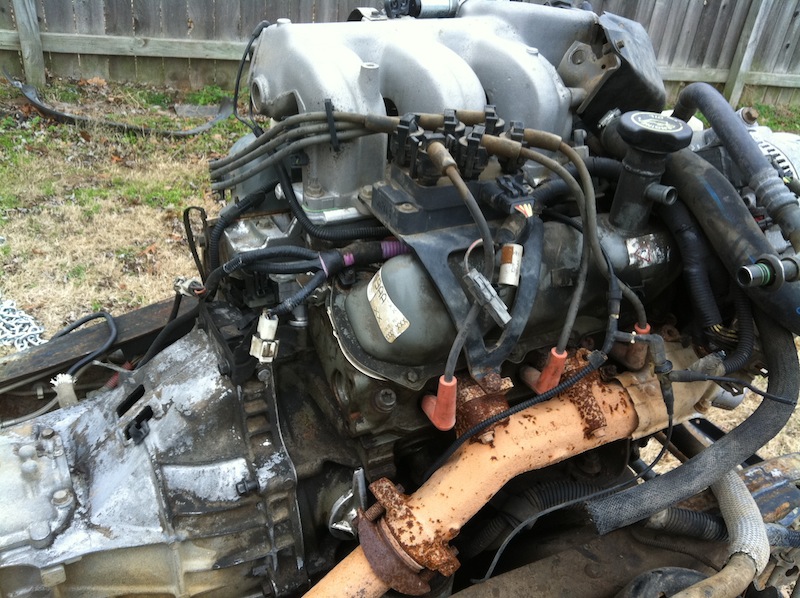

Problem solved:
Picked up a 92 Explorer rolling chassis - 4.0, 5 speed, e-Transfer, 8.8 with complete under hood wiring harness and computer, and exhaust for $375.
This way I ended up with a 4.0 and tranny for the price of most 4.0 engine only options I've seen as well as a D35 to replace the D28 and an 8.8 option if I want later. The seller had even gone to the trouble to find a complete 92 under hood harness, hosing and computer for it before selling the B2 he was going to put it in. Seller is a very good helpful guy as well!
Will be pulling the 4.0 down slightly to check condition but was supposed to be around 150K in good shape. Will be installing a new high volume oil pump, rear seal if needed, water pump, etc and detailing over the winter for a swap next spring.
Open to any other suggestions for checking the 4.0 out and/or should do items before it goes in.
I'm happy - :icon_cheers:
Sorry Turbo Fans - I need to find something to put another 2.3T in now.... ;-)
-Stephen
