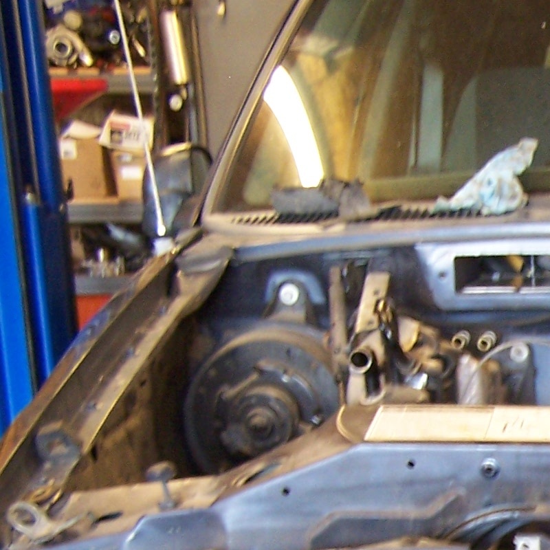

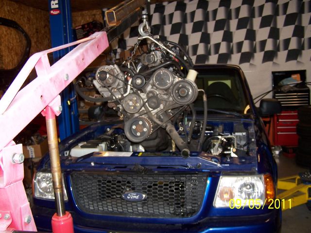

well actually in the edge.thanks to all the Ranger Station ppl here. with out the guilds and support im sure that i would not be able to do this. thanks again!
  • On the EDGE!!!
having difficulties with posting pic.s sorry

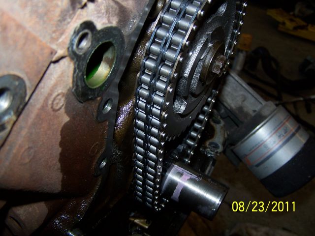

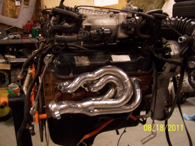

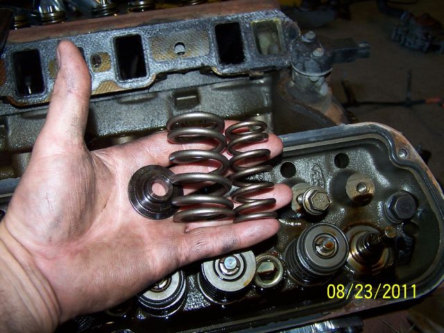

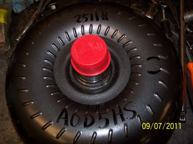

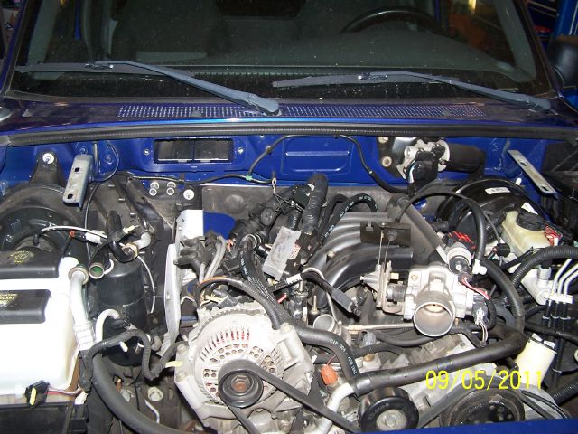

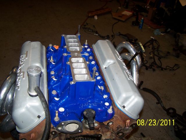

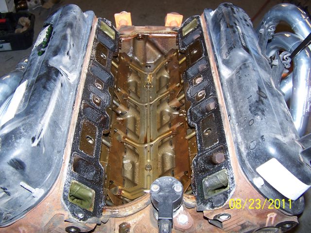

more pics to come its a 2003 edge conversion. 5.0 from a 2000 explorer. the ranger started out as a 2wd 3.0 manual model. and three weeks later is now a 5.0 v8 with the auto transmission, transfer case front diff. and rear diff. so the ranger is now a full time four wheel drive with monster torque headers,new cam shaft and edelbrock intake manifold. much more to be listed. ill post every thing that i did, but it will take a little while to get all of that. thank again stay posted for more..

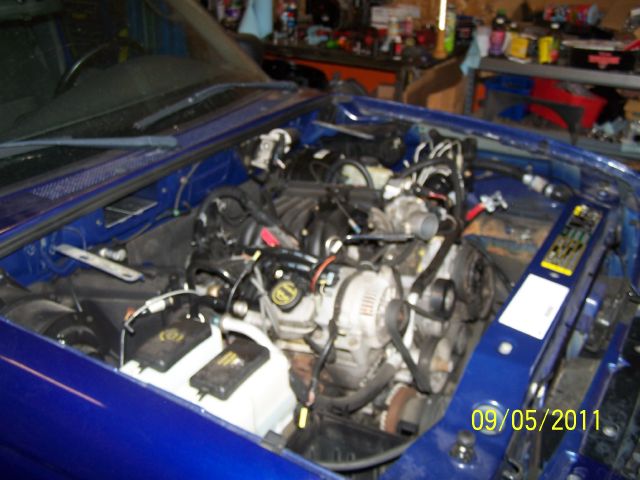

i have some more pics coming later...

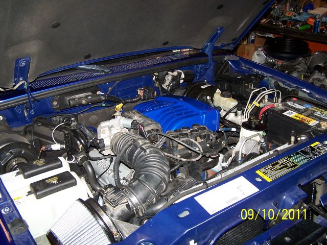

so far so good.

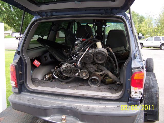

the truck runs great! suspension issues though but working those out i hope. i found a good place for the 3.0 that came out. i put in the rear of the explorer. now the explorer looks great!
