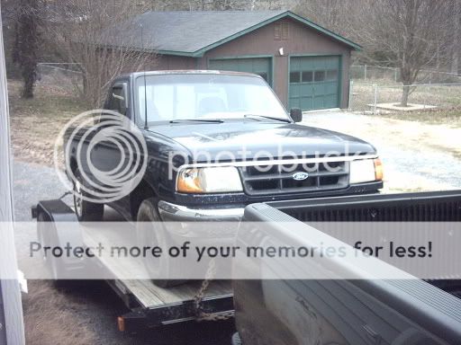

My Son's 93 bone stock when he bought it:
With 88 Bronco II 7.5 L/S:

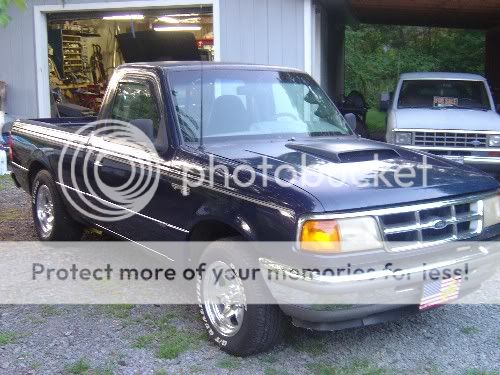

This is my 94 with 8.8 out of 98 Explorer (same sized tires on rear as Son's)
thats pretty much what I was looking for. though you mention its a bronco 2 axle?? didnt that require welding spring perches etc??

NO, a Bronco II is a direct swap into a Ranger, it's just narrower, and the 93 pictured has a flip-kit under it, as Bronco II's mount the same as a Ranger, springs over axle..............my 94 with Explorer 8.8 is direct mounted springs below axle to give me 4" of drop.
