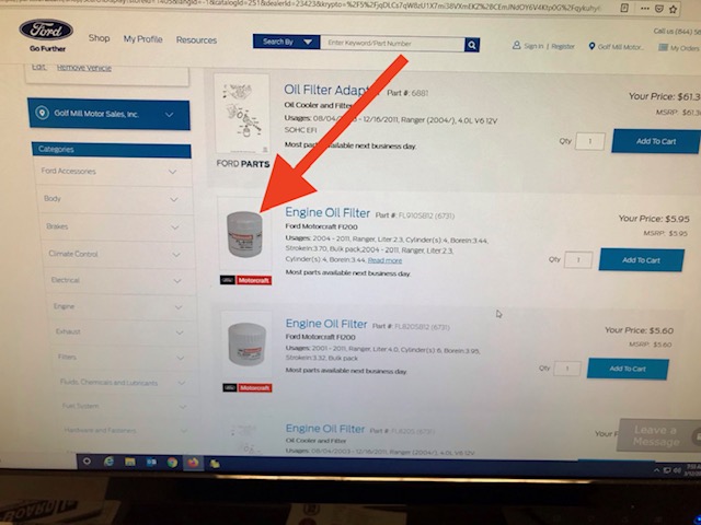

I looked it up on Fordparts.com, it calls for the 910S, but Motorcraft calls for the 400S. Physically the o-ring and thread look to be the same, but I can't confirm that they are interchangeable.

I just use what the parts catalog calls for... FL910S.
No real reason for me to deviate. When another filter number supersedes that part number... in a Ford parts catalog... I will use it.

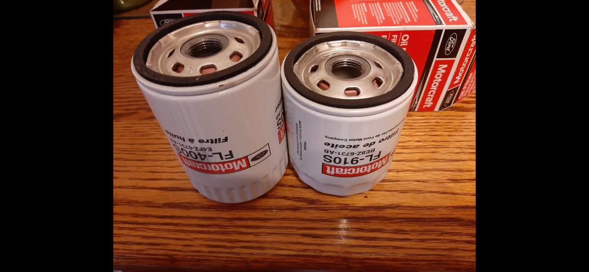

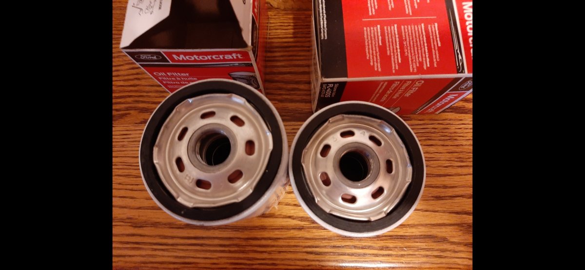

In case anyone was curious... here's the two side by side.
oil filter FL910S/FL400S
