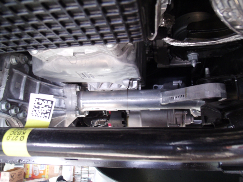

i did not think that pulling a tire off would be required for an oil change though. compared to the edge it isnt any harder....you cant even see anything after crawling under the 150's...covers everywhere. and plastic engine oil pans can eat a dik....

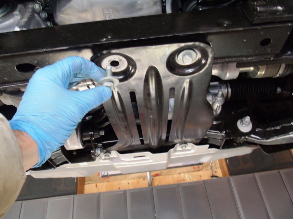

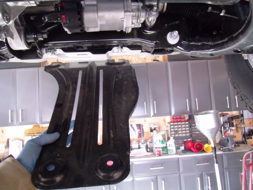

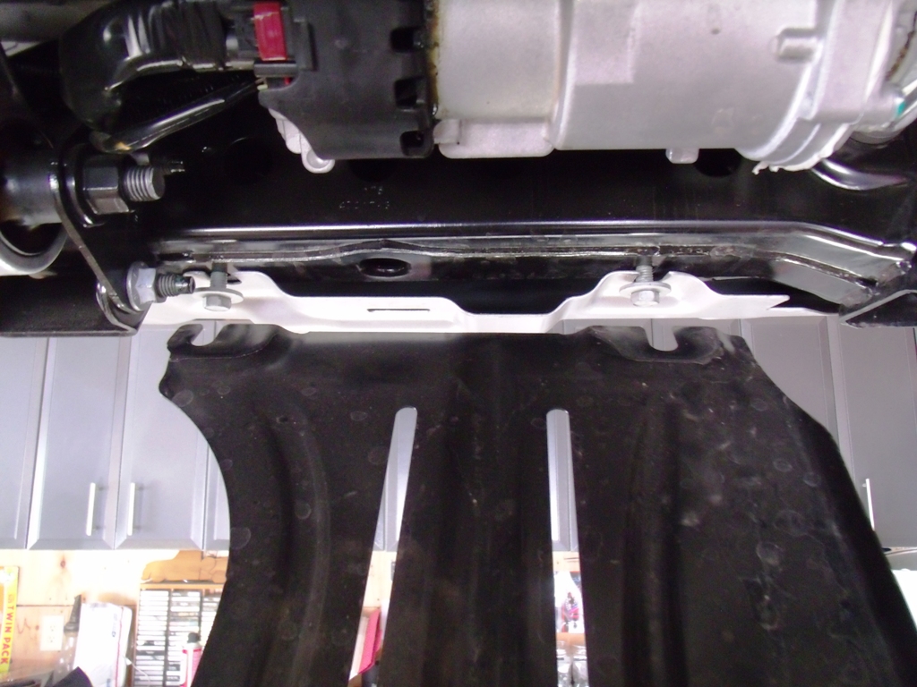

The skid plate needs to be removed. It has (4) bolts holding it on. Only the rear (2) bolts need to be removed. The front (2) bolts only need to be loosened since the front holes on the skid plate are slotted.

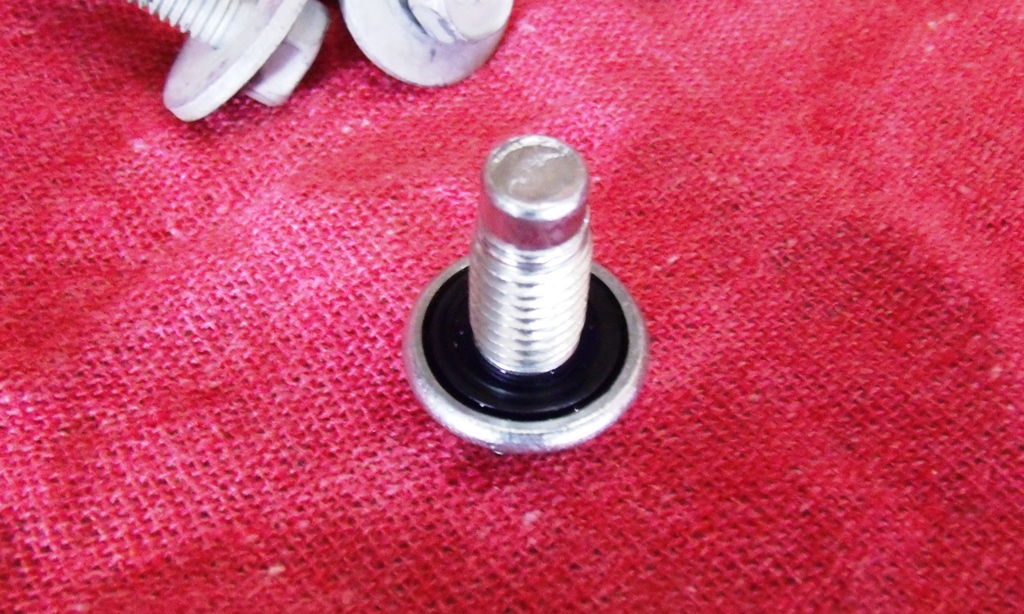

The skid plate bolts and the oil drain plug are all removed with a 15mm socket. And the oil drain plug has a built in elastomeric gasket. Well done Ford.

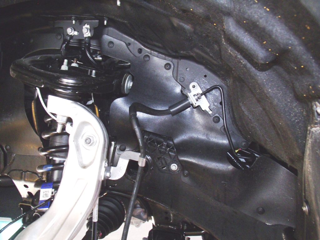

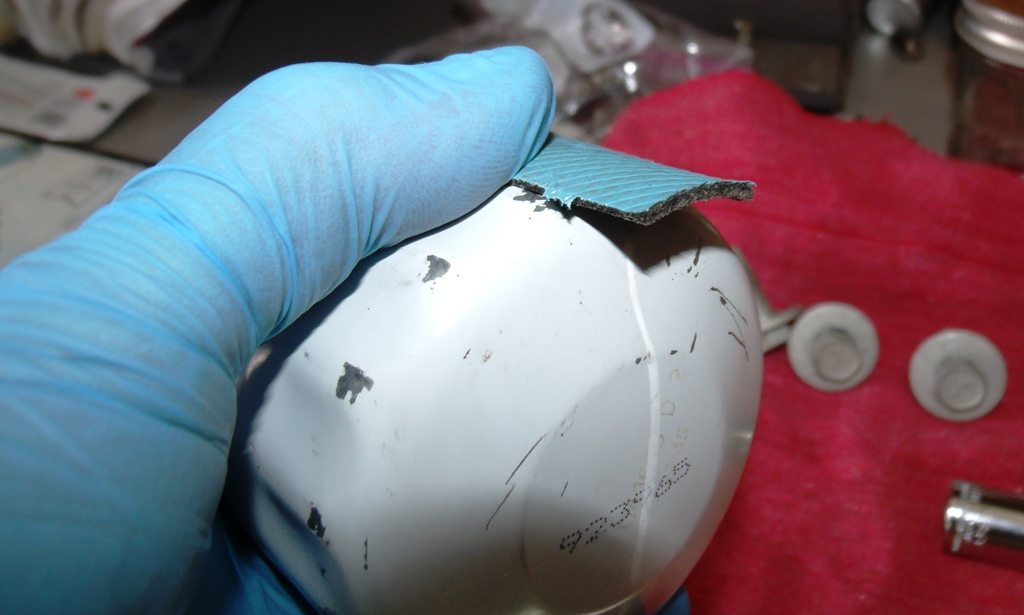

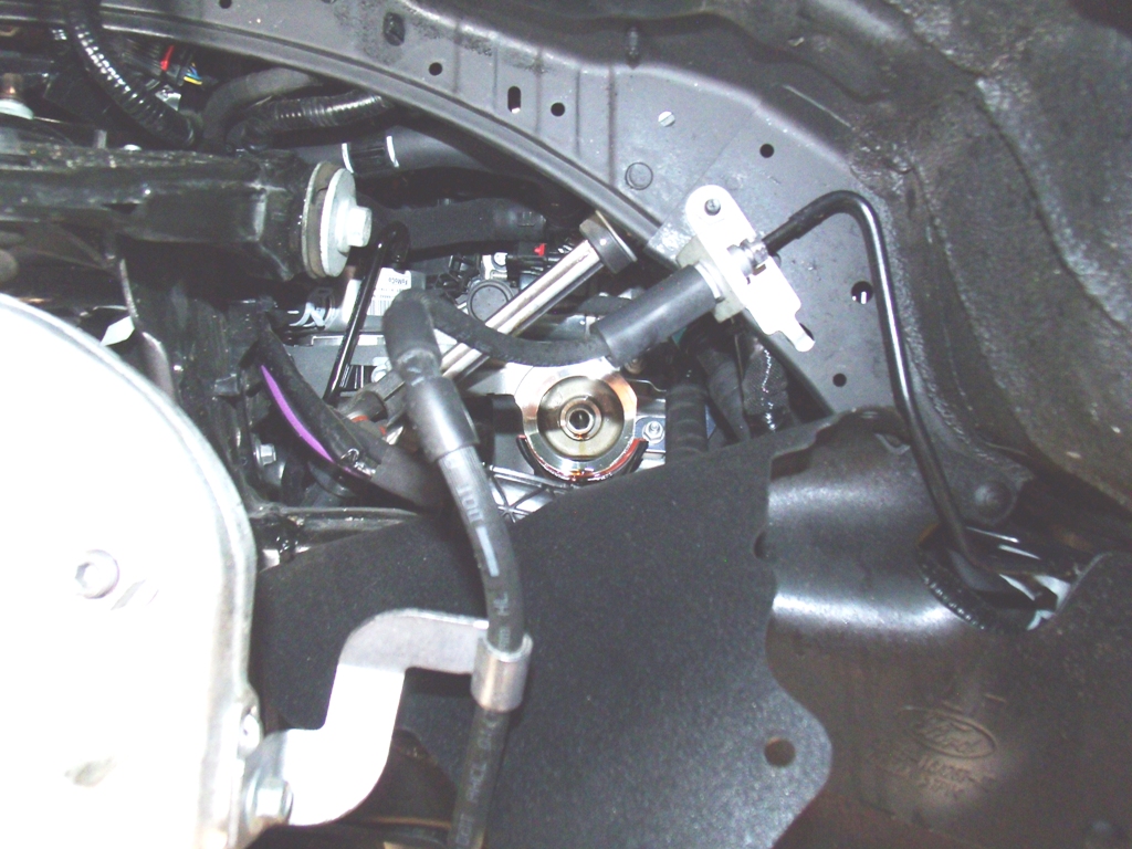

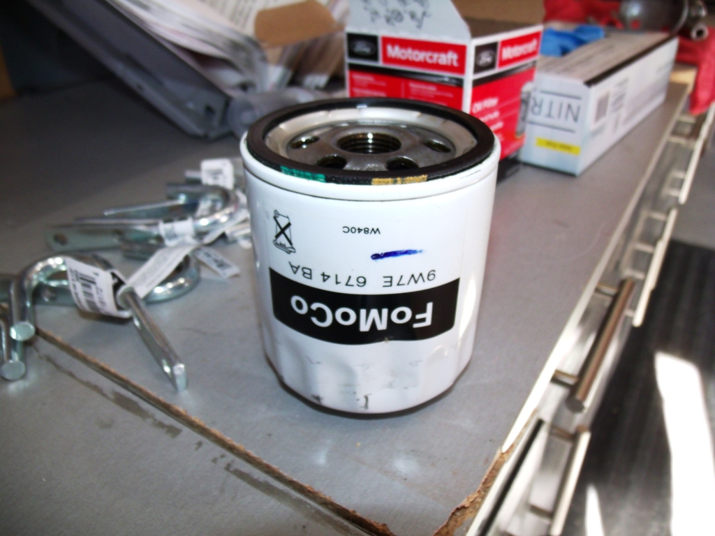

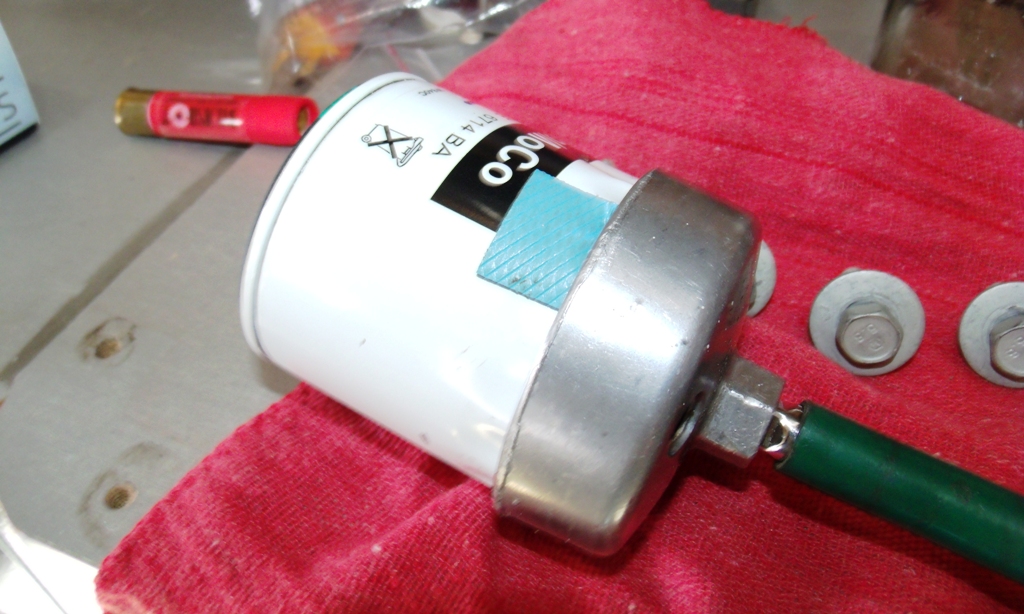

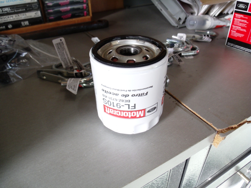

I removed the front drivers side tire... since I was rotating the tires anyway. The filter that came from the factory was different than the FL-910S Motorcraft filter. My filter wrench just spun on the factory filter.... shit! My filter wrench fits nice and snug on the FL-910S?
_________________________________________________________________________________
I tried some different wrenches I had, those didn't work. ended up wedging a small piece of rubber friction tape. between the wrench and the factory filter. That worked. Pictures are after removal, just to show what I'm talking about. The trough Ford supplied to capture and re-rout the oil that runs out of the filter worked great. Well done Ford.

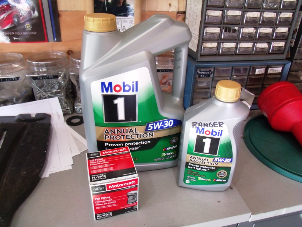

I then installed the new FL-910S Motorcraft filter, easy peasy.

The cover in the wheel well needs to be removed down past the brake line to allow cleaning out the oil filter trough. I shot some brake cleaner in the trough and then wiped it out with a paper towel.
Buttoned everything back up and then used 6 quarts of Mobil 1 5W-30 Annual Protection.
The manual says "6.2 Quarts" But if you put in 6 quarts the level on the dipstick is right in the middle.

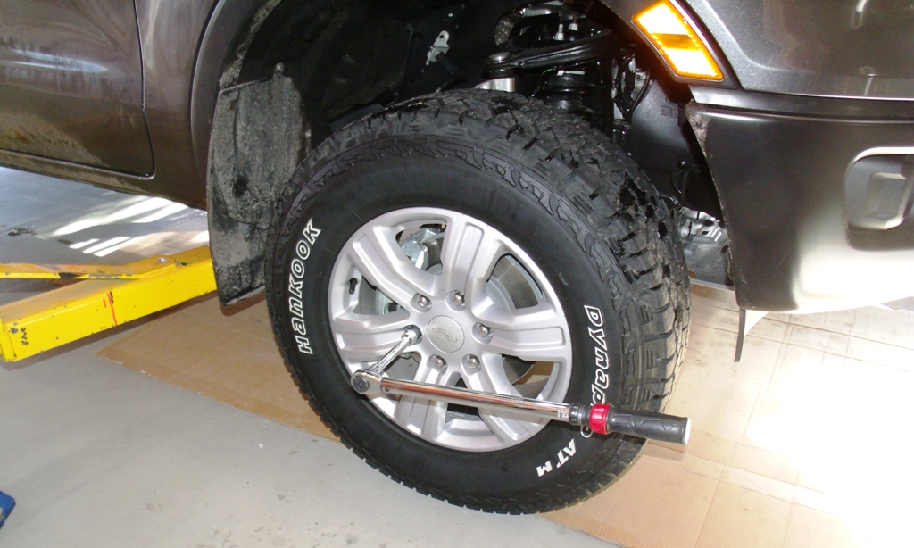

Rotated the tires, torqued the lug nuts to 100 ft-lbs.. and we're good for another 4,000 miles.
I would have figured they would have went with a larger filter. The 910 is pretty tiny. :dunno:
Another reason I don't believe in extended oil change intervals. What good is oil that last 10,000+ when you have such a tiny little filter that will be worn out before the oil anyway.
The FL-910S is specified by Ford for the Ranger. Some folks use the larger FL-400S thinking bigger is better.
I'm told the 910 has a higher internal relief valve pressure setting, which, I am told, is better so the filter doesn’t bypass as much oil as the 400.
I found that the old fashioned steel band type filter wrench works well but mine has a handle that can be swiveled for clearance issues. Thanks for the pictures to help those who haven't done it yet.
