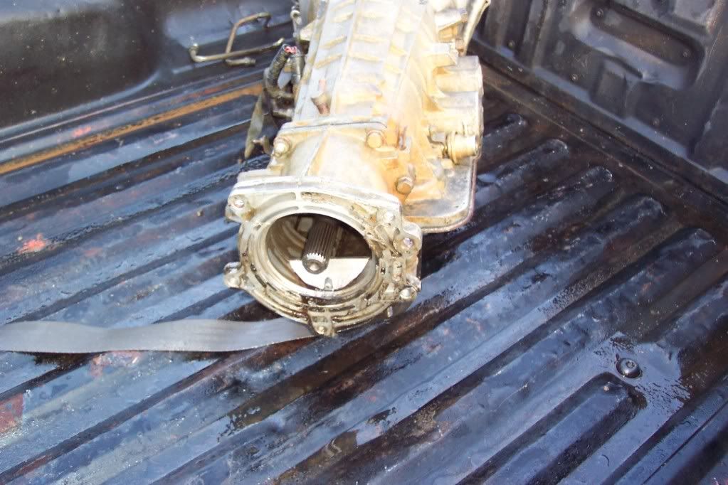

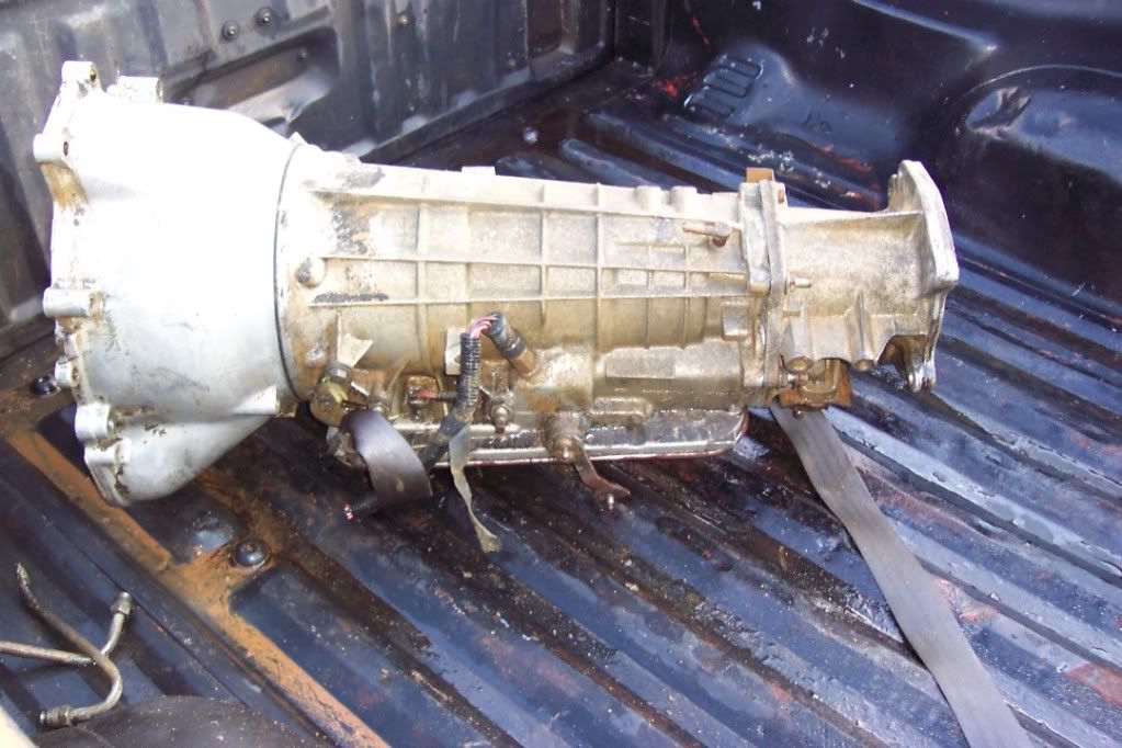

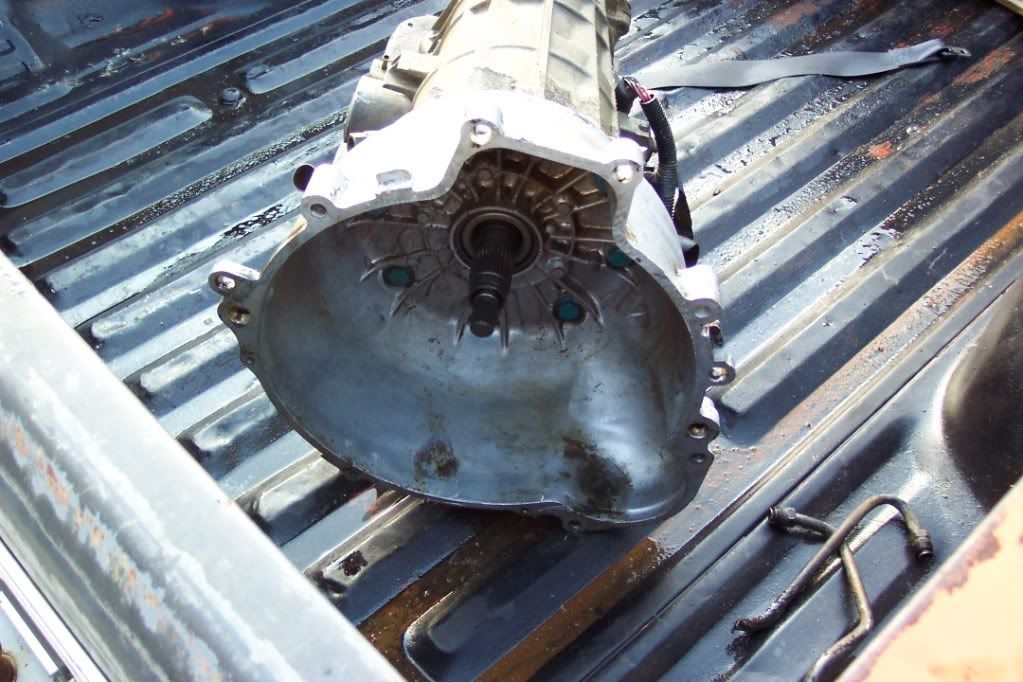

Here is pictures of the one I bought to replace mine, of course I'm going to try and get that TC of that stuck motor some how, if any one has any suggestions on how to do it, and remember this is in the truck still, with the heads off, and water had stood on the piston tops, I guess I could take my BAH with me and see if I can knock them loose.:icon_rofl:
If I can't get the TC of the stuck motor then this will be a donor for the front pump, IlovemybroncoII said that they buggered up the front pump installing the tranny.
