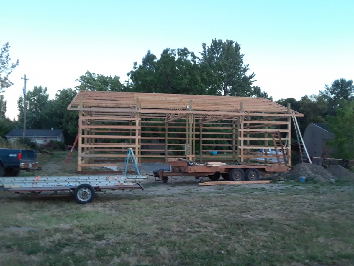

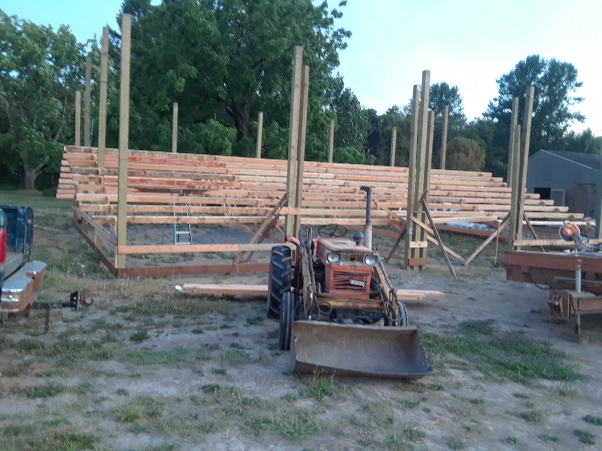

For those following, here's the progress so far... last sunday there were no trusses in the structure until evening and even then only 6 were upright with I think 5 perlins, I worked my butt off in the evenings all week and got all the perlins cut (they were all like 3/4" too long), the first picture is where I got to Friday night. The second picture is about an hour ago... most of the work was done yesterday when I had a bunch of people over, first step was to nail down all the perlins then get the truss jacks in place and lift the roof. Those truss jacks were slick, simple yet elegent and a whole lot less sketchy than building the roof in the air... Had some of my friends stick around long enough to get the trim boards in place which was a lot easier than doing it myself...

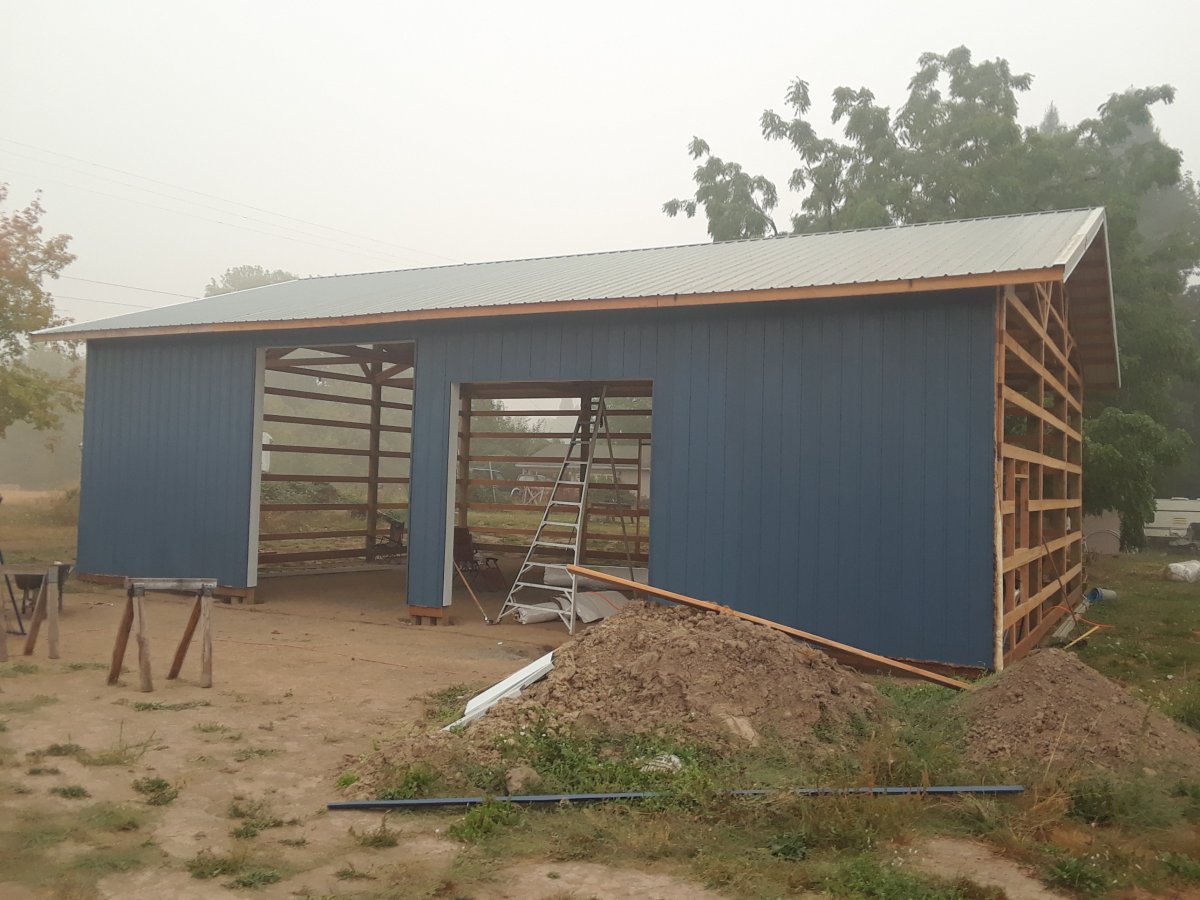

And here's where I got to this weekend, I got one more panel (4 pieces of tin) in on the easy wall since I had just a little daylight left but not enough to start an end wall... I still need to install the fascia trim but that can happen any time... Not all of the background hazyness is smoke, it was foggy all day, the air smelled much better today than yesterday but I still wore a respirator all weekend for good measure... Working by myself makes the tin a long process, especially learning as I go.
