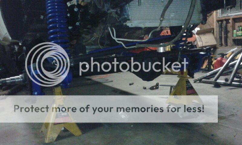

alright guys here you go. got the steering done and im pickin up my brake lines tomorrow. i should be able to drive it this weekend.
got my steering box mounted

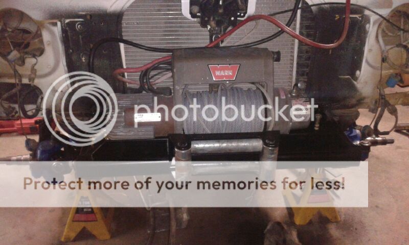

and got the winch mounted up
