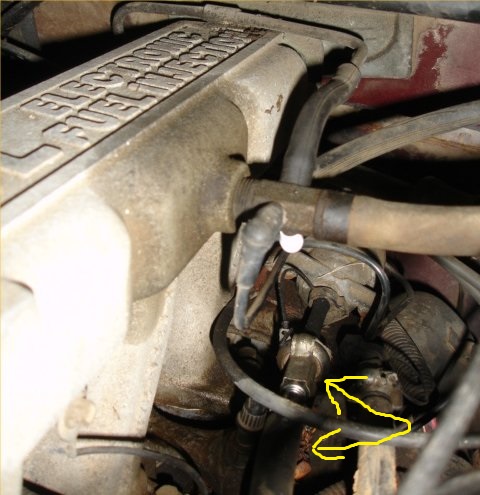

no spark possibly??
i dont know how to get the plastic lined rubber hose that runs into the actual regulator off. How would i check for spark?
That looks like a fuel line not a vacuum line
You should see 2 fuel lines coming up from drivers side frame rail
One goes to the Fuel Rail, thats the IN from fuel pump
The other goes to the FPR, thats the Return line that sends unneeded fuel back to gas tank, smaller vacuum hose is on the FPR and just pulls off no clamps or holders.

The other line has a clamp on it as well just like the fuel line in the picture but idk how to get it off. it might take me a little bit to get someone to help me check, but ill let you know in a couple hours what happens.
