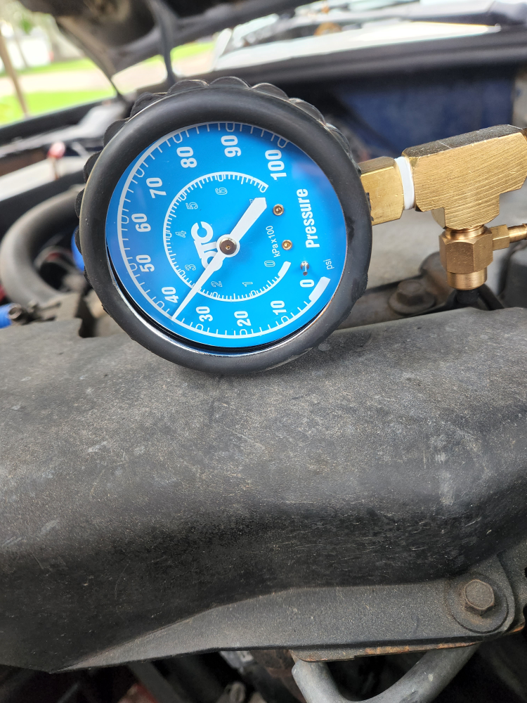

It's north of 40 psi with no vacuum. If your gauge is accurate... lower pressure = leaner mixture. O2 sensor can compensate mixture to a point... but would likely set a code in extremes.
I noticed the tachometer started blipping erratically which is why I replaced the TFI module (had one laying around because I now know how flippant they are). I do sometimesnotice the amp gauge either low or high. It might be an electrical short. I was thinking of driving on the highway with the fuel pressure gauge on a longer hose so I could put it into the cab. Otherwise, I'm stumped.

! I appreciate you. Tomorrow I will go back out and redo the vacuum test. My pressure definitelyis a bit off. Wondering if something else is causing it to dip further when I'm on the highway. Will do the checks and report back. Thanks!
Thanks for your time Uncle Gump. I appreciate you. Tomorrow I will go back out and redo the vacuum test. My pressure definitely is a bit off. Wondering if something else is causing it to dip further when I'm on the highway. Will do the checks and report back. Thanks!
