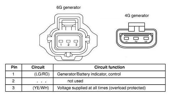

Yea I verified power coming in on the #3 pin. So the alternator is being told to send out power. The battery is at 12.5 and the alternator output just reads the same while running. So it's doing nothing and there's no other conclusion than a bad alternator. Advance must be wrong. Right?

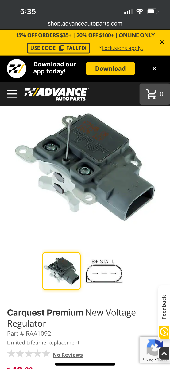

Try replacing the regulator.

The idea of replacing the regulator sounds right to me. If it is bad, power going in but not coming back out seems to point to the regulator.

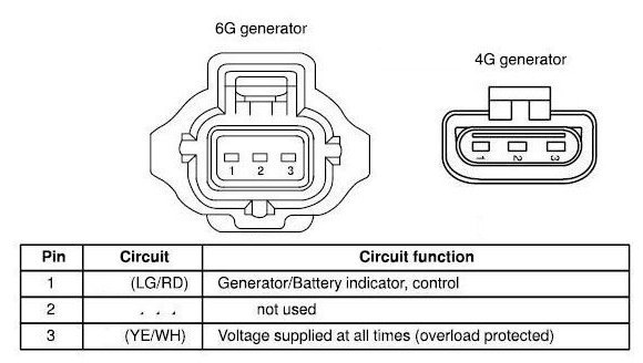

Is the regulator internal to the alternator? Got a new alternator and same thing is happening. Nothing out. Is the 12v on pin 3 pulsed or just continuous 12V? It doesn't matter what's happening with pin 1, right? I have the 6G alternator.

OK, further research on pin 1:
"Power from the ignition switch passes through the battery warning light and then to the alternator exciter circuit."
My fuse 14 supplies that and it's good. So what does that signal look like, probably some fancy signal that comes from a computer and I cant test it without a diagnostic computer. Can't I just hotwire the dam thing?
Like lil blue said, it really is that simple. 12volts from ignition switch through warning light to alternator.
I just sent power through my test light to pin 1 to simulate the ignition/idiot light circuit. Cranked it and the test light stayed on, just like the dash light. Then I took the light out of the circuit. 12V straight to pin 1. Alternator immediately started putting out power. WTH? You guys say it needs 12v on pin 1 and it was reading 12 the whole time. That's what was confusing. But it's the resistance thats somehow the culprit. How do I fix that? Would I hurt anything just leaving it hotwired?
