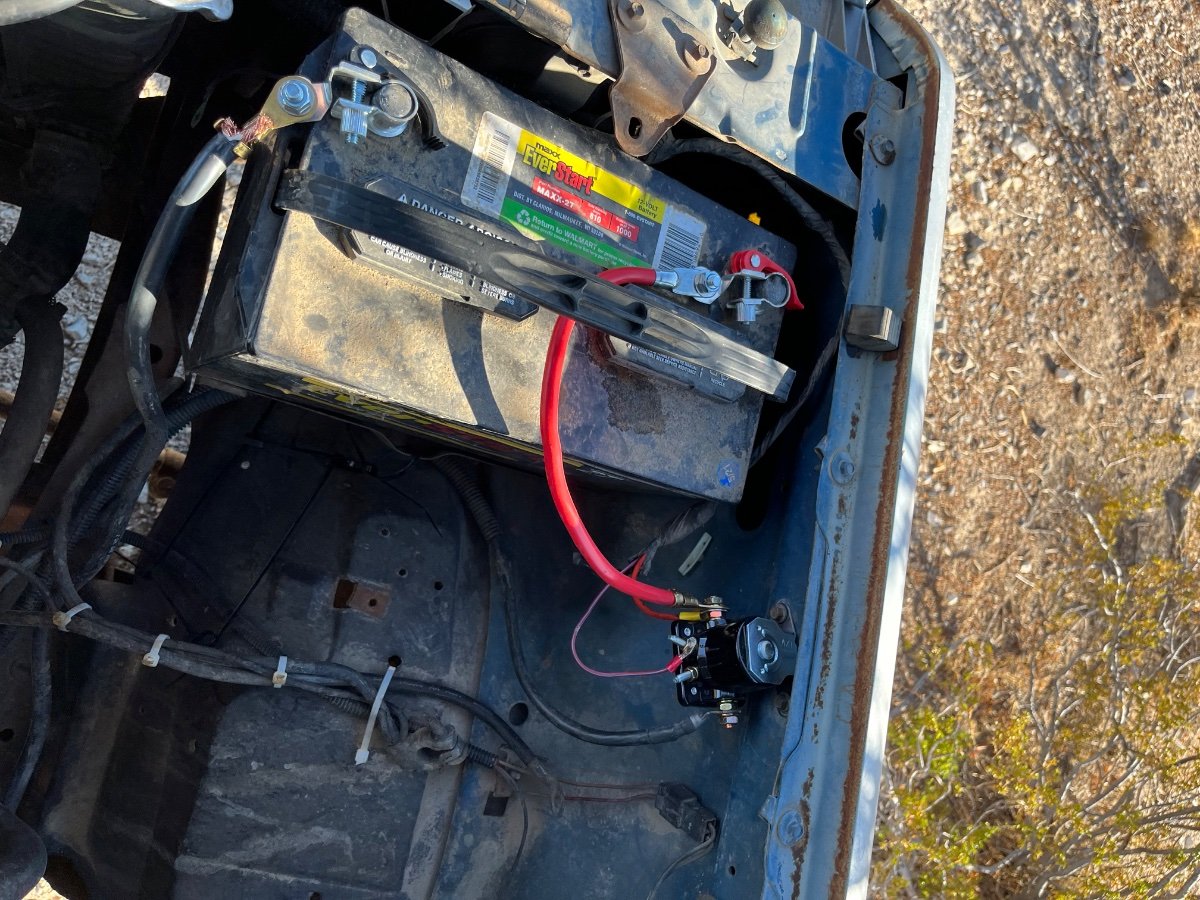

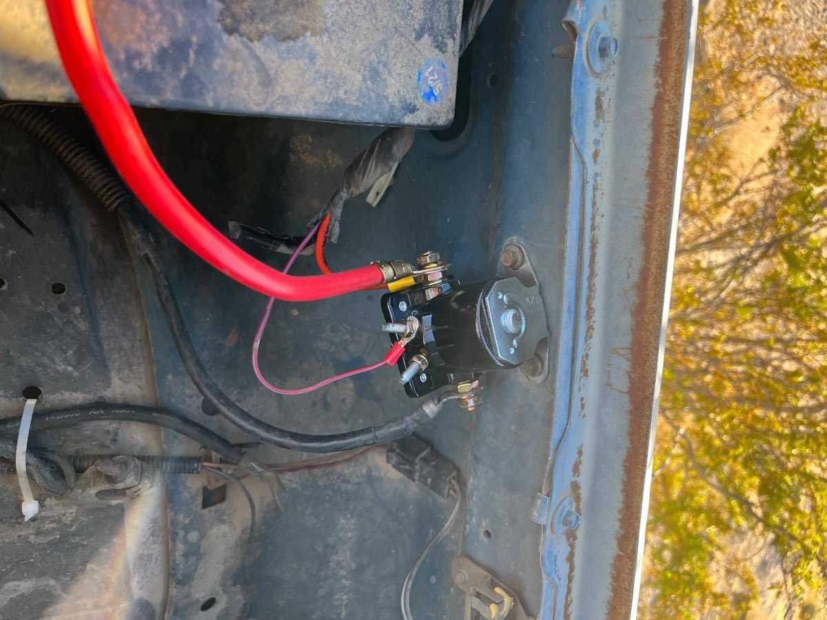

I have an 84 ranger with 2.3 Lima and a 4 speed manual. I recently replaced the starter relay and now my blinkers and reverse lights dont work. All the other lights do still work. I already replaced the flashers, and the hazards still work. Any help is greatly appreciated

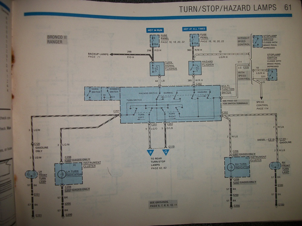

Check for power at fuse #5, which feeds the turns (hazards have their own second flasher). See the diagram below.
Originally, there were several fusible links at the starter relay battery cable; you may want check that all are still there, and maybe clean up some things. You really need a fuse or fusible link on each of the smaller feed wires at their power source.
And please fix that battery ground cable- crimp or solder the right size ring cable onto the cable. Shaving strands makes heat, that starts the copper rotting and the connection WILL fail early.
