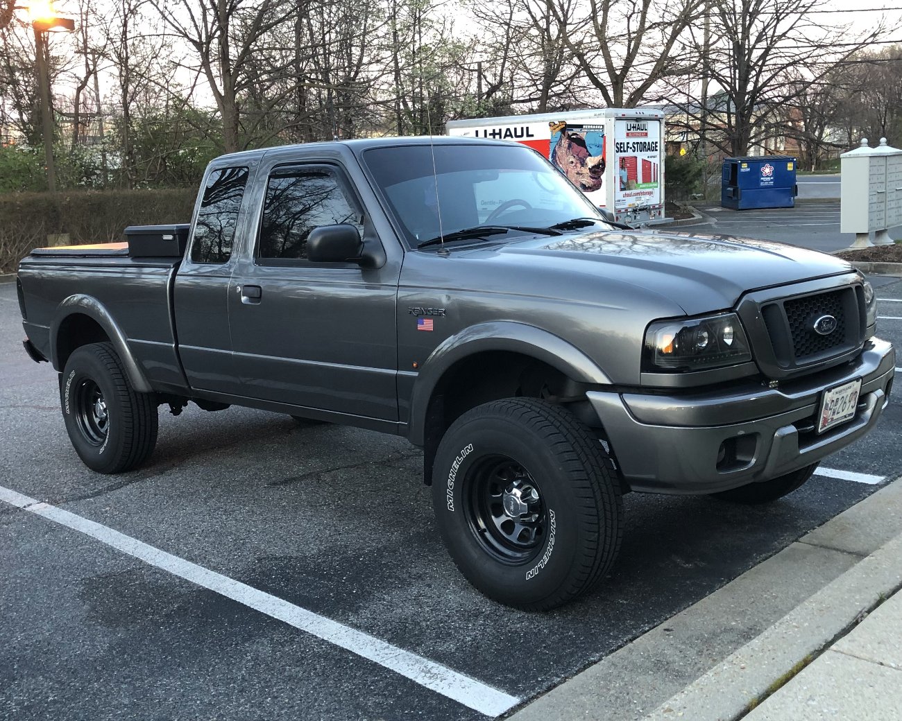

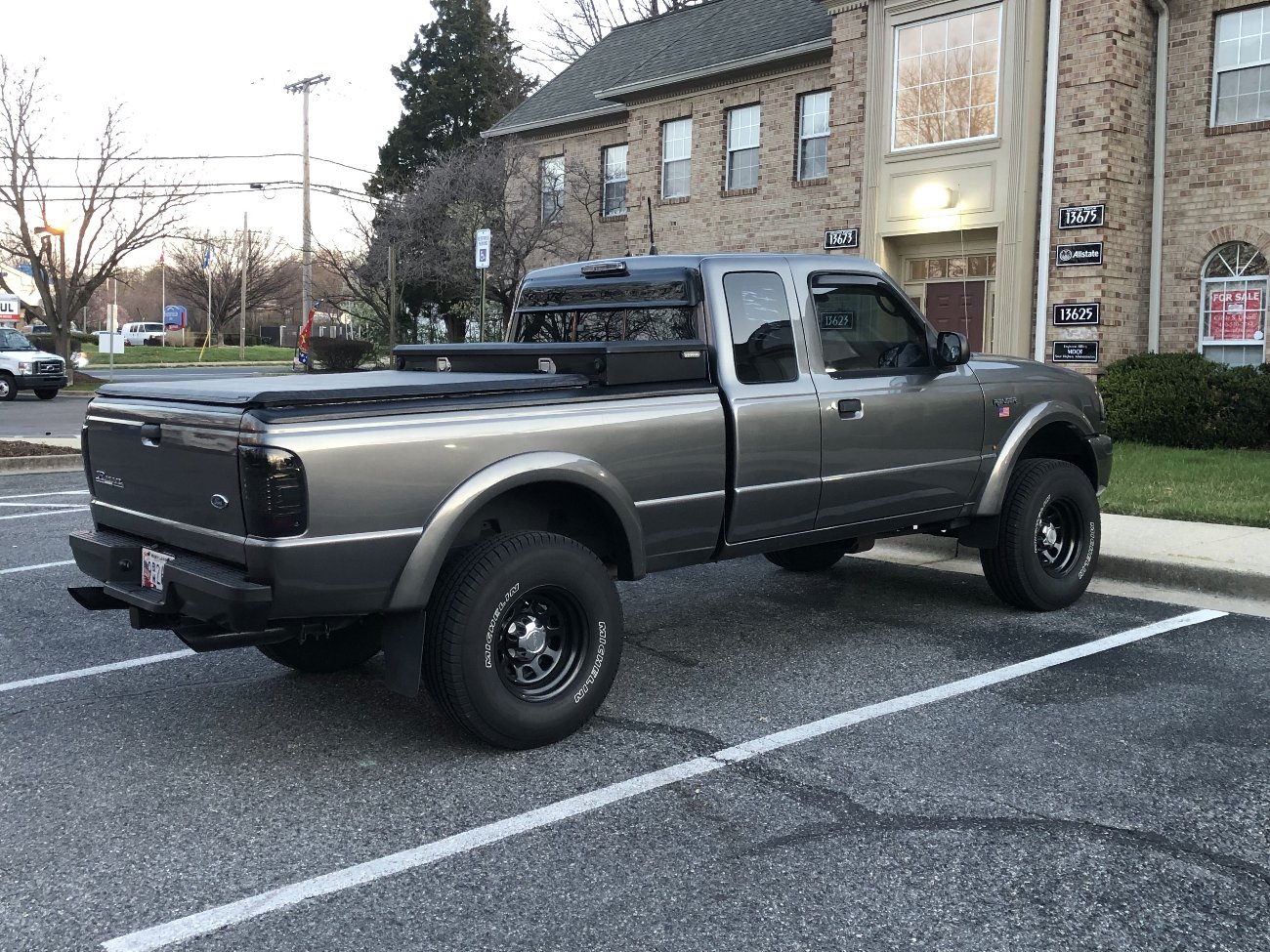

2004 Ranger, 2WD, 175,000 miles, all new parts front(spindle, caliper, pads, rotor, abs sending units) & rear(drums, shoes, all hardware, cylinders), and I performed all the pin point test in the service manual. Using the Forscan on the laptop it shows no ABS codes, I did a module reset, but same , no lights on dash, yet ABS module does not do the initial 5 second run when the truck starts moving, and no ABS action, just, as per the owners manual, the regular hydraulic brakes by themselves.
Any clues left to look for?
