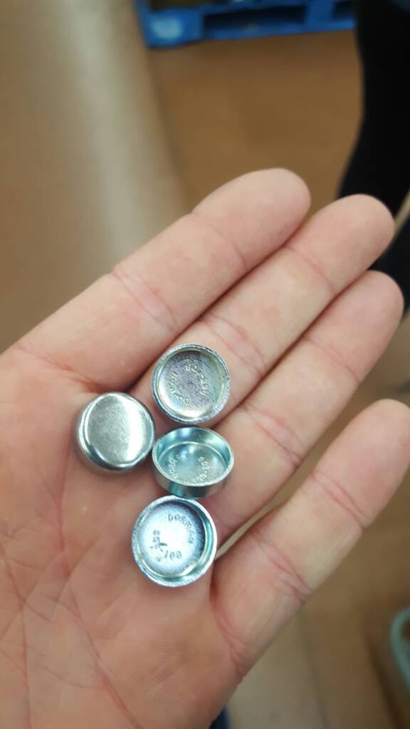

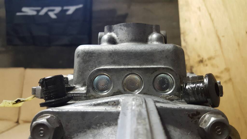

When trans is out or if you get another M5OD you need to replace the rubber shift Rail plugs on the back of trans with metal plugs,
These would leak and over time trans fluid would get low causing input gear to burn out, expensive fix.
Dorman 555-108

replace rubber plugs if possible.
