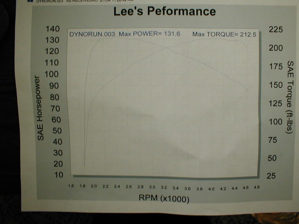

heres a stock OHV 4.0 dyno sheet (a 2.9 would have very similar power curves, a little higher revving due to the smaller bore). notice peak power is just over 4 grand, but begins to taper off just before they cut it. the 2.9's peak power is at 4600, and will also begin to taper afterwards. revving to 6 grand is well out of the powerband and your actually making LESS power then you are below 5 grand.
Looking at this chart it just seems backwards to me. The good torque #'s should be down low and the HP #'s up high. It looks like max HP is at 2400. Or have I been driving a diesel too long. RB
your backwards, your thinking the HP line is the torque line and visa versa. the torque line is the one thats higher at lower rpm.

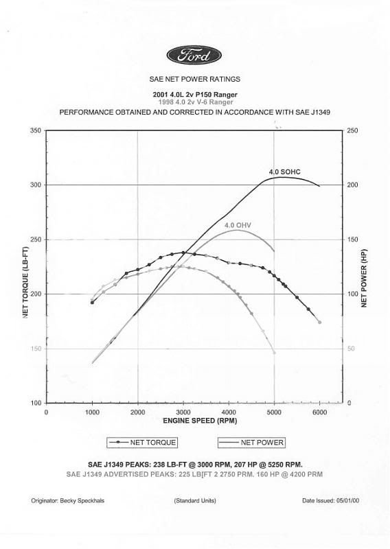

that must be at the tires?25 lb/ft at 1800 rpm's?sorry nope
given the peak ratings, id say thats flywheel. the sheet i posted (with only 131hp) is at the wheels.
thats pretty impressive to be laying down almost the same torque rating at the tires as the flywheel.a healthy 4.0 might make more than the factory suggests.
