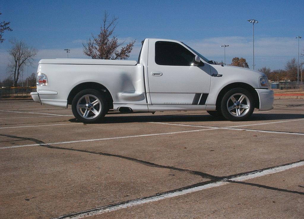

Drove my 98 3.0 from California to Oklahoma with the bed loaded and a trailer with two very large heavy street bikes on it, and the front of the trailer loaded with weight to get the tongue weight proper. Not a problem, even in all the uphill from Phoenix to Flagstaff. Just kept the OD off on the uphills.
But anyway, I don't worry about my Ranger being the fastest. I keep it for driving when the weather is crap, so my LIGHTNING can stay in the garage and stay clean.
The Ranger is just a beater for me.
As much as im not a fan of the 97-03 F150s, (mainly cause they replaced the 92-96), i always thought the lightnings were sharp trucks. My uncle had a black one years ago, it would haul some pretty serious ass.
Those of us that drive Lightning's think it is the ultimate F-150. We all love the flare side body and how it looks. I don't care for the slab side body's though.
