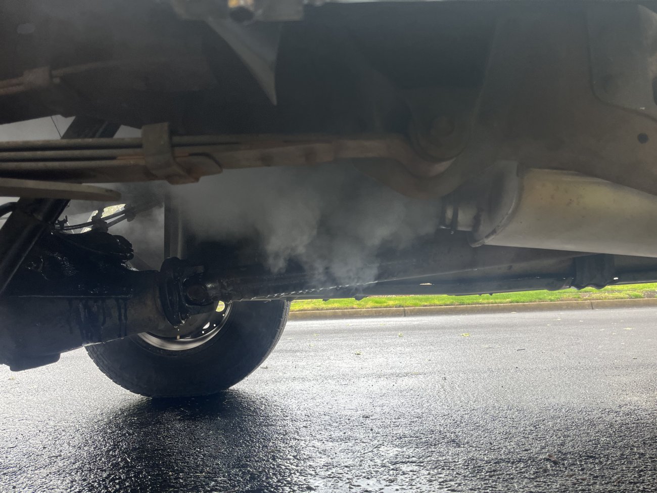

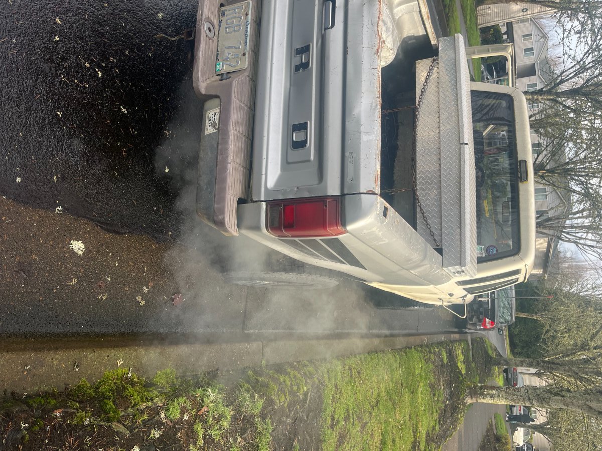

Well I gave fed it some head gasket sealer to see if I could put off the inevitable. And it sent all the head gasket sealer dripping out the exhaust. Whoops!

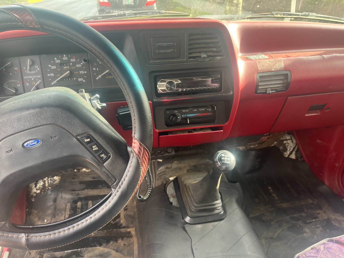

God damn I've been neglecting this forum. So! I got the 2.9 in the ranger. It runs great enough! Whole bunch of kinks to work out on it. Shocks have been replaced cuz they were all toast, stereo/sound system is also in process of being replaced so it'll bump. Most gauges do not work, at least not 100%. Speedo and tach work, fuel gauge reads but it's not accurate, coolant temp is a no, volt meter is not accurate. Tranny is very used (syncros are all but gone), but the clutch is great shape. Tcase shifts... sometimes. Needs new motor. My project for today was replacing the alt on my break at work because it died on me as I was pulling in the parking lot.

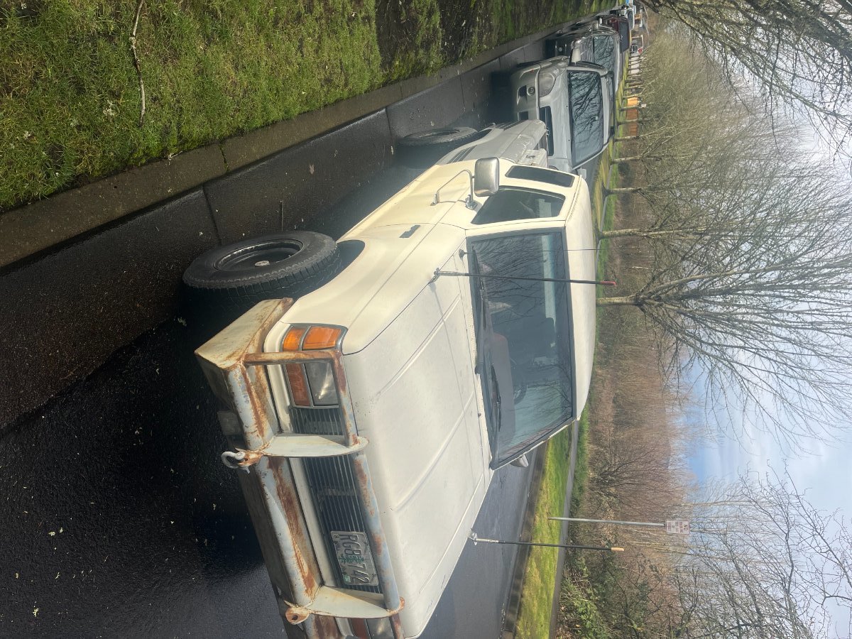

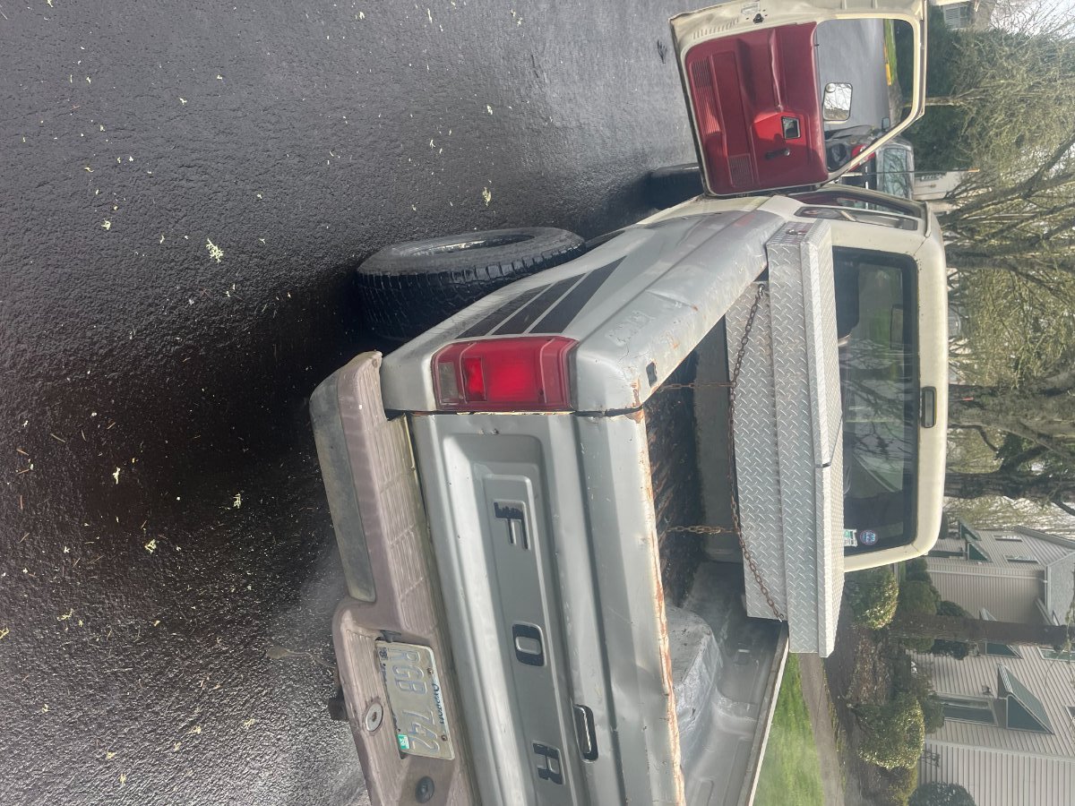

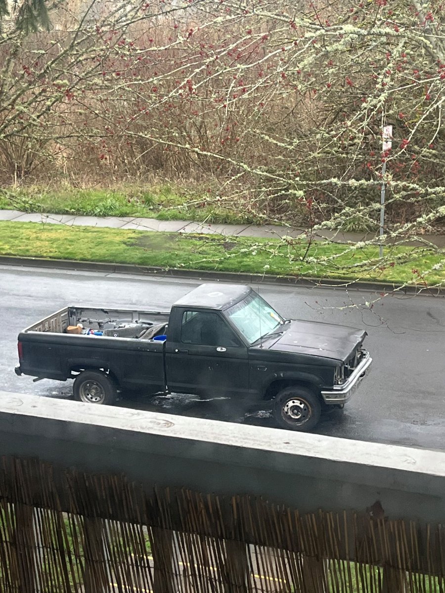

images attached are the donor ranger I used. May god rest it's soul, I gave it away for free after I pulled the engine... and the city started to put tickets on it. Keys on the dash, bill of sale from previous owner, for free. Someone towed it

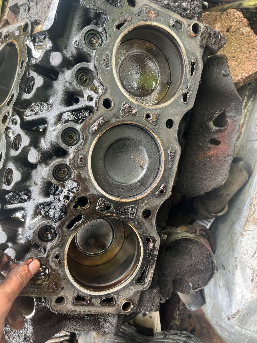

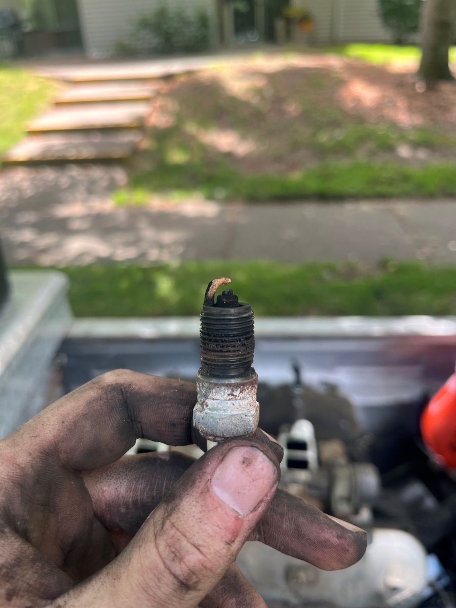

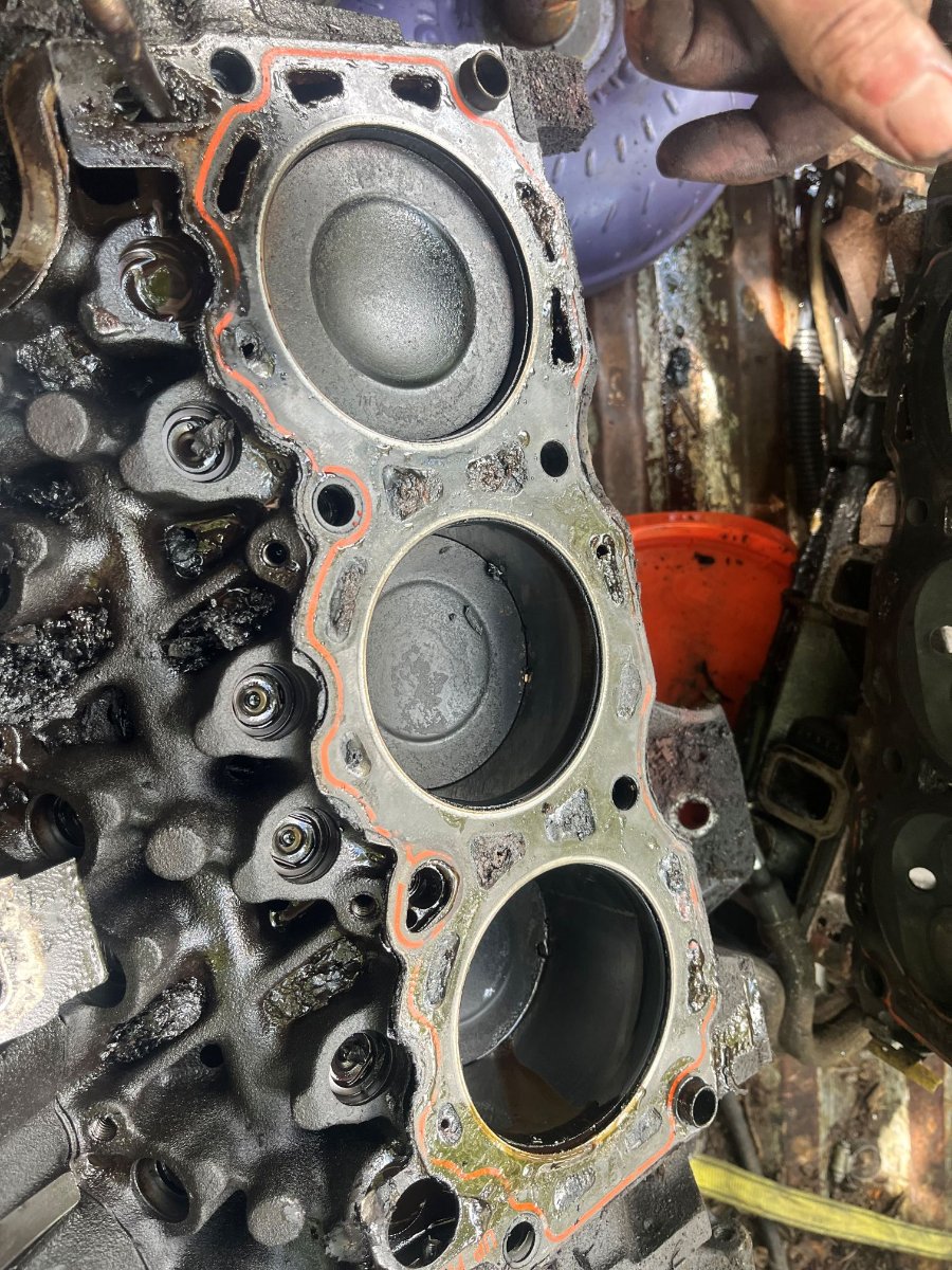

Other images are of the old engine that was pulled. As you can see, blown head gasket. And other... issues. Honestly I'm surprised it was running at all, it looks terrible. I don't know if anything was really usable, I just took it to the dump. Nobody even wanted it for scrap
