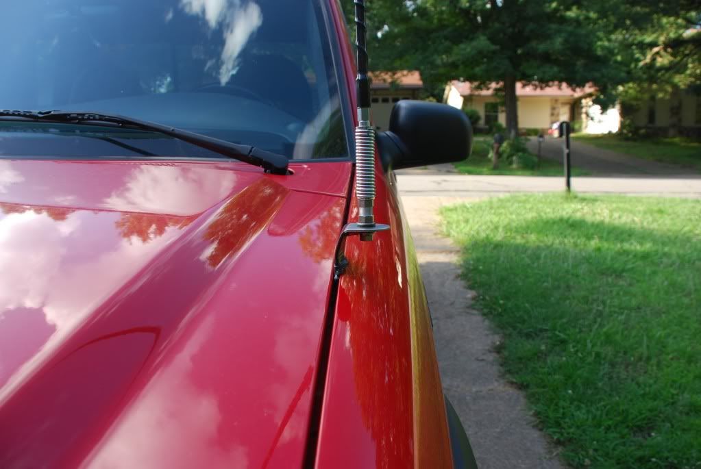

I got it mostly for when I am out wheeling, nothing super far or life critical. The antenna came with a mirror mount but since I don't have tube mirrors I was thinking of mounting it on an 'L' shaped bracket on the hood, like how Fx4wannabe has his mounted. How would I go about getting the antenna tuned? Thanks for the help.

The Cobra has SWR Calibration built in, very simple to tune. You can pick up a SWR Meter cheap at Amazon or somewhere similar if it's not built into your radio.

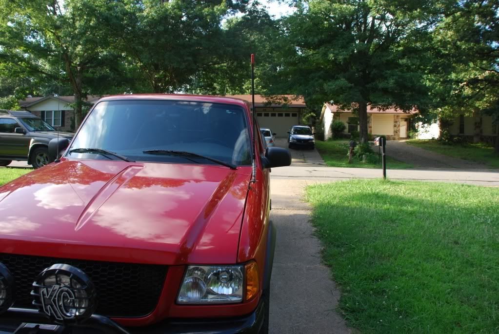

If you're still looking for ideas, I simply MADE my own hood mount for a fixed antennae, and can show you where I routed the cable if you're still looking for ideas...

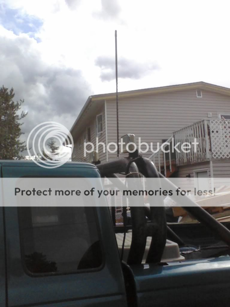

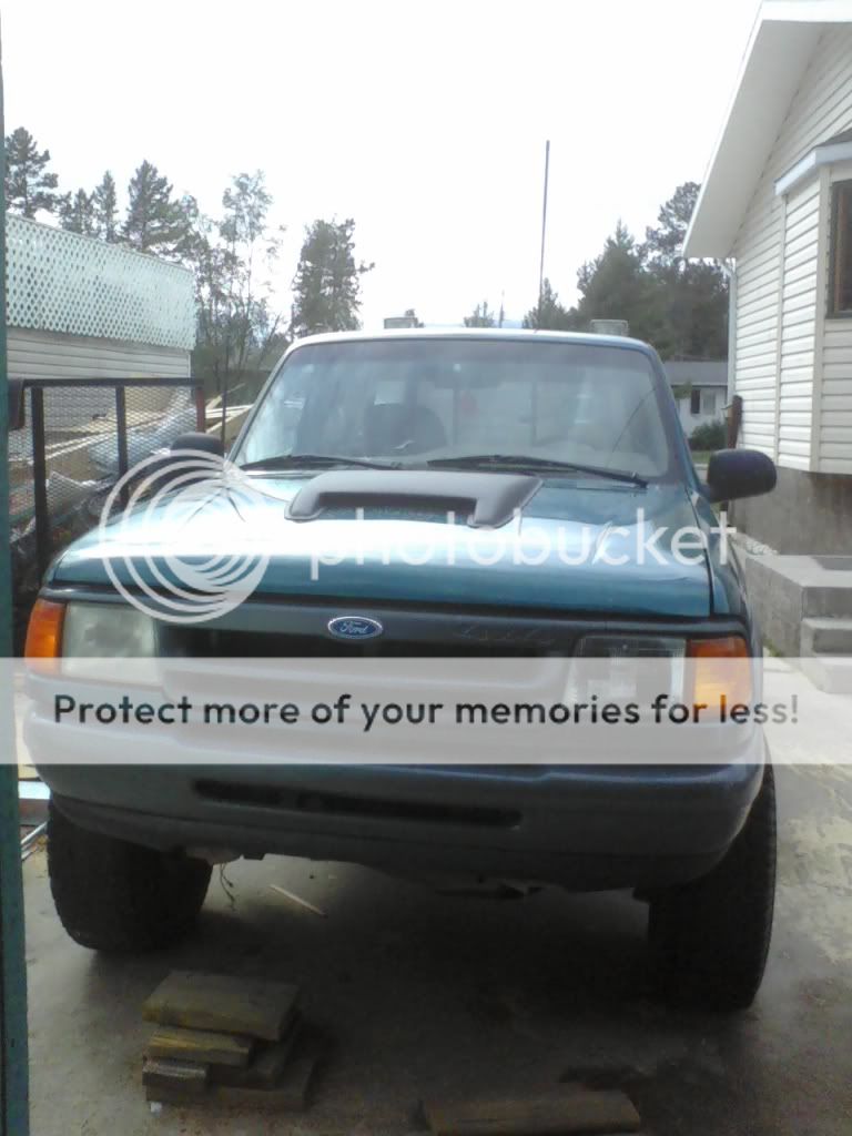

This is how I mounted the antenna on the '93
New to CB's, advice and wisdom wanted.
that should work fine for you there, Mike. if your range isn't what you think you should be getting, you might try adding a thin plate (1/8") at least 10" dia. round or 10" square under it to make a better ground plane. good job!
