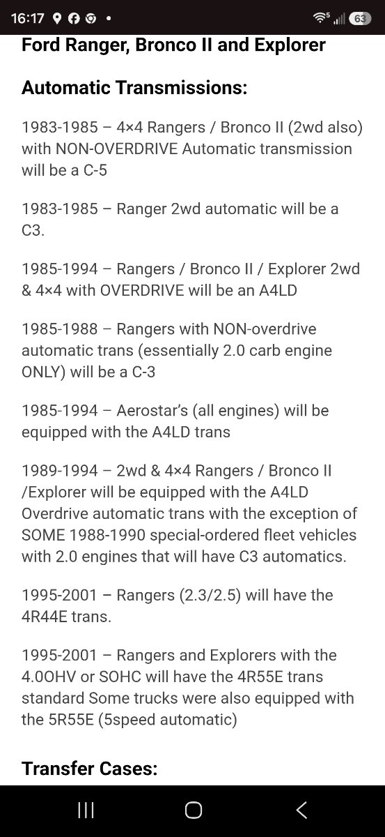

Anyway, I am new to Rangers and I have spent the better part of two days reading as much of this forum as I can. Here is what I could use some assistance with: How do I know if I have the dreaded A4LD tranny? If I do, should I bring it to a reputable (not AAMCO) transmission shop and have a shift kit put in it to help the tranny last?
Hi! And welcome to TRS. As far as I can tell, if your '94 has and automatic Overdrive transmission, and it most likely does, it will be an A4LD.
In addition to our forum, we have a wonderful tech library with helpful info. You may find the info you need in one of the articles here;
And here is a chart I screenshot from one of those articles.

95 up will have an A4LD variant (4r44e, 4r55e, 5r44e, 5r55e)
94 and older back to '85 will have an A4LD of some sort, they went through a couple revisions but are all very similar
