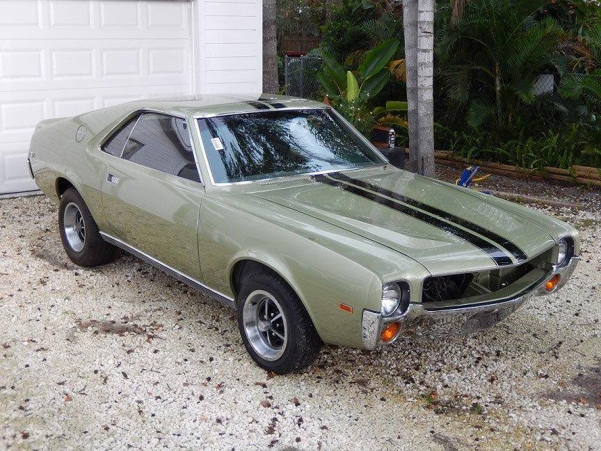

Here's a pic of my 68 AMX that is 99% finished (doing a Holley Sniper conversion at the moment) just to give you an idea that I am fairly competent at tuning a wrench. :)

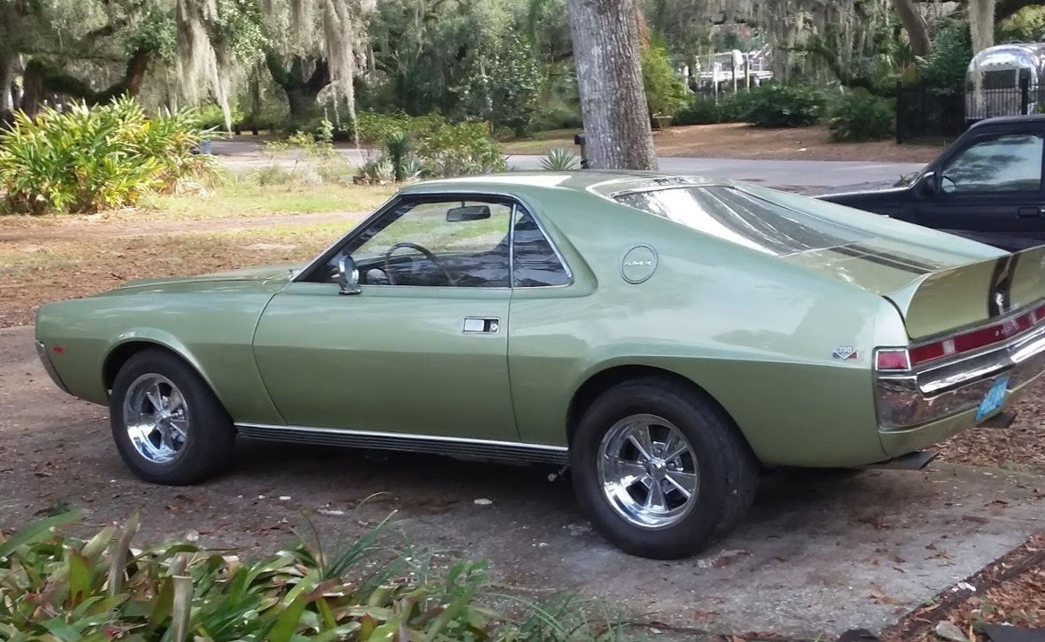

Here's a pic of my 68 AMX that I'm 99% done with... it was taken back to bare metal and pretty much everything has been either rebuilt, restored or replaced. I did a 5 speed swap in it (I wanted OD) and it has a built 401.... figured I throw this out there to show I am at least familiar with turning a wrench...
