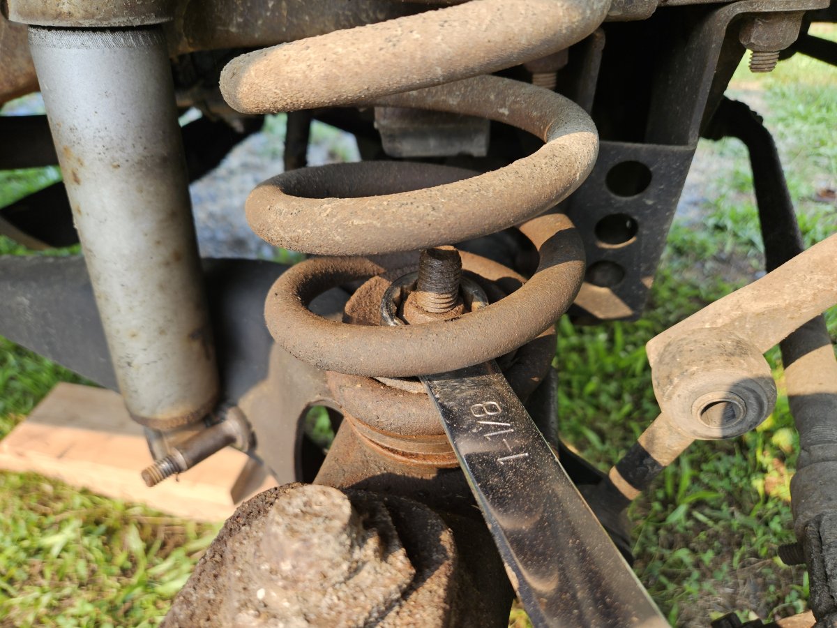

So I ended up picking up a lvl kit was easy but also crusty bolts are always a fun one. Took it in for alignment and they gave me a bs list of crap wrong. The only thing they got right was the driver side wheel bearing. My buddy is a long time les schwab employee and former alignment tech. Came and looked at it to confirm my thoughts of only a bad wheel bearing. Said they probably didn't want to do the alignment since it's more work with the bushing style camber.
I measured the nut with a adjustable wrench came out to 1 ⅛. But the nut was probably 1". Needed a 1⅛ wrench for suppressor mounts so win win.

30 mm socket is what you need to get that nut off. I just installed my leveling springs today.

I did not take any pictures during the install. I bought a 1/2" drive impact set from Harbor Freight, used a couple of extensions and went in through the top of the coil. Took all of an hour per side and that was with me taking my time.
Hardest part was making sure the coil was seated in the top of the coil bucket correctly before reinstalling the washer and bolt on the axle side.
