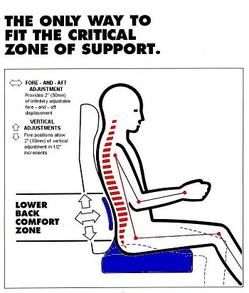

I have 60/40 bucket seats that had terrible lumbar support. I fixed that long ago by peeling back the seat fabric, inserting a small piece of plywood (say 10"x20") with a horizontal 2"x3" piece of wood nailed to it (flat side against plywood). I rounded the edges of the 2"x3" and placed it exactly where it felt most comfy. Now it's perfect. Nice!
It sounds kinda ghetto, but it really works. And you'd never know what's inside there.

I suggested a DIY comfy lumbar support. Ranger seats have none. Yes, plywood goes underneath the seatback cloth cover, extending upwards towards shoulder blades (ie, your upper back). The wooden 2" x 3" (like a skinny 2"x4") is nailed flat to the front of the plywood, going sideways across your back's lumbar region. This makes a nice solid hump, hidden under the seatback cushion. It pushes into your lower back, giving it the needed support, and it curves your lower spine forward, like it should be. You'll want to round off (sculpt) the edges that press against your spine. It's kinda like having a paperback book placed behind your lower back, like in that photo. I like having it. Neighbors do too.
