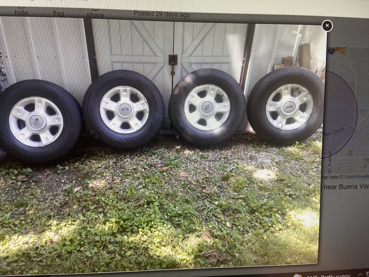

Thank you guys. I just found these off a sportctrac. They would look good on there if they would fit

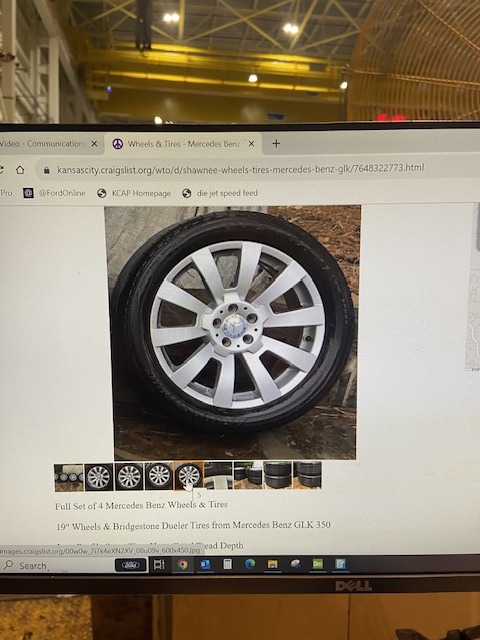

I also found some Mercedes wheels pictured above
You need to be careful with back spacing on wheels. I kinda doubt those Benz wheels would work without wheel spacers.

Trying to see if the sport trac wheels would just bolt on and be ok. They have almost brand new tires on them and I think they would make the truck look pretty good
The sporttrac wheels *should* have the proper backspacing/offset to fit the ranger.
Those merc wheels are almost guaranteed to need spacers.

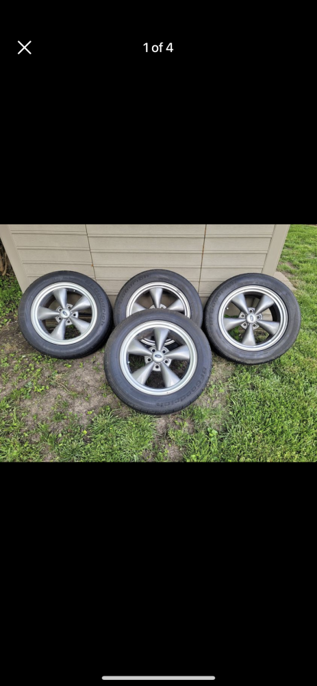

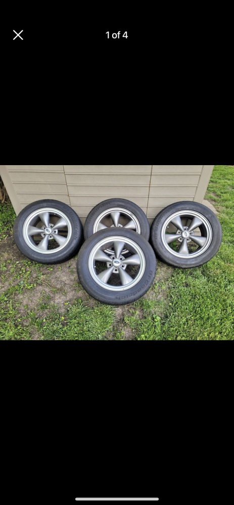

Anyone know what these are off and if they will fit?
Need wheel and or tire suggestions
Those are Mustang wheels. They need about 1" to 1.5" of spacer or adapter to work. I have Mustang wheels on my truck now w/ 1.25" adapters.

Anyone know what these are off and if they will fit?View attachment 96020
Mid 00's mustang. I had them on a 99 crown vic. I had to run like 1/4 inch spacer...and it would rub if i went full lock right.
The wheels will fit fine but the Sport Trac OE size of 255/70-16 will probably be too tall for a 2wd Ranger. You could sell the tires and I'd say get 235/60-16 at most.
