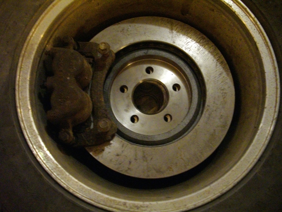

I don't know how well the pictures show the fitment, so I'll add some comments.
Rotor is a 13" Mustang Cobra; it still has packing grease on it. (At least it won't squeak. :icon_rofl:)
Pictures 1 & 2 show 16" wheels - wheel 1 is Mustang 5 spoke, wheel 2 is Explorer. As I attempted to show in the photos, there is ~1/8" contact between the caliper and the wheel before the center holes align (and caliper is pushed down to point it contacts rotor). So, these 16" wheels and 13" rotors won't work together. :bawling: (I should try my spacers with the 'stang rim as it does have ~3/4" deeper backspacing and the further out the rim is, the more clearance there is).

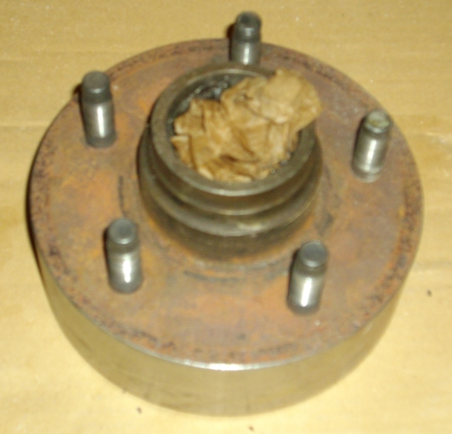

Picture 4 shows the Ranger hub post lathe work (rotor removed). :icon_welder:
