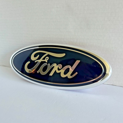

My front ford badge on my 2010 ranger fell off somewhere on the way to work today. UGG!! looking for a source to replace it in SE Michigan or online source. Any TRS Members help would really be appreciated. Thanks.
Anyone able to remove the ford emblem from the front grill without removing the grill to get the old one off?
I haven't done it. But if you can reach it, it should be doable. The one on my Explorer had stamped metal nuts pushed onto plastic posts coming off the back of the emblem. I think 10mm socket should fit to spin the nuts off.
What @Curious Hound said. Probably going to go up from the bottom, in between the bumper and radiator. Depending on your age and back strength, it might be worth it to just remove the grill. it's like 8-10 Phillips head screws, but also, some of those screws are behind lights, that also probably need to be removed.
