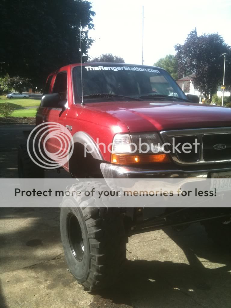

Narrow dana 44/ford 8.8 sas xlt ranger
flex it OUT!!
Yeah with your nice shock spring set up and long radius arms that truck will flex out really nice! You might even be able to get ride of some of the body lift to make it a more stable trail tuck as well! just my thoughts.
i want to take the body lift off but idk when i can cause i need to work out the ABS... but i hope it will flex cause i got really strong springs.:icon_confused:
but after ithe snow season and i have cash i want to throw on the dana 60!!! and make it a trail truck and do moter work and take off all the emmissions shit and make it sick... just a thought

thats pretty good, just ditch the body lift and it would look tons better
agreed.. ditch the body lift. it actually flexes more than i thought it would... i had little hopes. most trucks that tall are done w/ just super stiff and posers only.
Yeah I want that body lift gone!!! And get 39.5 but thanks guys! It flexed more then I thought also but the back tires didn't come off so it should have more to go but the tractors hydroids are old so I'm going to find a ramp

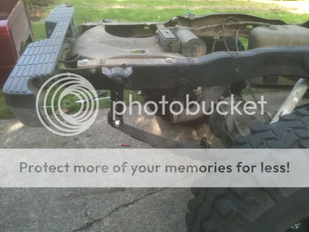

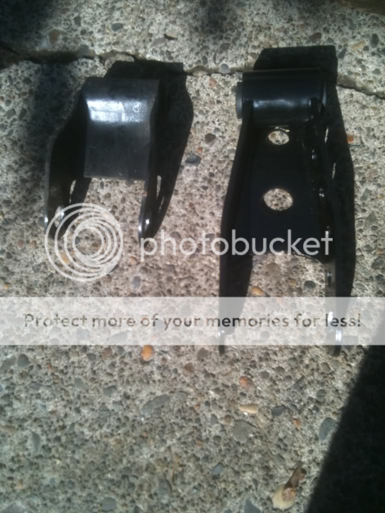

Your shackle angle looks terrible! At full droop the shackle should be vertical and at full stuff the shackle should be horizontal. Or as close to that combination as possible. Just my opinion tho.
yeah that was what i thought but that is life for right now it rides good :sad:
