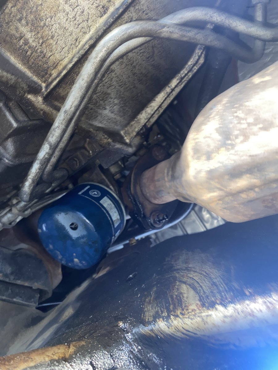

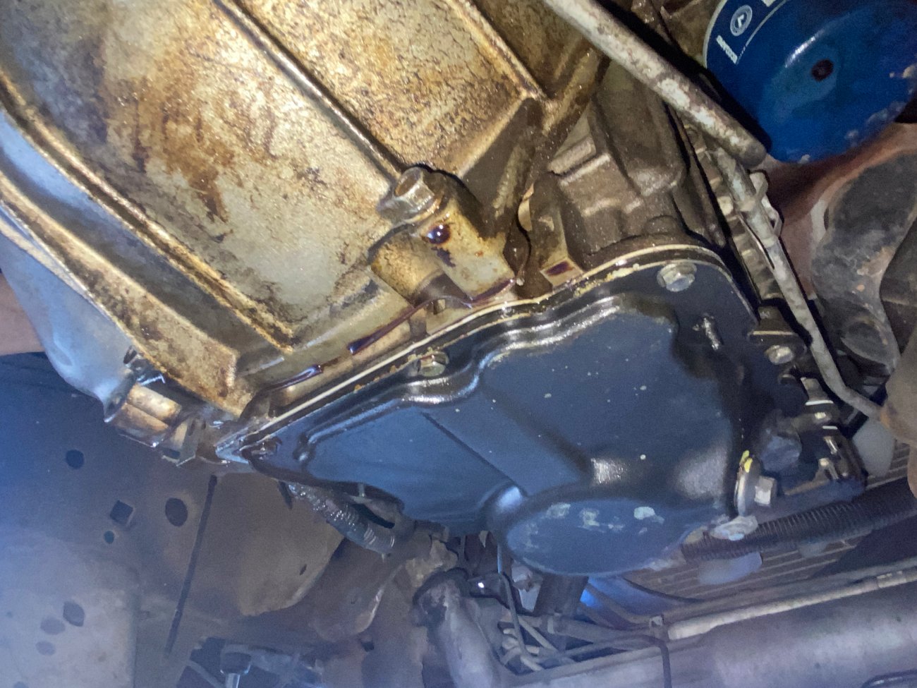

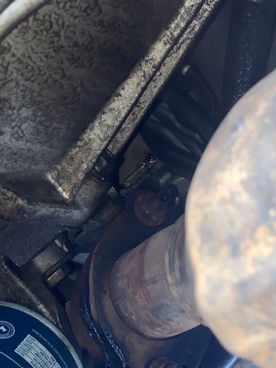

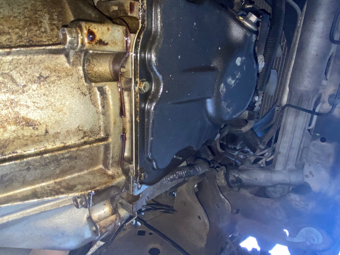

I have a 09 v6 and noticed there is some oil around the pan, and I have a feeling I am going to need to replace both oil pan gaskets. But there is some oil on the passenger side frame rail and seems to coming from somewhere higher up, there some oil on the filter some seemingly on the exhaust. I was wondering if anyone else had this before and can help me out.

It looks like oil that blows off while driving. But, check the valve cover gasket too in case its running dripping over that way from something

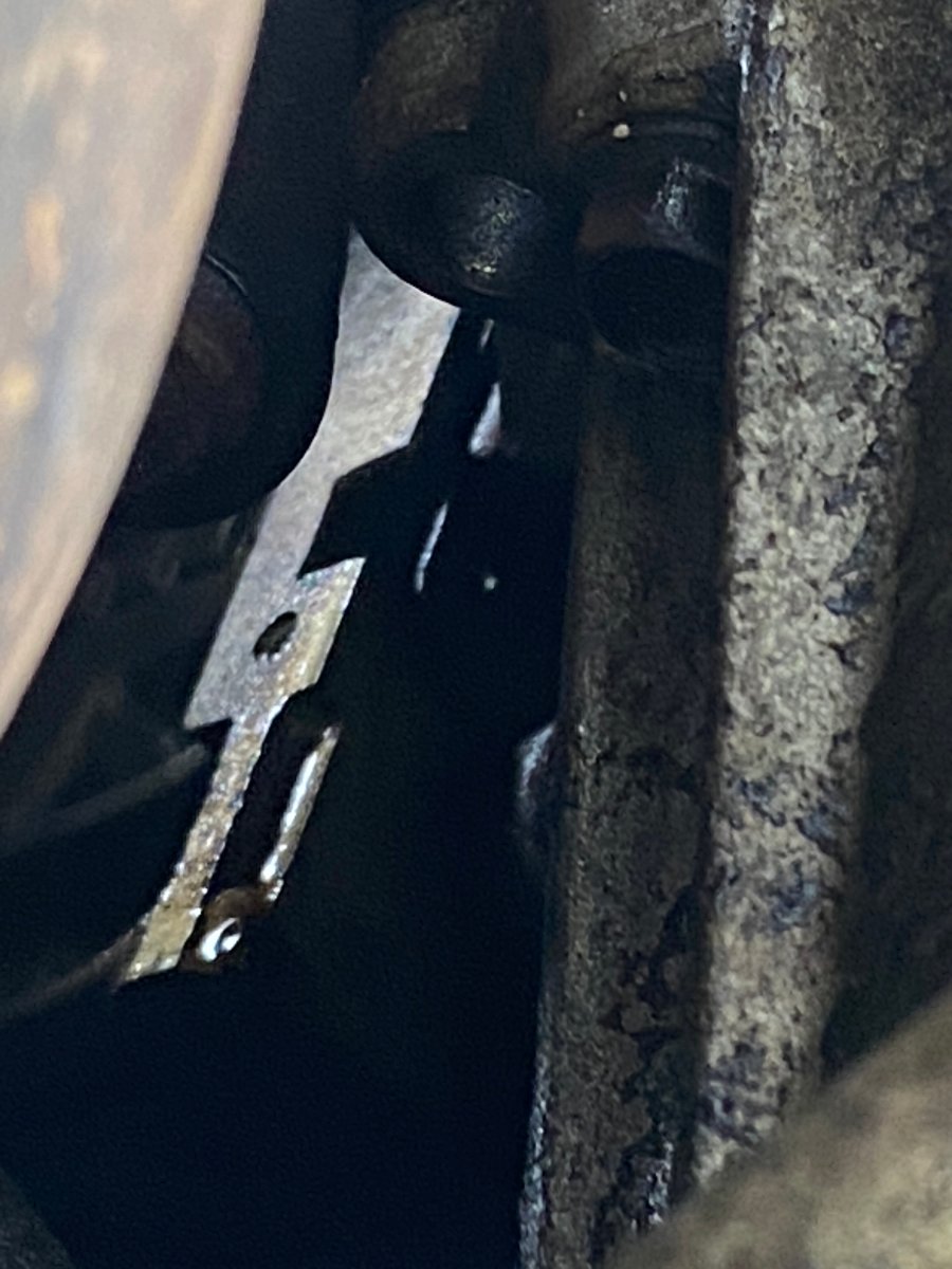

here is a picture I took of the back of the head, seems to be some oil there too. Over on reddit someone mentioned a plug(the drain plug), I am not sure what they meant since there is oil where it wouldn't reach but I thought I mention that. I am thinking about buying some oil dye and replacing the lower oil pan gasket since the upper one is a more intense process.

Those can lose a lot of oil. I have the older OHV version of the 4.0, and I was losing a quart every 100-200 miles through my valve cover gaskets without leaving any marks on the ground. The only real noticeable sign was that there was a lot of that oily dirt buildup on the backs of my heads and a measurable depth of it on the top of my bellhousing. I didn't even realize the sides of my heads around the spark plugs were staying wet with oil because it was staying so uniformly darkened until it all got cleaned off one day and then came back within 40 miles.

OP's looks much worse.
