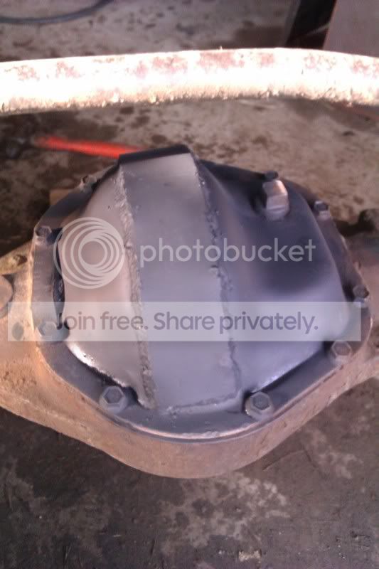

Also threw some steel onto the diff covers bc im to cheap to buy the fancy ones lol
