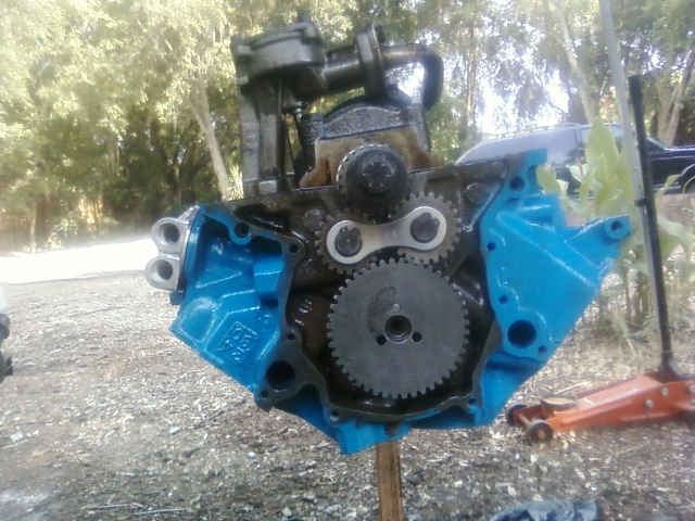

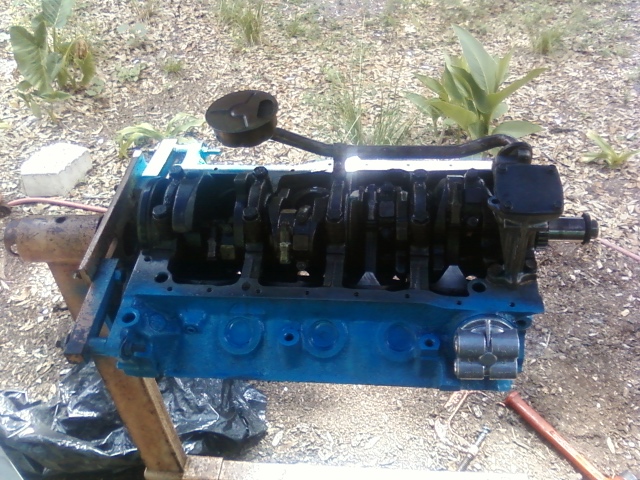

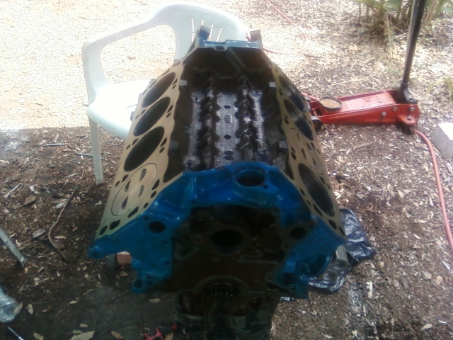

Been playing with this one for a while,thought I'd post some pics
  • My V-8 B2
  • My V-8 B2

  • My V-8 B2

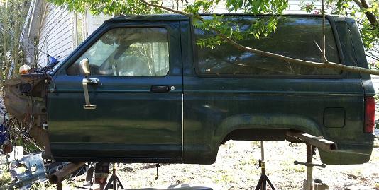

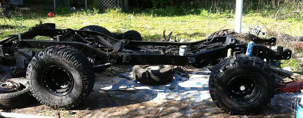

trying to decide on which setup I want to go with 1. 78 bronco running gear or 2. leaf sprung 1/2 dodge
84 302 w/big cam,gear drive distributor,aluminum 4 bbl intake,edelbrock 600 c-4 tranny w/2200 rpm stall converter and kevlar bands 15x8 black streetlok wheels 10.5x34 super swampers on front and 12.5x35 MT baja claw radials on rear
Hoping to set the body back on frame this weekend. Have new red energy suspension body mounts and "nhl" 3" body lift
ran into a small snag, cant find all my body mounts. Guess I will tear my shop apart on friday to avoid buying another set. Have more pics, cant get them to post
