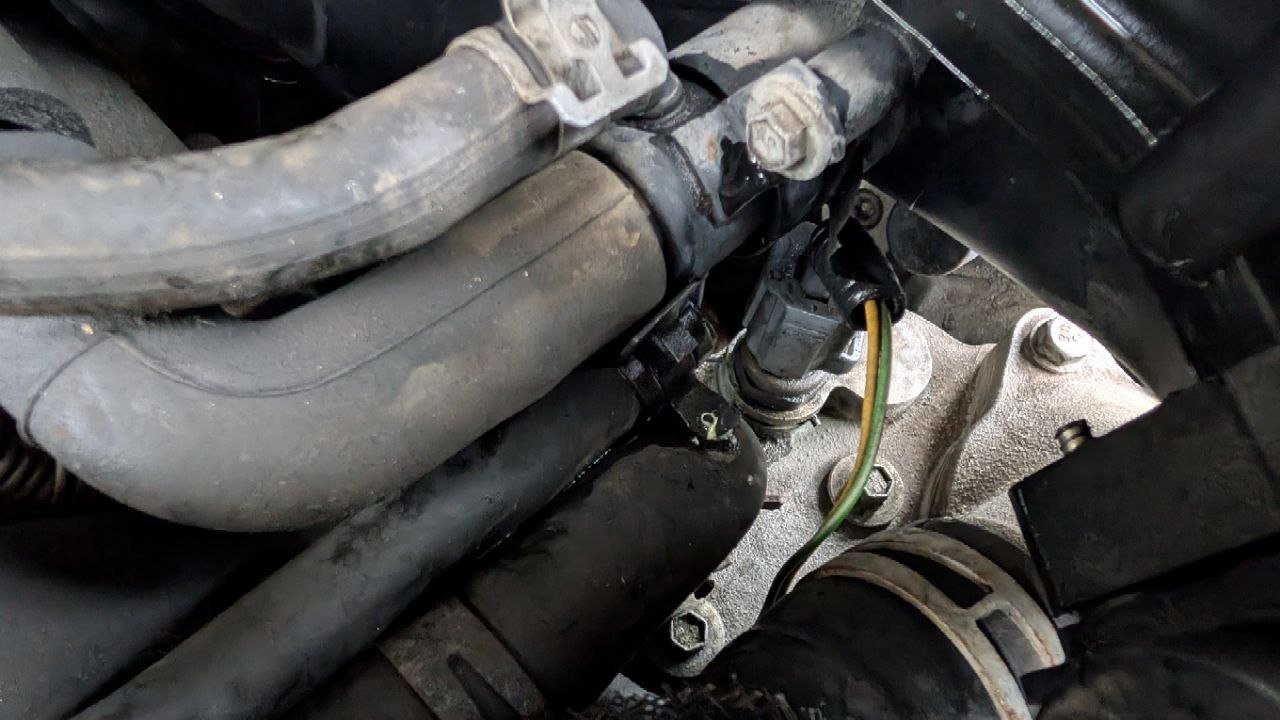

I know my truck is running on 19 years old so, shes getting a little old but I do maintain it and I dont usually have issues. Though things break and a long time ago my trucks thermostat housing exploded (literally) twice and after replacing that with a quality part I havent had issues since.
Well today I was out an about and saw the temp spike, pulled over and shut it down just as the red warning light was coming on. The thermostat housing wasnt leaking and I was really worried this might have been the headgasket going.
I carry a jug of coolant with my so I let it cool down, filled it up and limped it home. At home I filled the radiator completley with water started it up and sure enough I saw the leak.
Turns out one of the heater hoses had been punctured by a clamp and and was spewing water. So, truck is still fine and will live to see another day with a new oem 20 dollar hose. (gonna change clamps to keep that from happening again as well)
