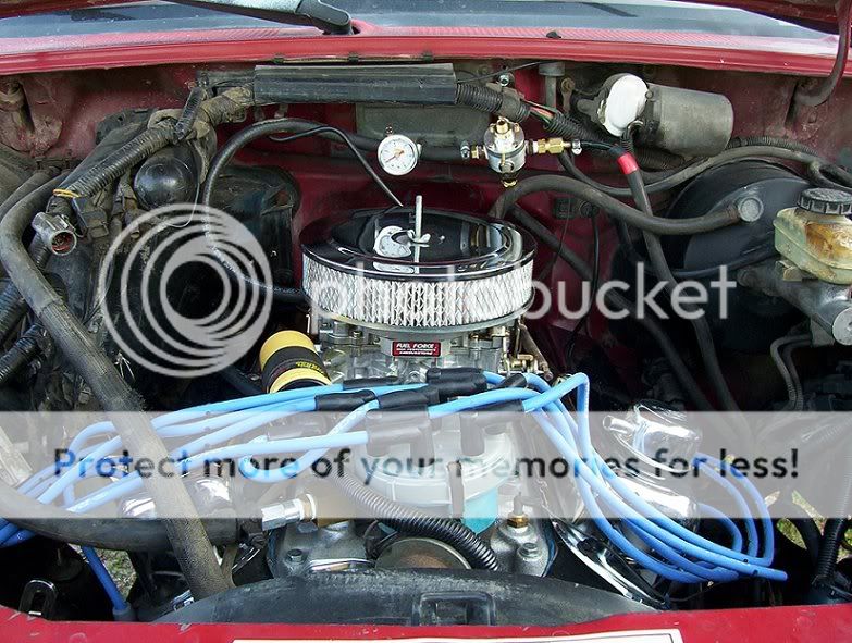

My OL' Red Project.......
hey
hey man nice looking truck what did you use for your motor mounts ?
I had plates made and used my existing rubber mount...sat the motor a little high but with the body lift, no worries......sat the radiator in and there's about 1-2 inches between it and the fan....looks good.......

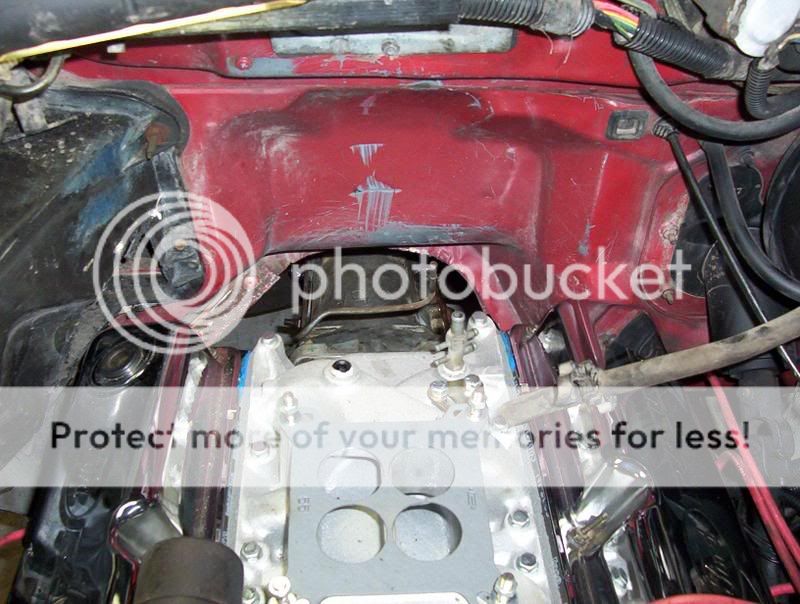

In the infamous words of Dr. Frankenstein....IT'S ALIVE!!!!!! IT'S ALIVE!!!!!!!!!!!! I got it started last night and it sounds great with no exhaust:) I get my rear shaft extended and do all my plumbing and acessories I'll be on the road....:tease:
very cool man!

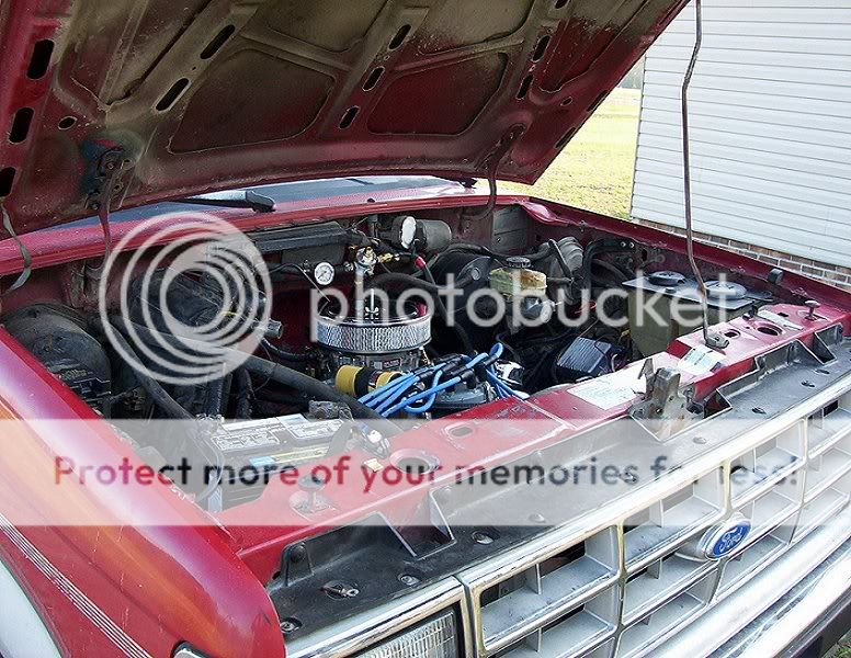

Ol' Red's motor swap is 99% complete....project is almost over:
Looks good man!!! Hmmmmm my 2.9 looking like its gota go soon. hmmmmmm
lookin good man i just started pullin the 2.9 last night . cant wait to drop that 5.0 in you must be stoked
