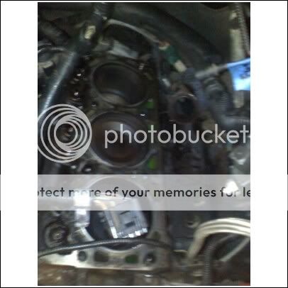

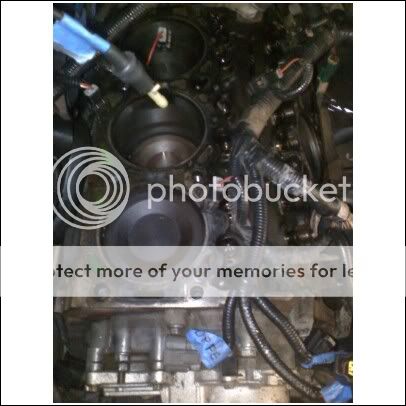

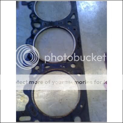

Sooo. I got the engine torn down. As far as I can tell, the heads aren't cracked and neither are the gaskets. I will confirm this after I finish cleaning them up tomorrow. You can see on the heads and head gaskets where it was leaking. I also have to do a valve job. The intake valve on #2 has a BAD leak. I flipped the heads upside down in the wash tank and covered the intake and exhaust valves on each side with varsol. #2 was the only one that leaked but i'm going to do them all. Hopefully I can get started on that tomorrow. Sorry about the crappy cell phone pictures.

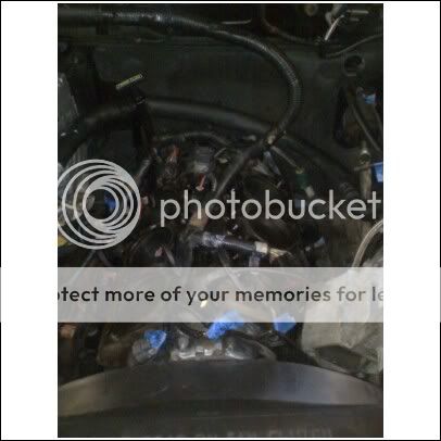

Before anyone asks, the blue "things" are labels I put on each sensor and vacuum line. There's nothing more annoying than putting all that hard work wondering where shit goes. I also labeled all the pushrods and other bolts.

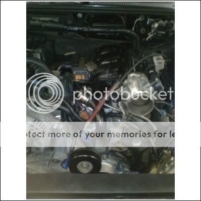

Can't believe I didn't update this sooner....it lives!!! I got it running and back together. It runs like a freakin top! I have to replace the steering rack on monday and do the ball joints too. When we test drove it the steering wheel started shaking as it was doing the death wobble. Put it back up on the lift and the inner tie rods are shot. All I have to do now is swap seats, tires, steering rack, ball joints, and swap over rotors and pads.
Here's a pic, I forgot to take one after I got everything back together.
