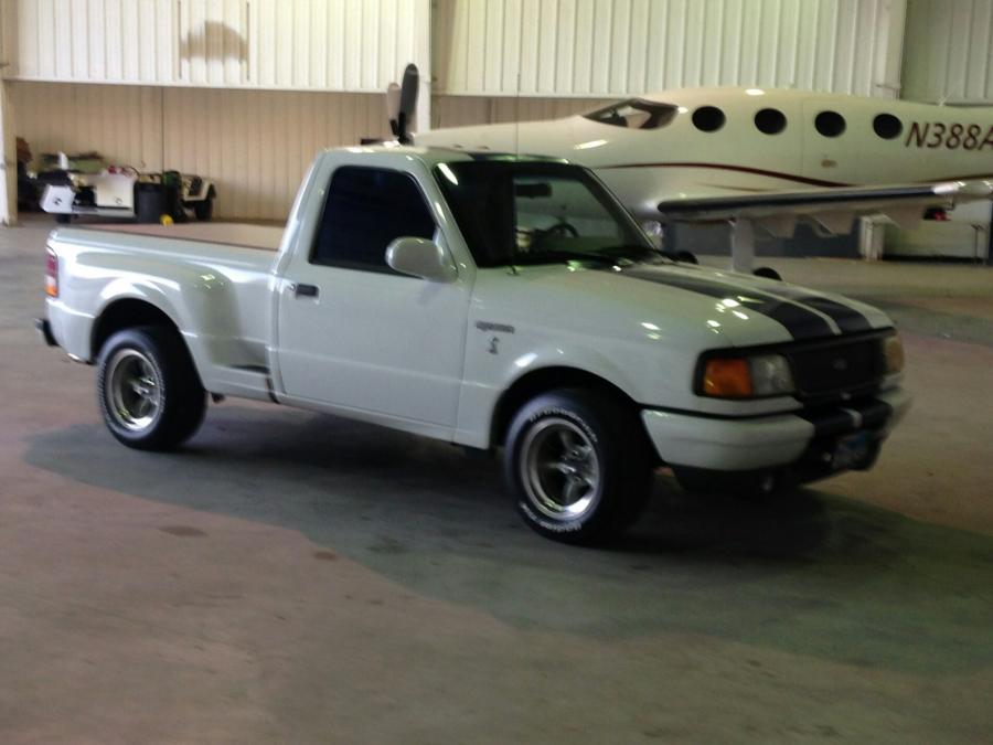

My idea of a Shelby Ranger if there would have been one.

Those are the same wheels and tires I want. I didn't think they would fit the front or the rear. Your truck is amazing!
thanks Bud. The fronts rub the sway bar turning hard right but not at all turning left.. I'd go 8 inch wide if I could go back and redo.. I'd keep the 10.5s on the back for sure..
I like the Shelby look as well, here is my interpretation of what a Shelby Ranger May have looked like. Its a 94 with the 3.0 5spd with hurst shifter, jet chip, roush dual exhaust, 4x4 spoiler and lights, 15x8.5 American racing Torque thrust and Radial T/A's.

Just found a major problem.. the 1" rear sway bar hit the speed sensor and broke the pig tail.. it's also rubbing the right shock to the point of denting it and it's rubbing the fuel tank.. Too big for a lowered truck.. It's going up for sale as soon as I take it off.. Also discovered the exhaust is rusted out... Needs to be replaced.

Nice looking truck bud.
Yeah, pretty sure those monsters are meant for the lifted versions with big tires.
1/2"-3/4" should be all you need so long as the suspension is tuned properly.
Your rear suspension is mostly stock right. I know it's lowered, I'm just referring to the way things are laid out. Mine will be set up more like an Explorer, so hopefully I'll still be able to use my 1" bar if I come up with the right brackets for an Explorer axle.
If you do decide to sell off that 1" bar LMK. I'll probably drive up and get it if I have time. Want one for the 99 Ranger 4wd. It's slightly lifted, but its mostly street driven with over sized tires, weak springs, and a heavy camper shell. Definitely feels like it could use a stiffer bar in the rear. Already have a large front bar from an Explorer to use with it.

It's set up the way ford set it up except I used lowering hangers to drop it 4".. I' will be selling it for sure as soon as I have a chance to take it off. if you want it you have first dibs... I got to hit pull a part soon to pick up the speed sensor pigtail.. Makes sense now as to why the ABS light is on... I'm replacing the shocks with air shocks because I'm hauling heavy stuff from time to time and it will squat way to low... maybe why the sway bar did what it did...
exhaust should be here tomorrow.. going back stock style with a cat back muffler and tailpipe.
When you pull off the rear sway bar, could you get a pic with a carpenters square laying beside it? Long side of square parallel to the long side of the bar. I want to see the length of the arms as well as orientation to compare to the f150 bar I bent to fit my truck.
Yeah, I'm pretty certain that want it. I'm not in a rush, so let me know when you're ready.
Mine's going together more like an Explorer. Explorer axle and springs with spring under axle, but I'll probably use a shackle to raise it back up a little for tire clearance. Both shocks behind axle using Explorer plates, and upper end will go to a cross member I haven't built yet. Will also be putting in a fuel cell behind the axle once I've got the shock cross member built. Won't be running ABS so I shouldn't need the rear speed sensor, will only have it installed to plug the hole unless I find something better.
Hoping that with nothing else in front of the axle I'll be able to run the BII bar with no interference. If not I'll probably be looking for an aftermarket Explorer bar.
I hear you on the air shocks. Had them on the 84 for that very reason. I've considered putting them on this one, but not sure its going to happen. I've still got the 99 4x4 that I'm going to be dropping it back down to stock ride height and installing heavy duty leaf springs. My next project truck will be a 68 F-100 4x4 with a 390, staying mostly stock with a few upgrades (Brakes and EFI). Either of those would be much better pullers. I've also got a spare bed first gen that I'm turning into a trailer, so if I do need to pull something heavy with the little truck it'll probably go on the trailer.
