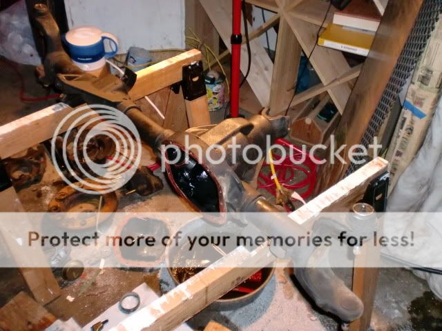

axle
looks like all i got to do is drill out these few holes then the tubes should come right out. only problem is my drill bits aren't sharp enough, so i have to haul it down to school and use theres, or maybe plasma it if that don't work.

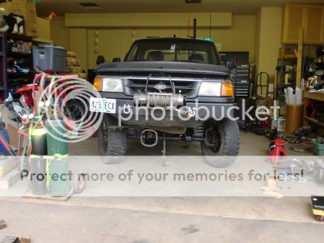

got the whole front end all tore out, crossmember w/ t case bolted in place, got the tubes switched ready for re-welding, radious arms most of the way built. stuff is finally coming allong ! :icon_welder:
Ok, I read through your whole thread and Im confused. What axle are you using? Why did you switch it to passenger side drop? And what t-case you usin to work with your passenger side drop axle? And it looks like you are sagging heavily on your driver side.
I was wondering the same thing.....looks like it's an old D30 from CJ7 or 5 on dana 300 tcase
thats not a dana 30 from a CJ, its from a YJ. and thats not a D300 either.
case looks like samurai or toyota perhaps.
maybe he horribly ****ed up and mounted the coil spring perches on the bottom of the axle so when he put it in her it had to be this way and now when he looks at the pics hes gonna be like AHHHHHHH WTF GOD DAMNIT.
jk
but nice build either way
it's a dana 30 from a yj with swapped tubes, and yeah a samurai transfer case. not sure why it's leaning haven't looked at that yet. I'm thinking it will settle out after I put some shocks on an drive it a bit. we will see.
