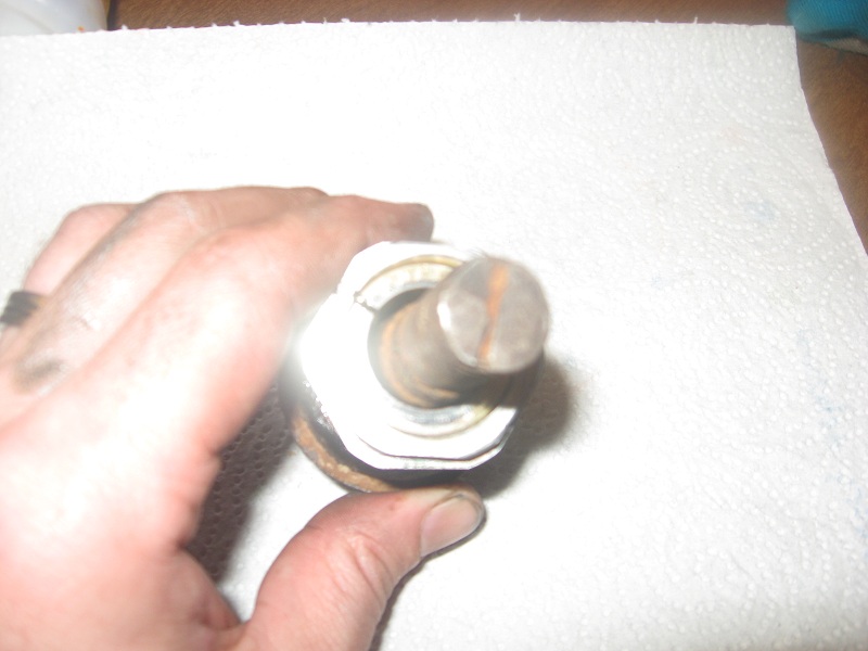

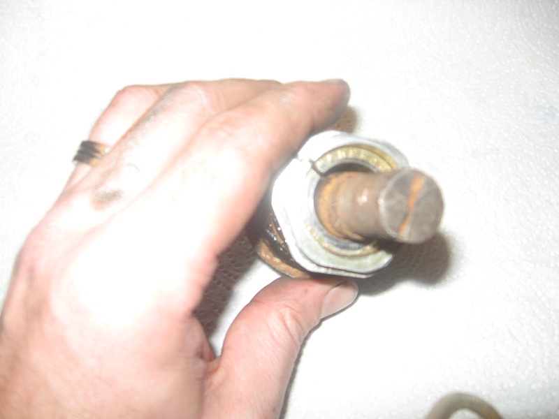

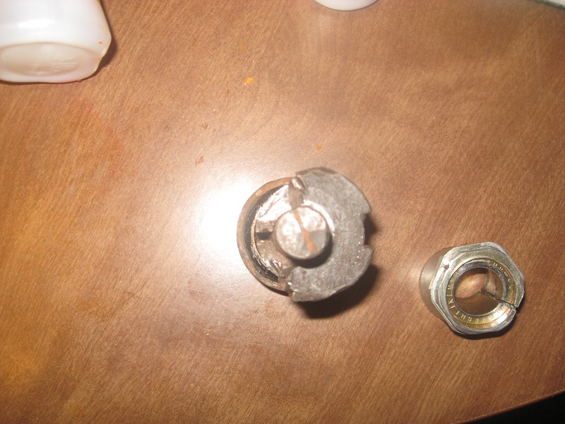

here maybe these pics will show you what im talking about. One of the pics you will see how snug the old bushing fits, the next 2 you will see how sloppy the new one fit. This has been a nightmare.

Yeah that's garbage. Looks like whoever sold you that part didn't get the right one. What the hell happened to the old bushing? Is it possible the parts you're getting are incorrect because maybe the ball joints or steering knuckle are not OE?
the bushing number crossed over to a D28 camber bushing. Good to know though.
I just replaced all the ball joints i figured while I was doing the lift might as well do everything. The bushing looks so bad because it wouldnt come out quietly. Yeah it was rough. The passenger side wont come out either. So will be tearing that apart. I put the bushing in and I was thinking well the catalog couldnt be wrong, so i put the castle nut and then i knew it wasnt right. Good ol Moog.
