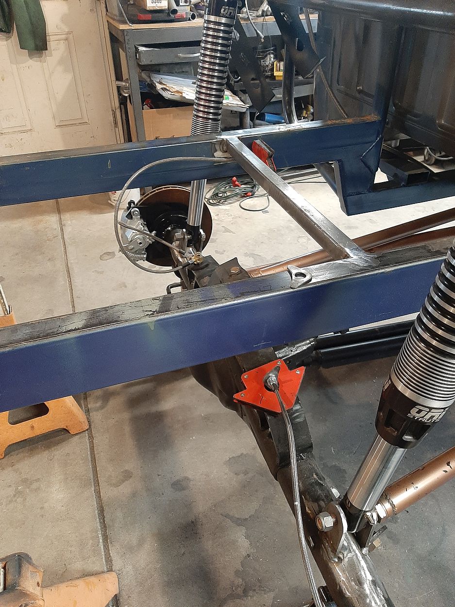

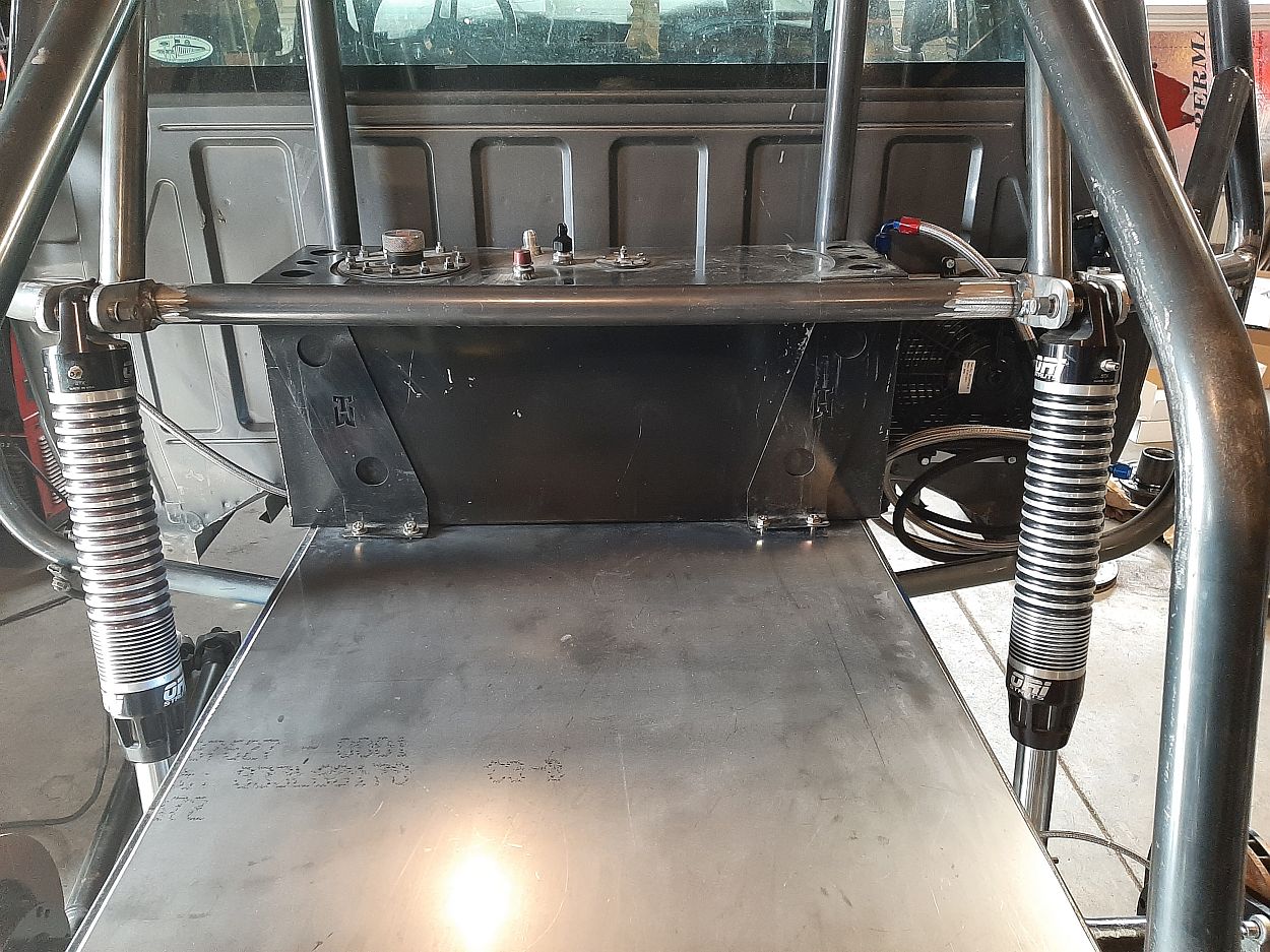

On the back, I wanted to make sure that "if" I had a catastrophic failure that the rear axle/link mount wouldn't come through the bottom of the fuel cell, etc... mounted back there. So a nice welded in cross0bar. 1.25" .25" wall tube. Should keep stuff apart... Also mocking up the brake lines...

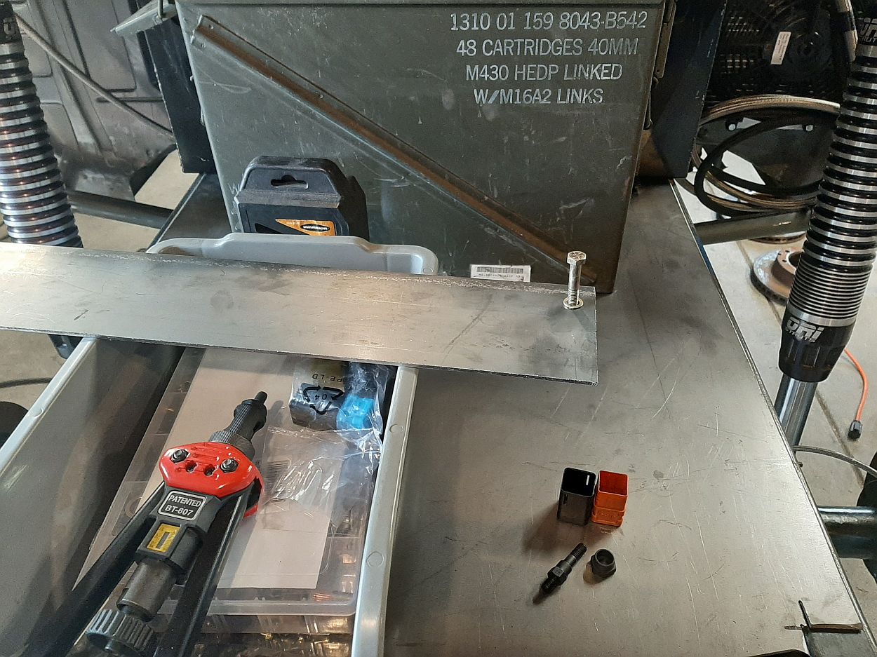

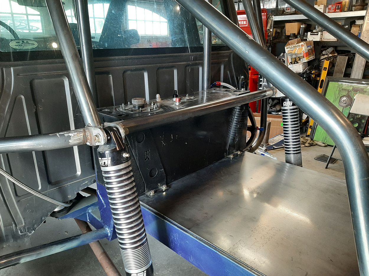

I also dropped the bottom of the fuel cell mount and added an 11 gauge flat panel to mount the fuel cell, as well as boxes, etc... that end up back there.
That's all for tonight, more tomorrow...
