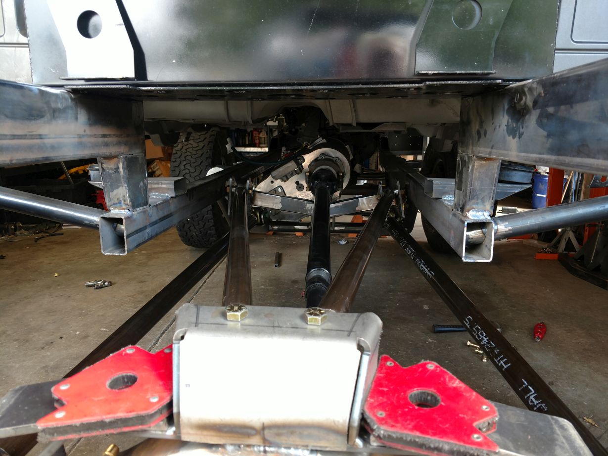

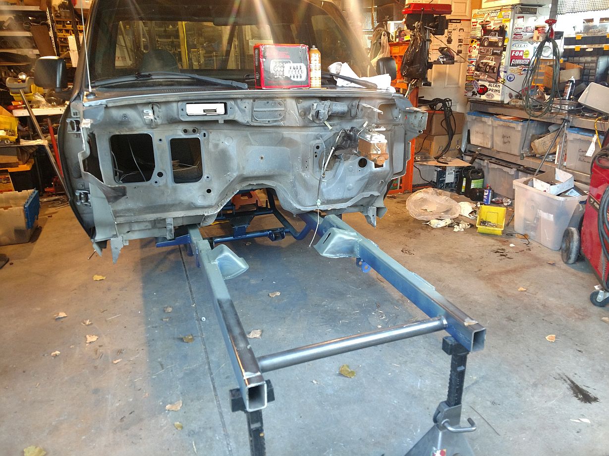

Lower link mounts were easy, getting the upper mounts for the rear meant a nice cross-member. This will serve three purposes:
1. Upper link mounts and they are adjustable for anti-squat.
2. It will tie the left and right frame rails together.
3. It will keep the rear driveshaft from hitting the ground and "pogoing" the back end at speed.
All the links in and adjusted:
Uppers are 1.5", .25" wall DOM, 3/4" heims at each end. Lowers are 2", .25 wall DOM, with 1.25" Johnny Joints at the front end, 1.25" heims at the back. All links are built with left and right threads on each, installed opposing directions (meaning the front lowers are left on one side and right the other).
It's hard to see in there, but the rear of the Atlas also has a brace to keep it mounted to the tubing.

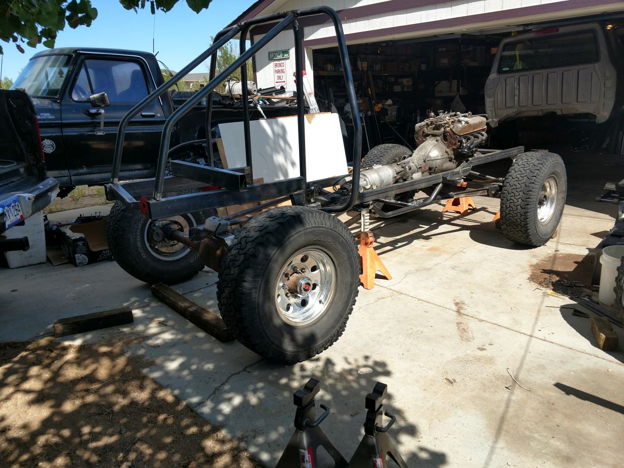

Thursday got the rear hoop parts built/on. Still not 100% where the spare tire will end up, either on the outside just above the bend, or inside angled forward.
Then I pushed the body out of the shop and cleaned up some of the mess...
You can see the frame/chassis is sitting directly on the axles/links. No bending, no muss. Everything clears at (well beyond) full bump:
And today I took it all apart so I can finish welding up the chassis, put some more bracing on, get the trans rebuilt, etc... Finished up just in time to avoid the thunder storms...

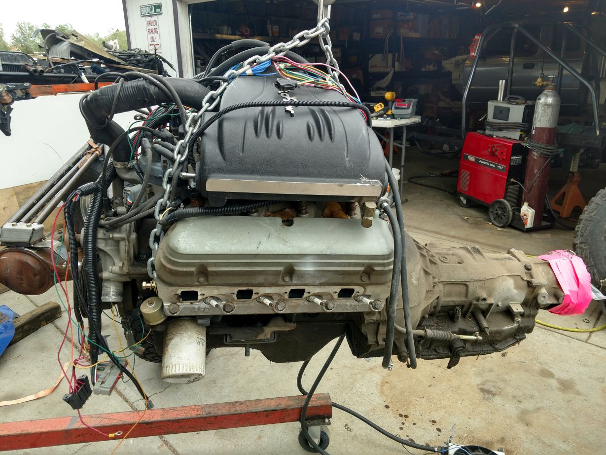

Change of plans (# *whatever..). Decided to pull the 408 stroker out of the Bronco and use it to power this rig.

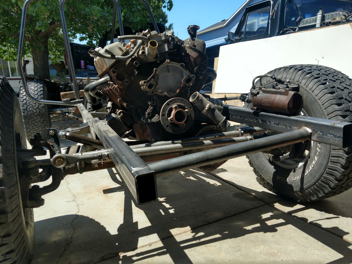

Part of this is to also add the Explorer serpentine/shorter accessories to the front. Here, pulling the water-pump and timing chain off.
Test fitting the Explorer assy on:

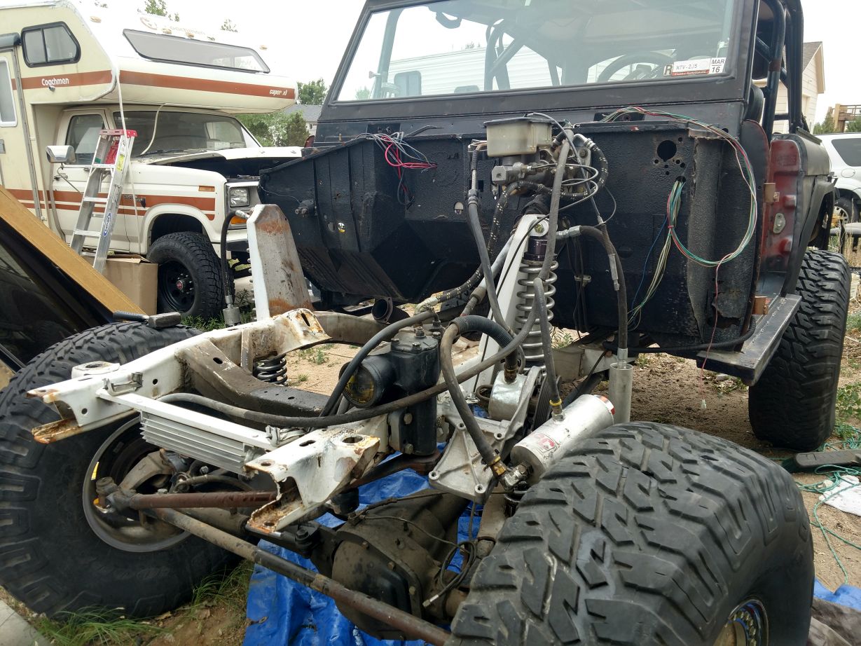

One thing I was not happy about, was the L/R angle of the front radius arms. So... I decided to cut off part of the drivers side leaf spring perch so I can move the mount in a little.

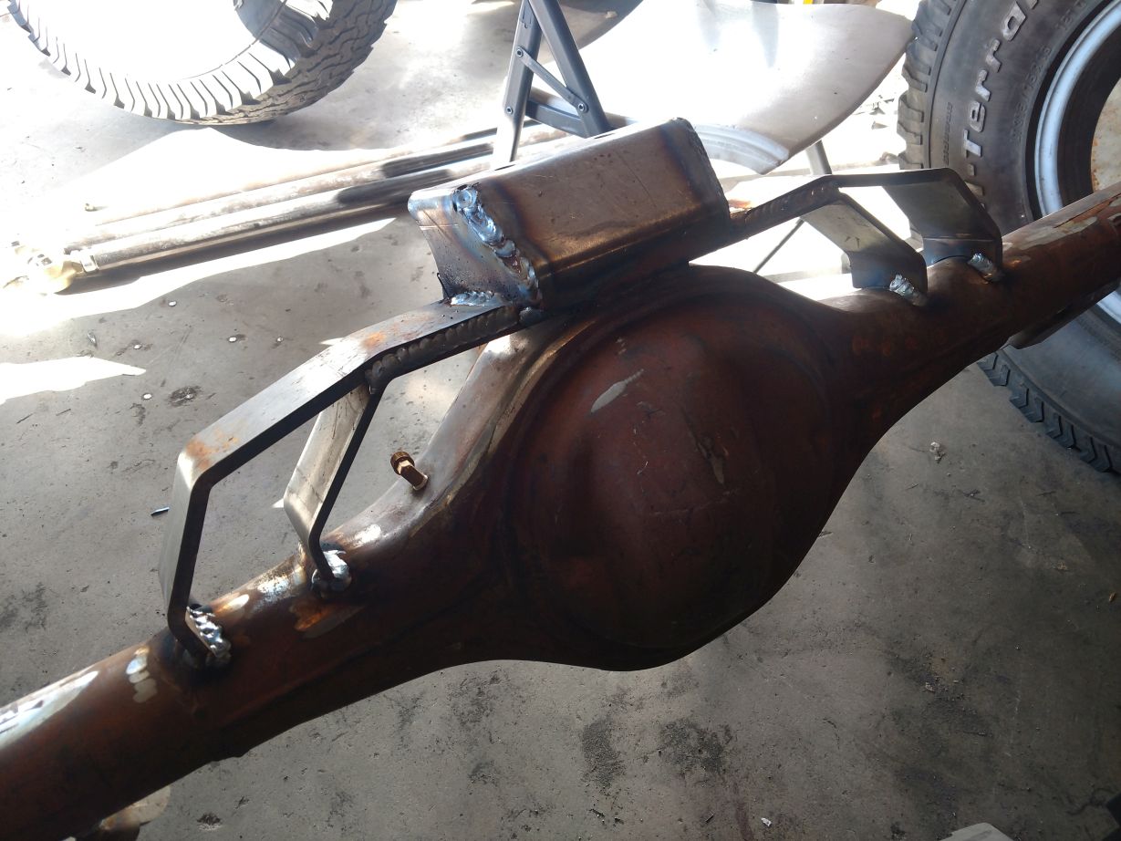

Working on getting the rear axle all welded up with brackets, etc...
And done, everything all welded up and painted a boring black.....

Some pics of the engine with the Explorer Accy on the front. And yes, you can put Explorer Accy on a 351W block, as long as it's the newer blocks. All the Accy bolt onto the head, just needs to have the right heads. E7TE or equivalent... In this case, Aluminum AFR 185s...

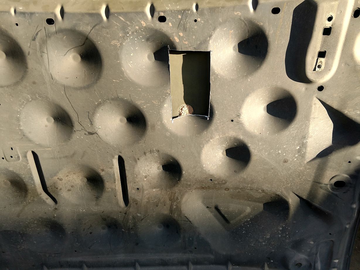

A little interference between the bottom of the hood and the top of the intake:
Nothing a little cut-off wheel can't fix:
And so much better....
