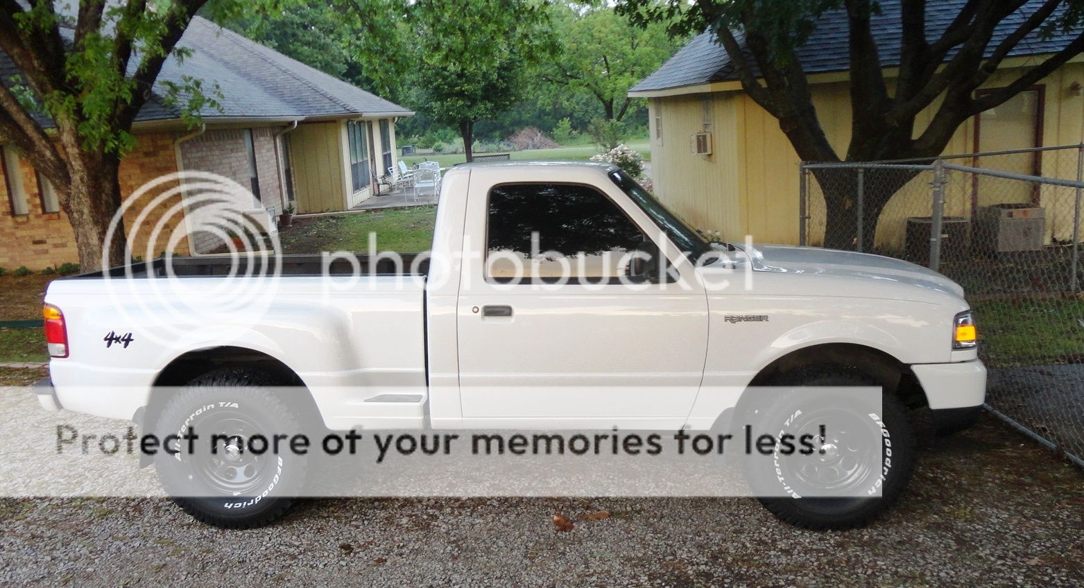

OMG you truck is identical to my 99 (Before you did conversion) I used to have down to the rims LMAO. I will be watching this build. I'll have to show you a couple pics, unreal.
well heres one. Its amazing how few I still have :(. i loved that truck

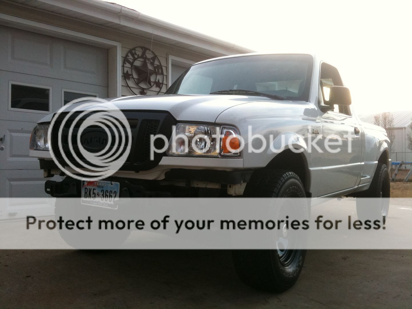

Well I've put about 500 miles on it now with zero major issues. I still have the idle issue after a blip in park, it's like it's trying to find the right rpm and it rolls up and down, not sure why.
Everything works. Tach, speedo, cruise, and I love my Cougar dual electric fans. My only upgrade besides the air filter. Mpg is about 15 and should get a little better with more break in time, some tm headers and bigger tires. Amazing how plug and play this swap was, and now this thing is a beast! I can't wait to do another one or lend a hand to anyone attempting this swap, it was a blast. I still have a short list of upgrades, but for the most part it is done.

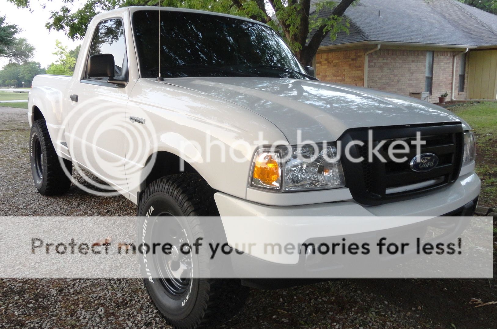

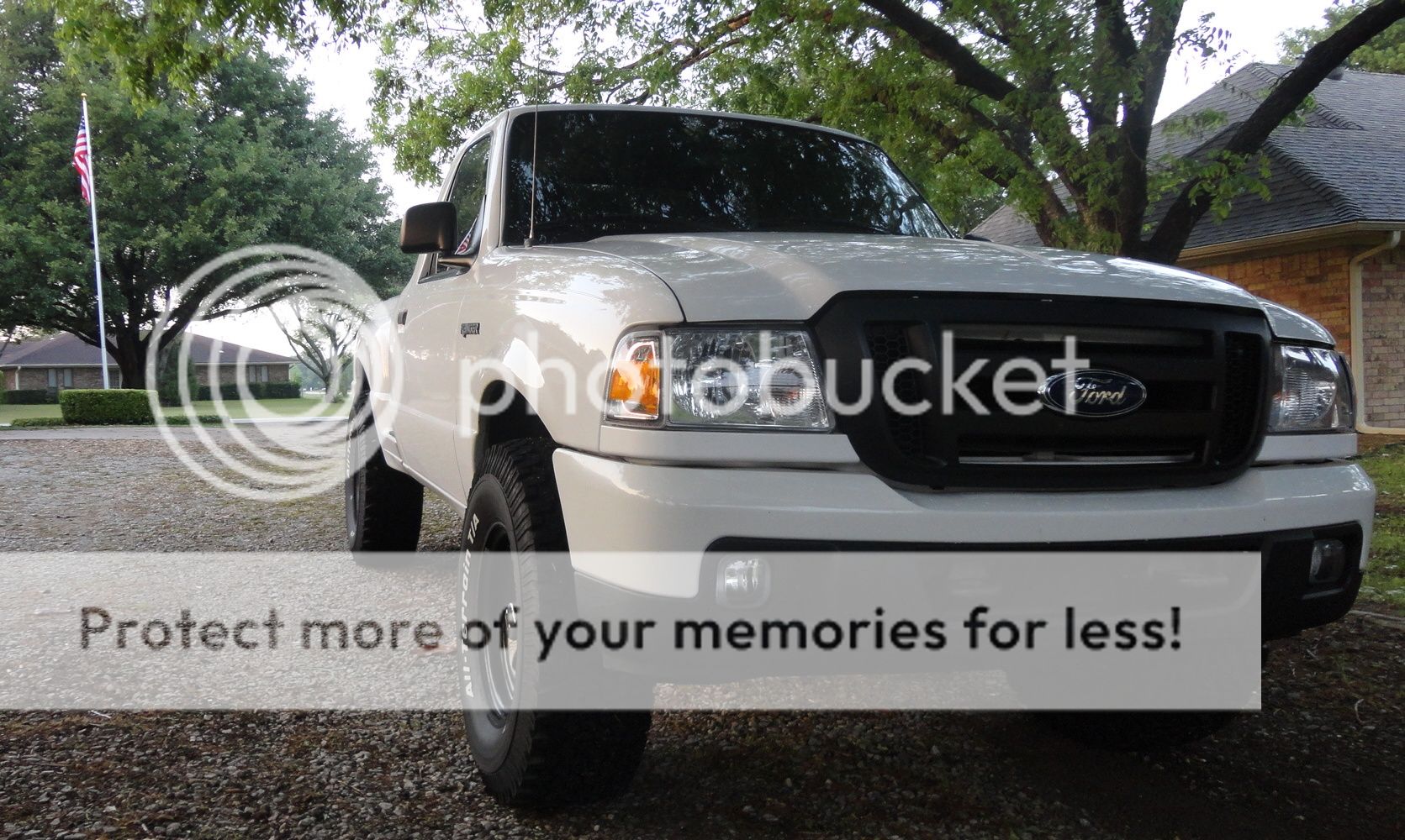

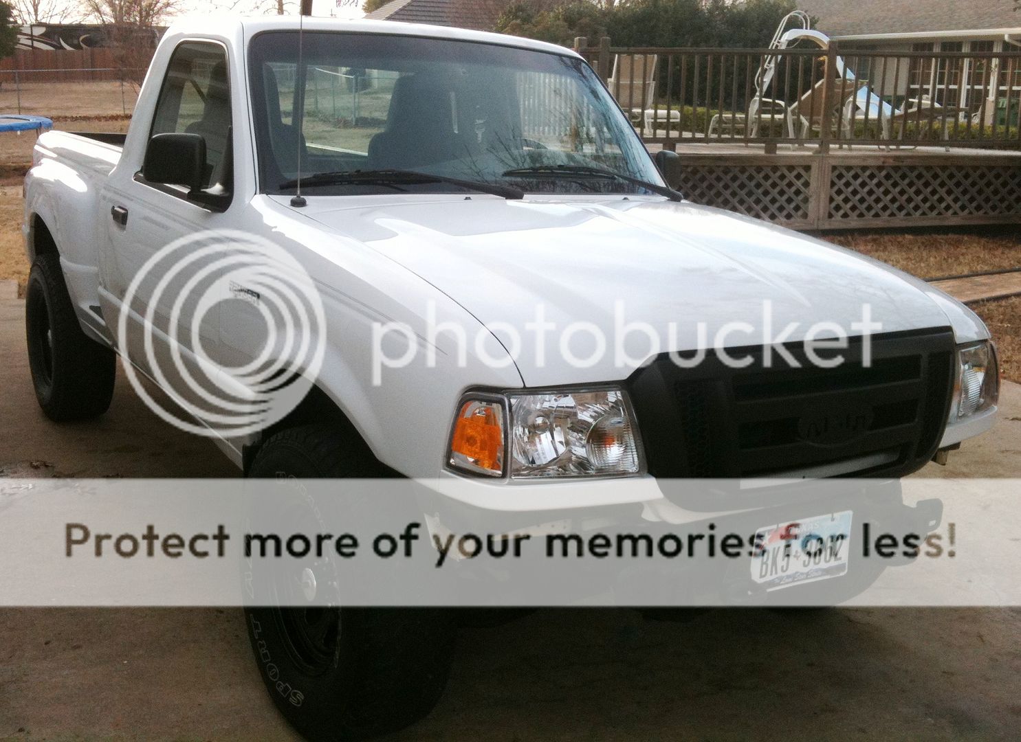

Some pics of the completed front end swap. Let me know what you think!
Lookin good man, talk about brreathing new life into something ya love. That's a whole new truck.. and a whole lot of motor. I figured the gas mileage would be better though, I've been hearing that people get around 25mpg's being that it doesn't require as much power to move such a light vehicle. I have also read other threads where they talk about hte idling issue. I am curious how to remedy this.
Nicely done sir!
The low mpg is due to the gear ratio, 410 is way too steep. I'm running 410s in my Trac with 32" tires (275/55/20) and I get 17-18 mpg, but mine needs a tuneup. Get a tuner with a custom tune and you will get another mpg or two along with a little more power. Double check timing, as well as the cps location. A tune can also help pinpoint the idle issues...
SVT
Driving it daily right now so I installed some Bilsteins on the front and some new BFG's.
