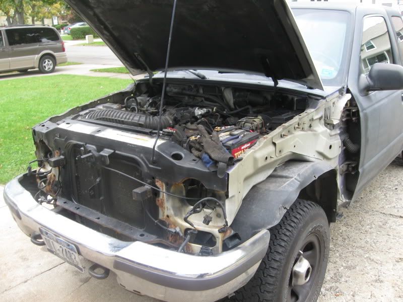

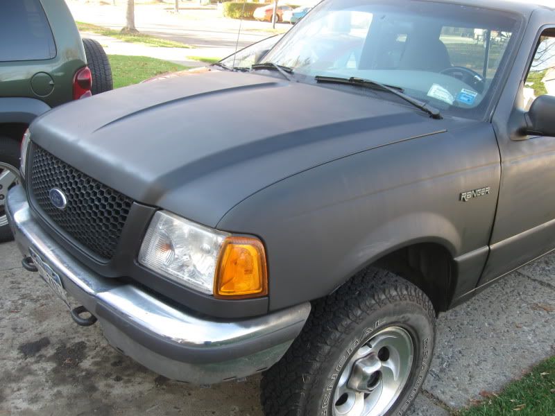

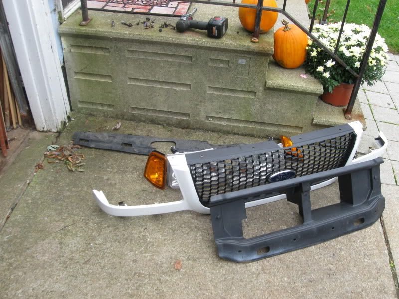

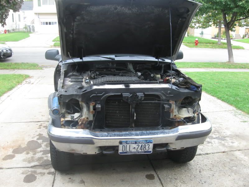

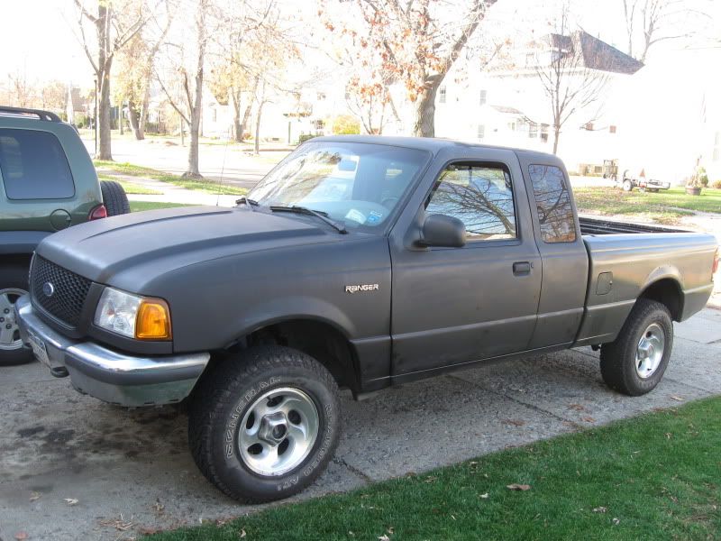

I've done a little more work on the truck, but it looks like it's going to be two colors until at least spring

Also, I stole some tires off of my friends jeep and put them on my aluminum rims
and I decided that I really want to do a v8 swap next summer

Nice update. And I noticed the wheel change right away, those look good.

cool to see that you kept it, really like your truck actually looks pretty good in flat black, like your setup for the sub too very cool
nice work man!!! that front end looks really nice, and the sub setup looks great too!!
when it's dirty, it almost looks like 1 color, and it's really weird, haha

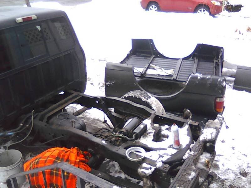

In the past week, I've sorted out all of my fuel pump problems, replaced my rear leaf spring hangers, and added air-assist shocks. However, somehow in the whole process, I only got one picture. Next time I pull my bed off (seems to happen about every other day) I'll make sure to get some pictures.
