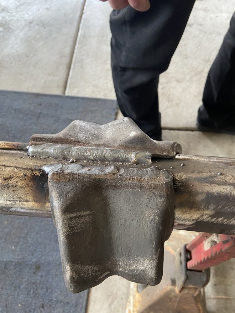

Burned some metal today. Not pretty but being my first time I think they will do. The nice part is these welds are gonna be hidden 😂

Welds look good champ. Whoever your teacher is did a good job 👍

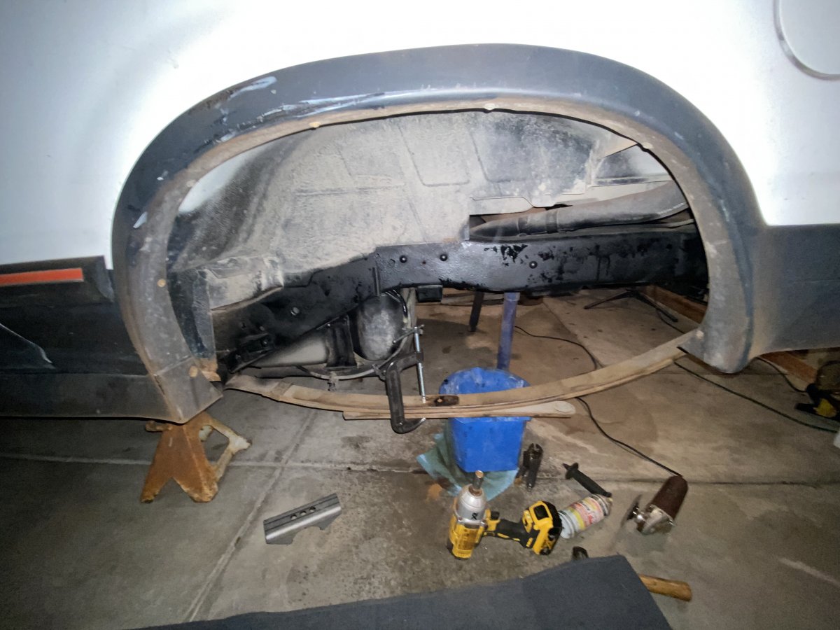

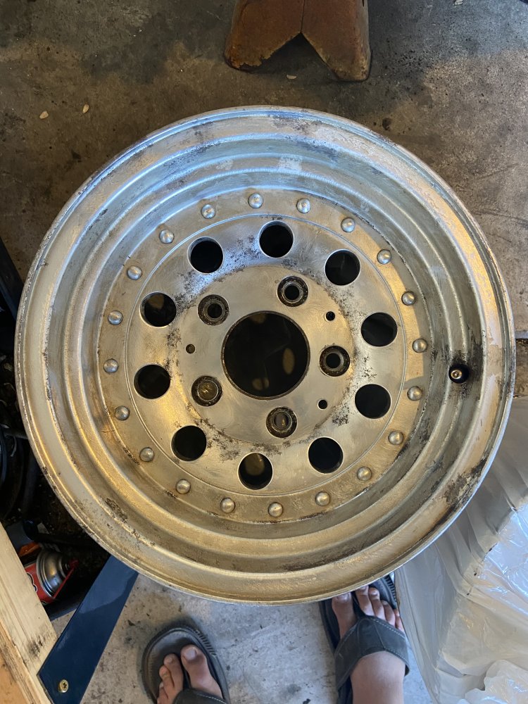

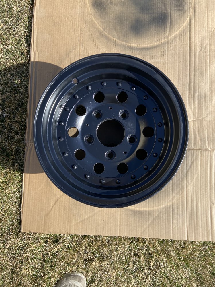

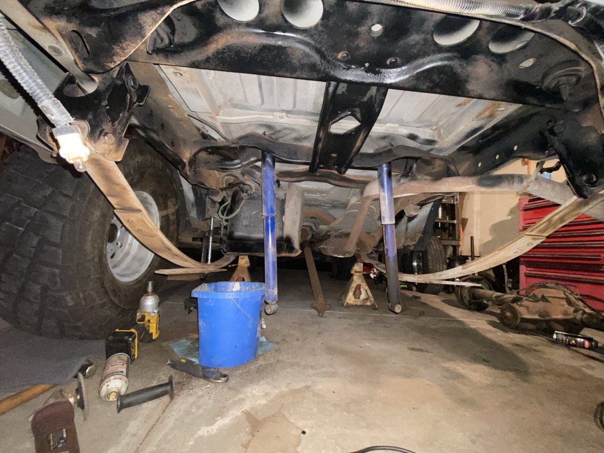

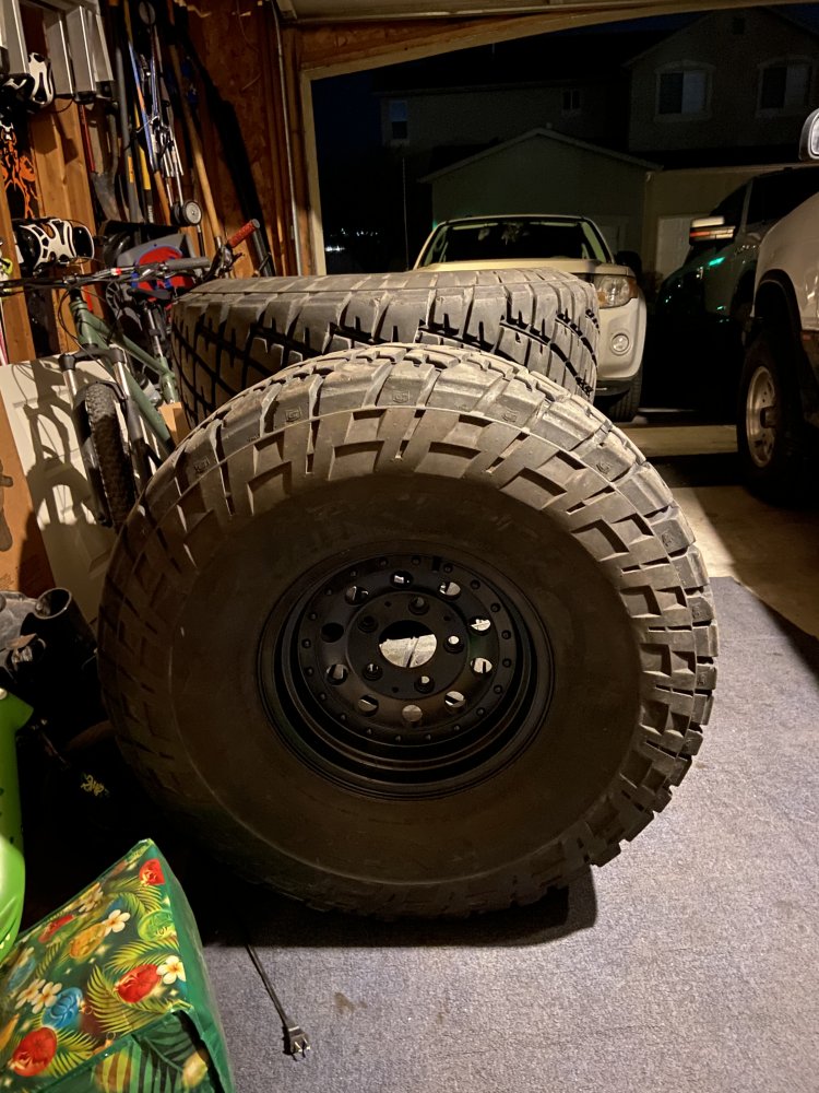

Made some real progress on the Explorer. So I picked up some wheels $50. He called them centerlines but after looking and some hunches from @BlackBII i found a Ford symbol on the inside of one of the wheels. They were in rough shape so I sand blasted them and decided to paint them. I wanted to paint them gold but my wife wanted black so we compromised and painted them black. Going to get the tires mounted tomorrow.

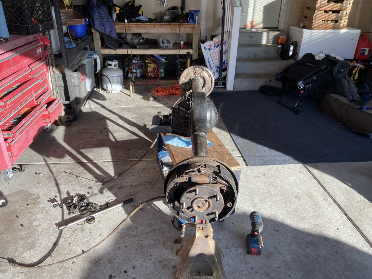

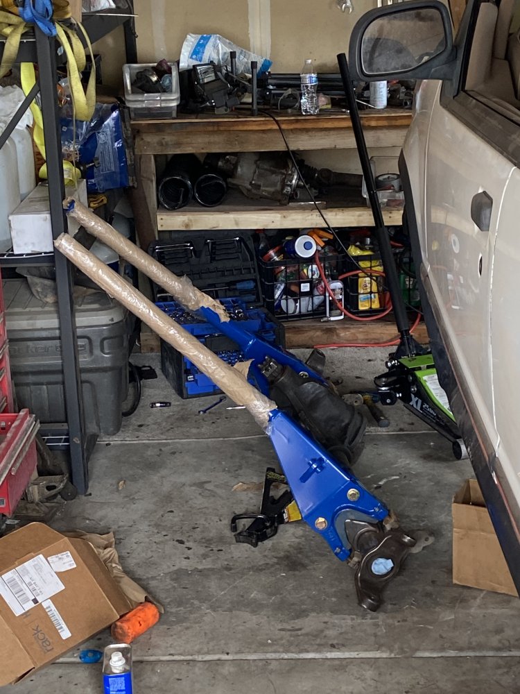

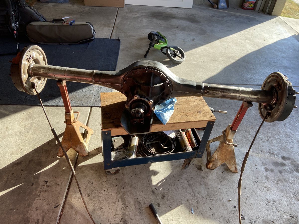

I also pressed on the new timken unit bearings and got the 9” put back together. So I decided to pull the trigger and started tearing the rear out. I got the 8.8 all the way out and hoping to get things cleaned up and mocked up tomorrow and Sunday. Goal is to get back rolling by Wednesday because I have some family coming into town.
I still need to figure out brakes for the rear. If anyone can share some pics how they extended their lines and hooked up their parking brakes that would be very helpful.

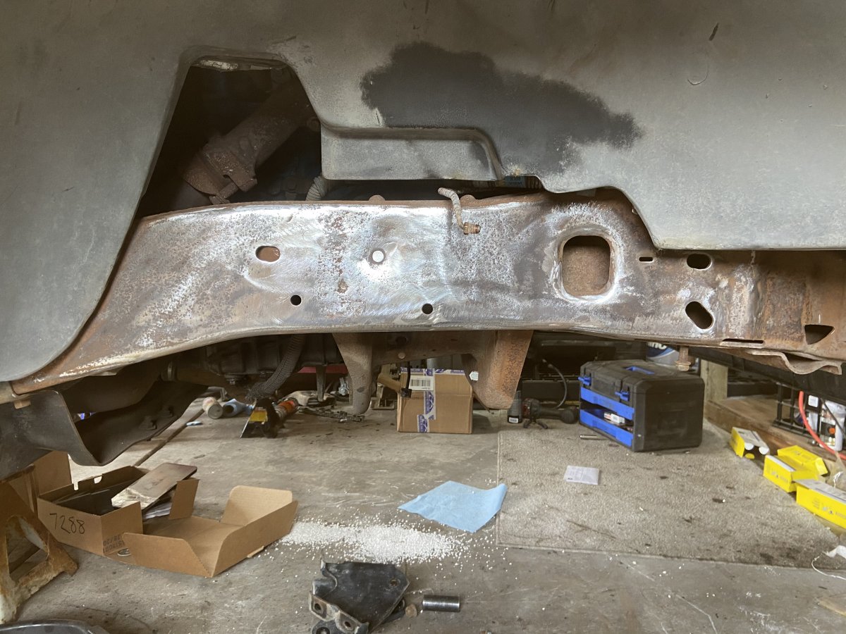

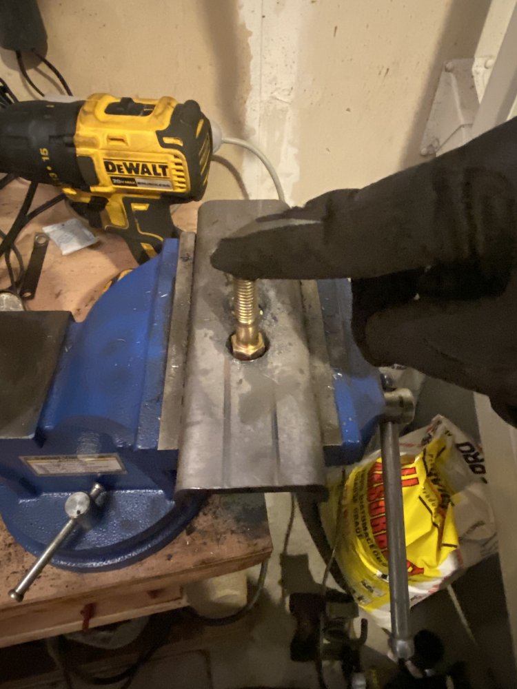

More rust than I wanted to see so I spent some time getting a wire wheel on everything I could then hit it with a rattle can, need to go over it once more. These leaf spring centering bolts are toast so I grabbed some 7/16 x 2” ones. The junk part is I got to open up the holes on the new perches and pads to accept the wider bolt heads now. ordered a reamer to help me with that, should be here Monday. Best part of yesterday was I finally invested into a shop vac, no more random dust getting tracked everywhere!!!!

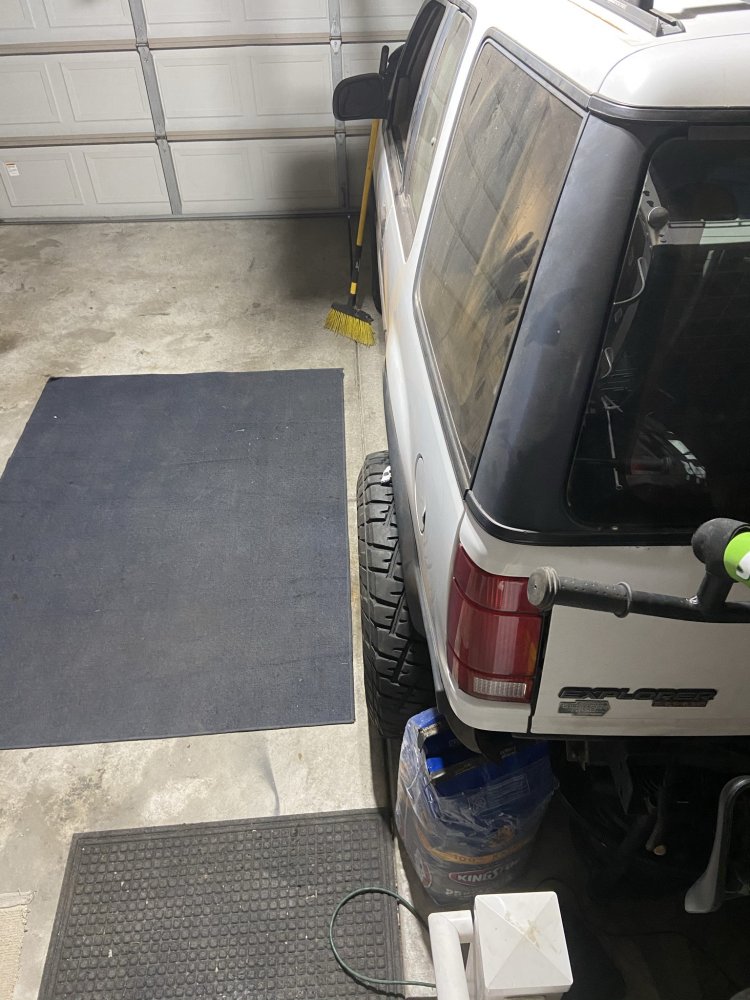

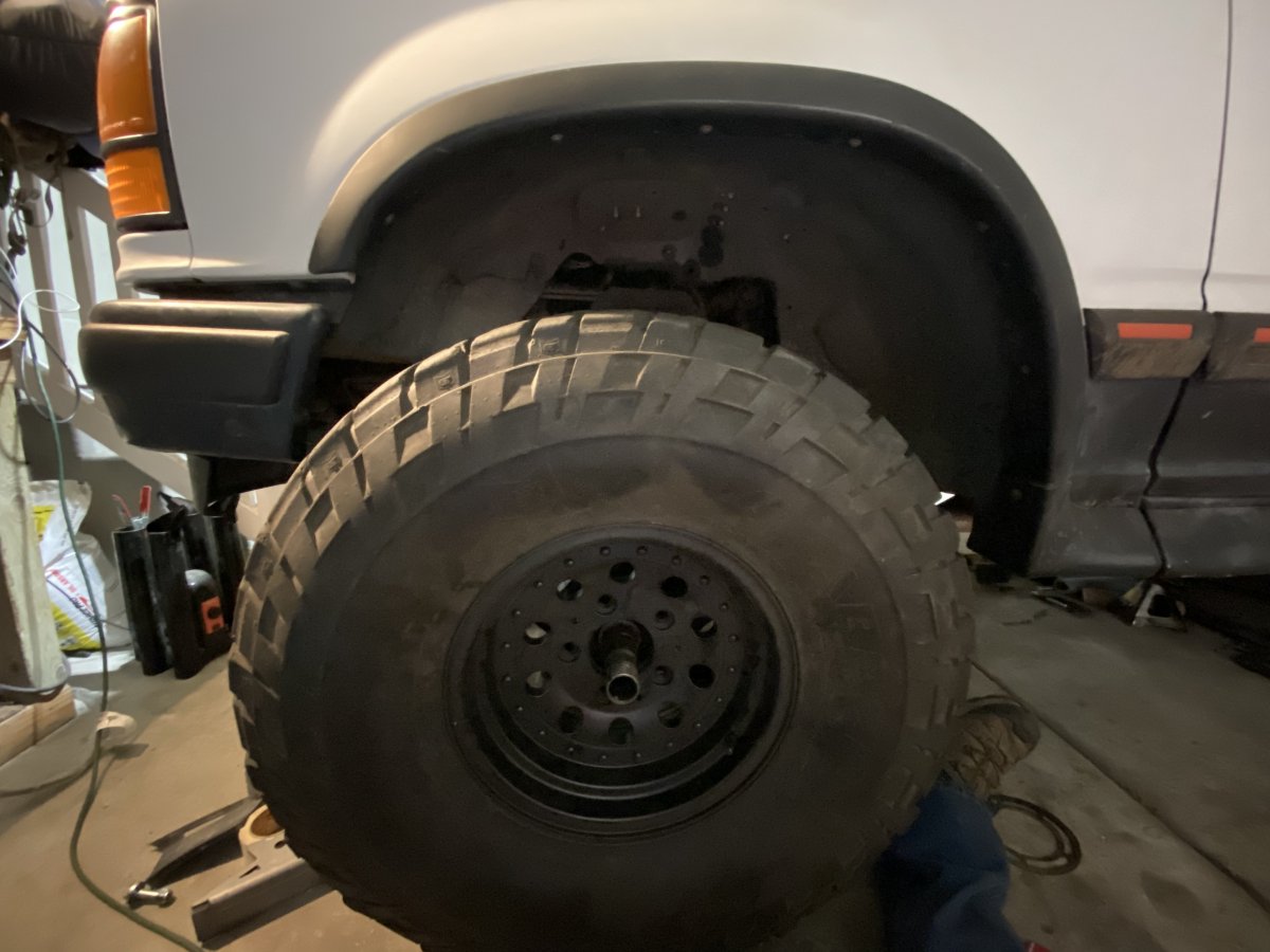

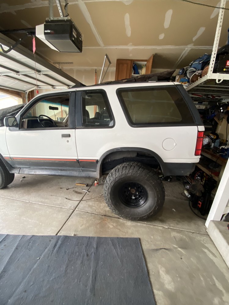

Got the wheels and tires mounted. I think they turned out great for $300. $150 tires+$50 wheels+$20 paint+$20 blasting media+$60 mounting and balancing 👍🏽

Looking good champ! That's some good progress. You can buy lengths of brake line with the fittings already on them, autozone has them and they're cheap and easily bent to work with your axle. For the leaf spring bolts, you could just grind the hex head down to fit in the hole, that's what I did on mine
Rims did come out really nice.
I never thought about grinding them down. I might do that tomorrow. But I also bit the bullet and bought a 3/4” reamer which is on its way.
I know I can do that with the hard lines but do they do that as well for the rubber line?

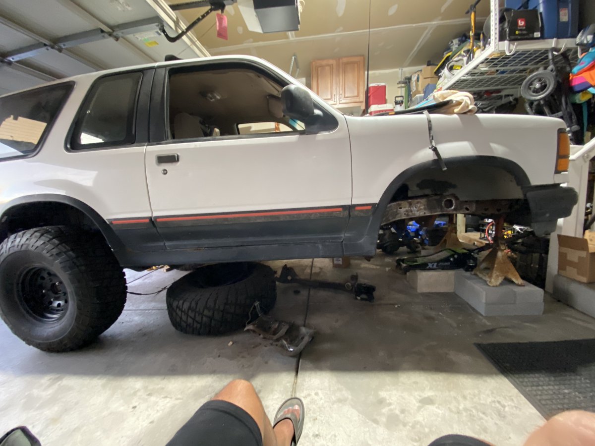

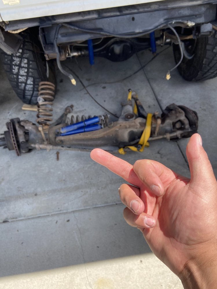

So it’s been a minute since I have posted things family wise have been busy busy but finally jumping back to working on the explorer. Since April got the rear in place just need to run a brake hardline and figure the drive shaft and I will be good to go.
I got the front d35 out, 44 mocked up and coil buckets where I thing they are going to live. Just need to pick up some hardware for the trac bar and steering to check for clearances.

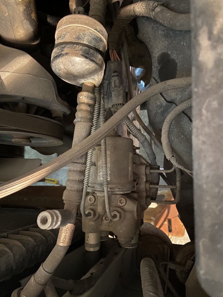

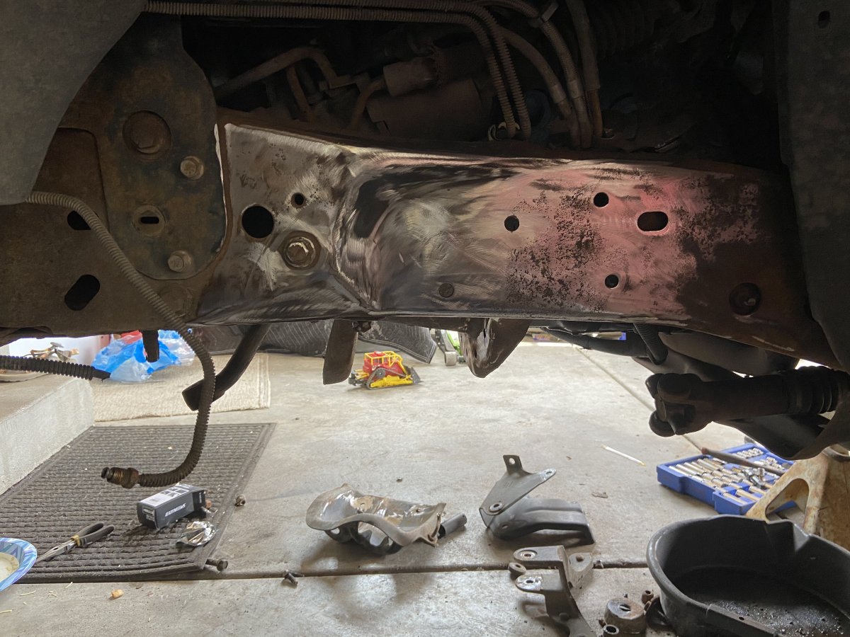

One question I do have for those who have done a swap is what do y’all do with the brake abs system? Do I need to remove the system in the pic and bypass it? Or leave it and run it like normal?

I will be removing the ABS on mine. I guess you could leave it in place but there isn't really an easy way to add ABS sensors to your front axle and the rear doesn't have a tone ring... so it won't be functional anyway. I would just remove all that junk and run new brake lines.

I will plan on ripping it out then. I just didn't know if it would screw things up where I couldn't easily fix.
