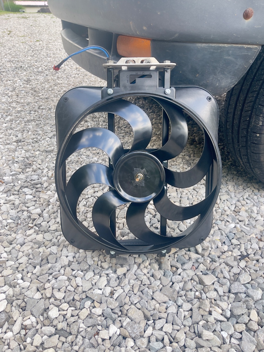

Had to replace my flex light fan, which they’re pretty easy to put on. This is a flex light 160 3,000 CFM. I think the original one died because for some reason I used a smaller wire for the ground and I think I burnt the motor up but it worked for five years. You can get the same fan, which is a model 168 and it has the relay and fuses integrated at the top of it. You could see on the top. There is this little space that’s where the relays will be in fuse
