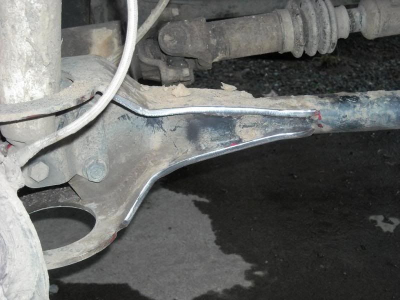

Got around to grinding off those radius arms.
Where the tires were rubbing
The tires are a little torn
Ground off
Tires rub a little bit still, but I'll try to get some 1/4" spacers since they just rub at full lock.

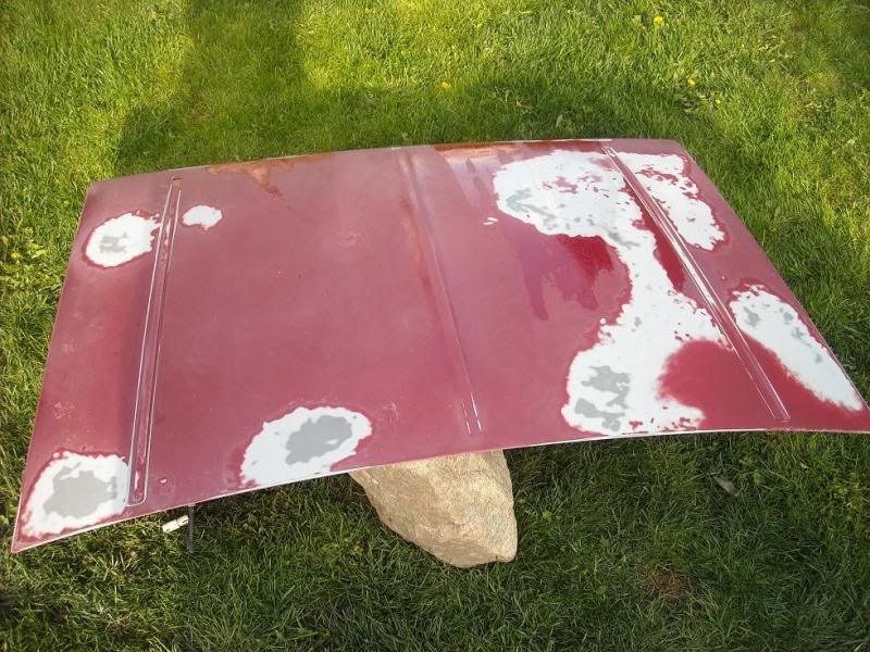

No more peeling clear coat
Took care of that too
Didn't quite get the hood taken care of yet
2+ hours of sanding was enough for me today, it still needs a couple spots to be blended a bit better. I figure I'm gonna see the hood while I'm driving so I should take my time. I had it all the way down to 100 grit taking off the peeling clear coat, then stepped it back up to 400. I'll take care of it the rest of the way tomorrow.

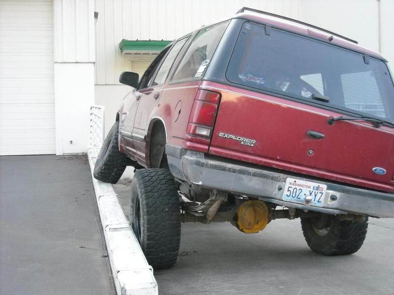

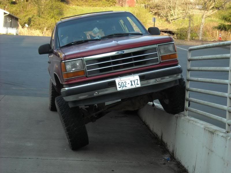

Found a flex ramp too, that's with the sway bar in.
Just barely touching
Pulled the sway bar
Still well on the ground, but in the pic above you can see my tire was against the rail, so I need a better ramp. Or something.

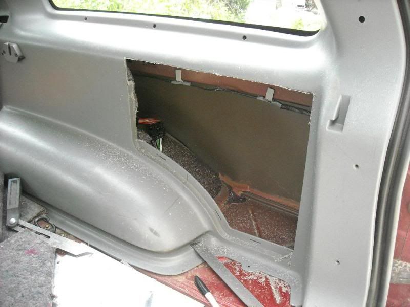

Built a new sub box, but it's not in yet... The back half of the truck is torn apart, and I'm done for the night. Pics tomorrow.
Took longer than I thought, I've been dealing with other stuff the past few days. Now it's finally done... for now.
This pocket can be conveniently removed
And there is a lot of space back there.
I'll figure out some way to wrap the box that is better, but that will do for now. The box itself is came out to 1.01 cf interior volume without the sub. I did a little searching online and found that these sound best at right around a cube, and after figuring out what I had to work with for space, I'm pretty happy how close I got to that. It sounds much better and hits much harder than it did in the old box I had it in, which was about 1.35 cf. Plus I have a lot of my cargo space back, and it's actually secured to something instead of bungee-corded in place.
