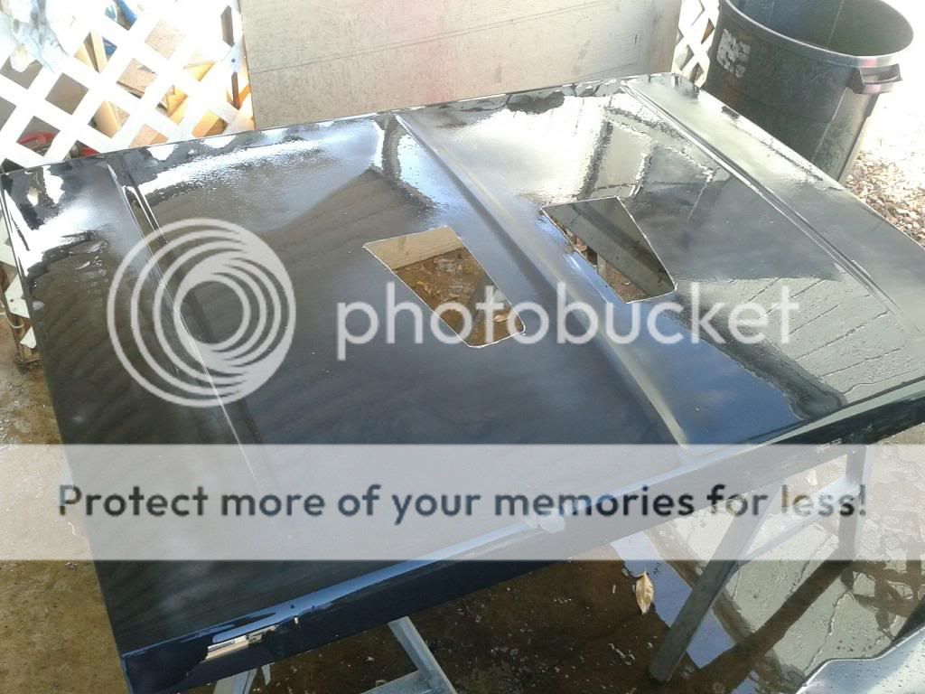

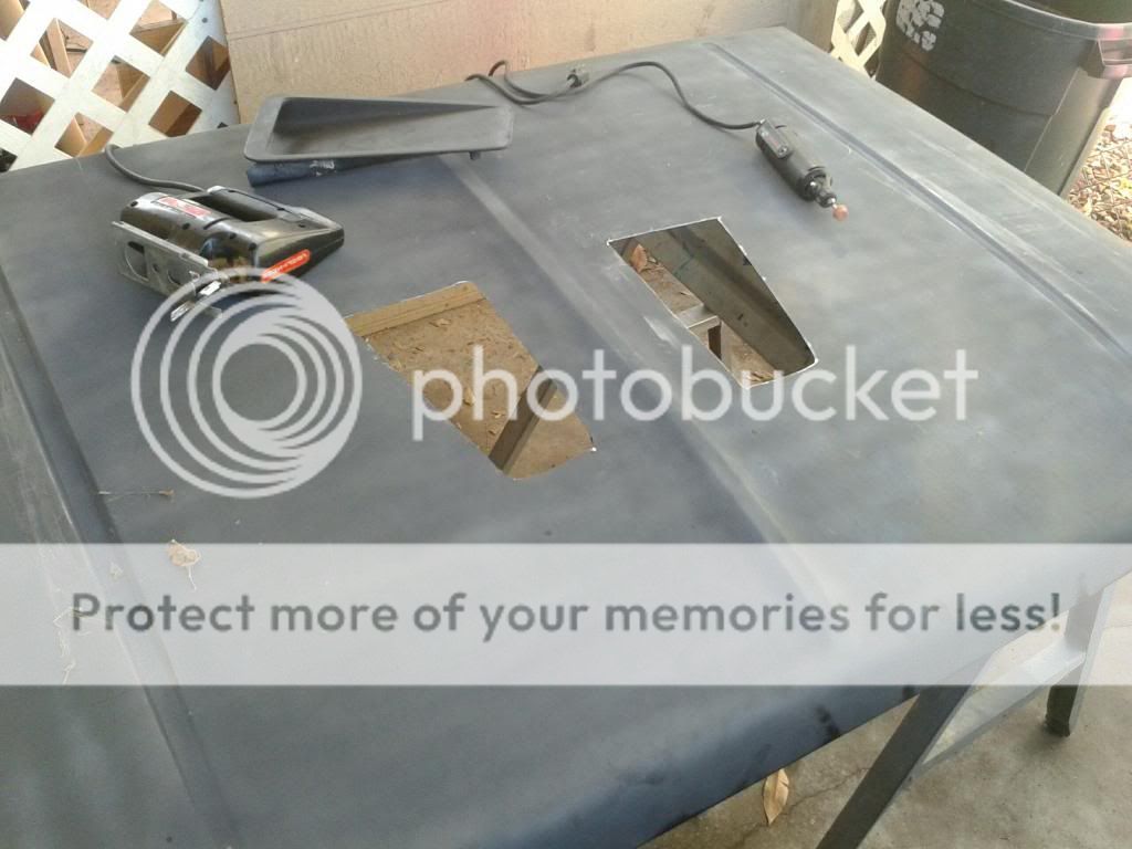

i have had 2 tbird turbo coupe scoops for about 2 years with the intention to put them in the hood. well i finally grew some stones and started it up.
first shot is very rough cuts for the scoops to fit, second pic is basically the final cut and the hood cleaned for the carbon fiber vinyl to lay down before the scoops are bonded into place. let me know what ya guys think.

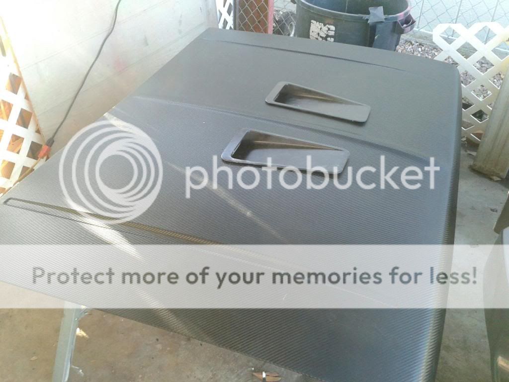

another quick addition...
the carbon fiber wrap completed and the scoops sitting in, will finish installing the scoops and get a final pic tomorrow.

I really like the carbon fiber wrap on the hood. I'd like to see more of a write up on doing that.
theres not much to write up on the wrap. you clean the hell out of th surface. and apply like a sticker but use a heat gun to smooth out bubbles and i used a plastic bondo spreading board to press into the lines. took about 2 hours or so to get it good
