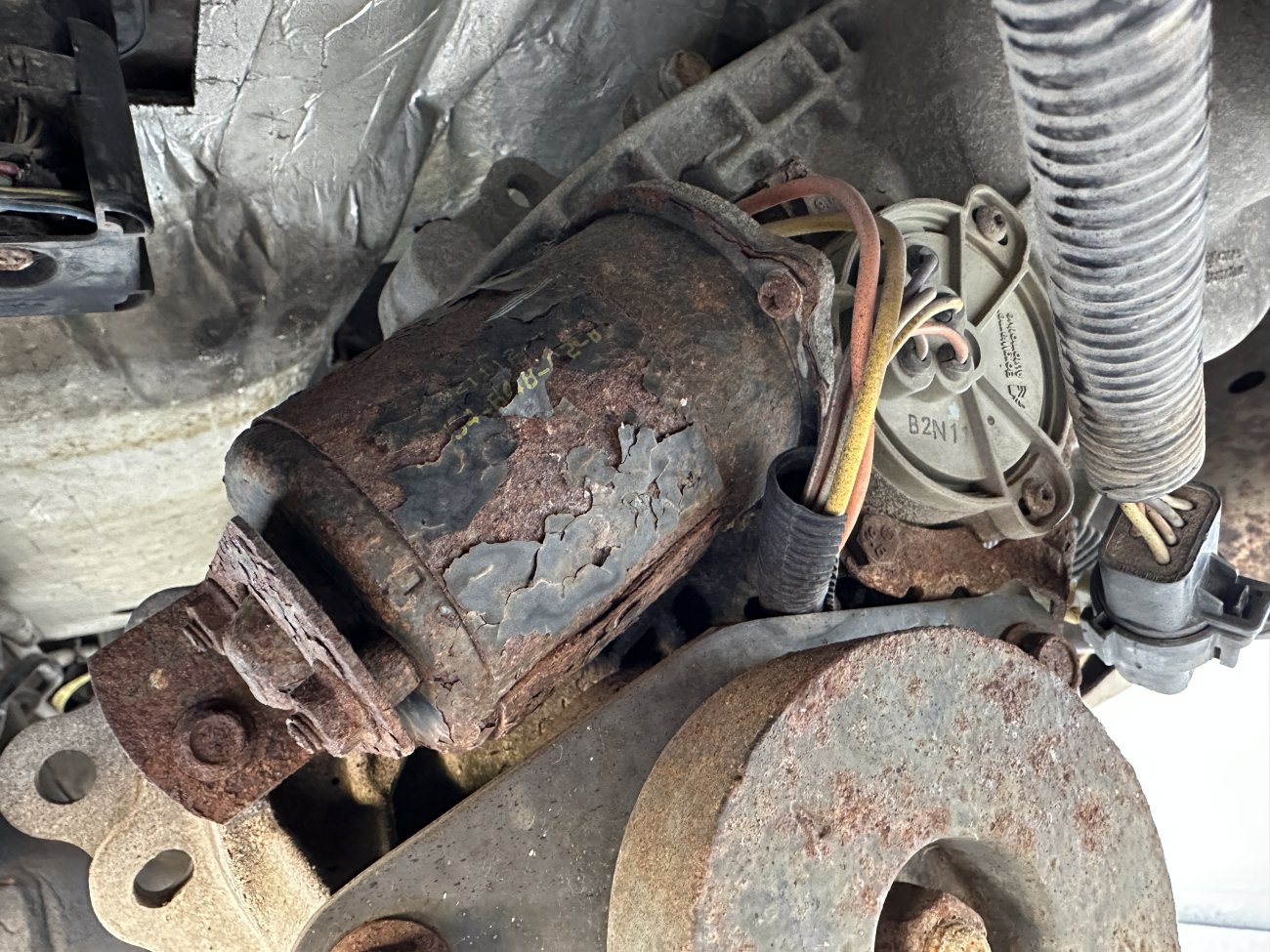

Perhaps I should replace this motor, just because...

My first inclination is that it's the motor. Looking at the picture, it is a reasonable assumption but don't be surprised if it ends up not being the problem. I do have the luxury of owning a service manual and wiring manual. So I have something to reference during troubleshooting before I start replacing parts.
Unfortunately, I'm not home to provide scans of the relevant pages for you. Good luck.
For the record, that ugly motor I posted above, works fine. I replaced it anyway...
